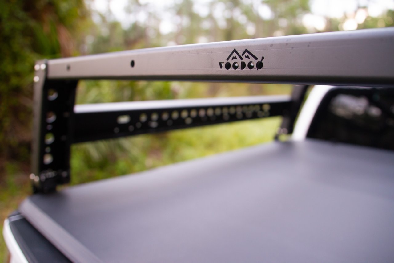

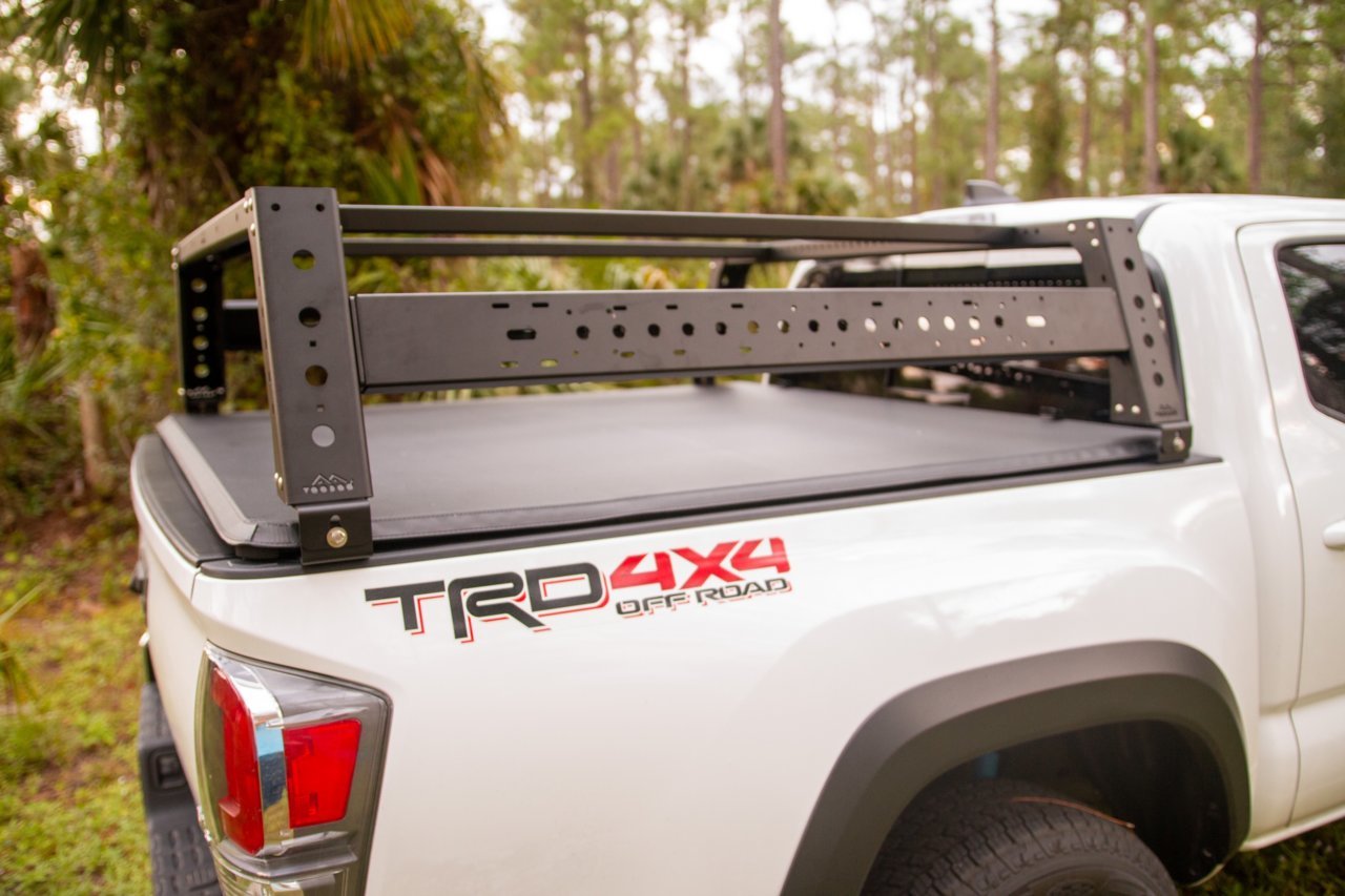

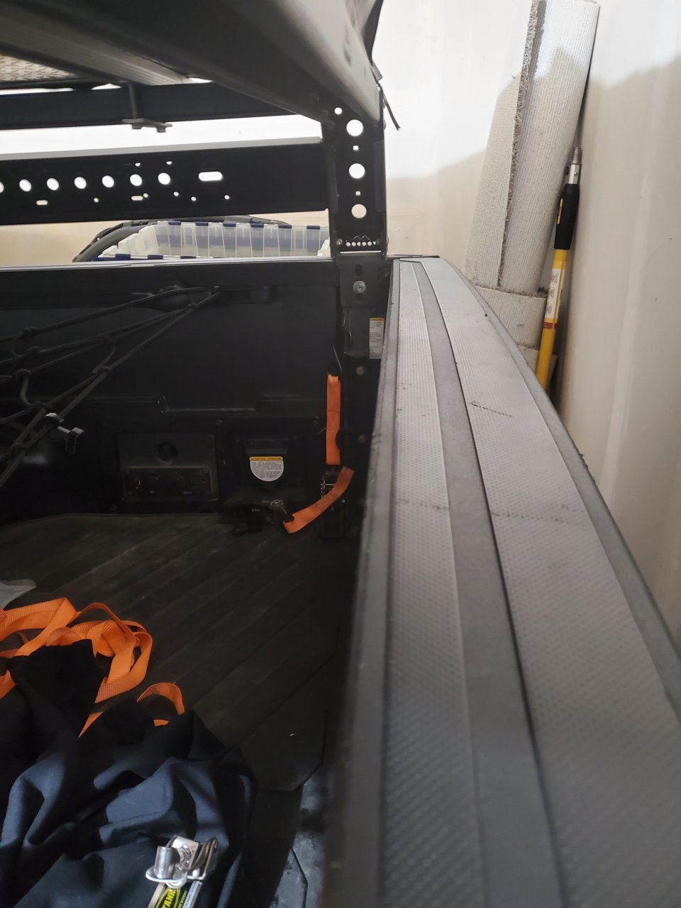

    Order the 58inch long bed rack 14inch with tonneau cover bracket. Follow the Florida_Adventure_fam on instagram for install. I'll be installing it this weekend. Thanks KB voodoo! shipping was fast!

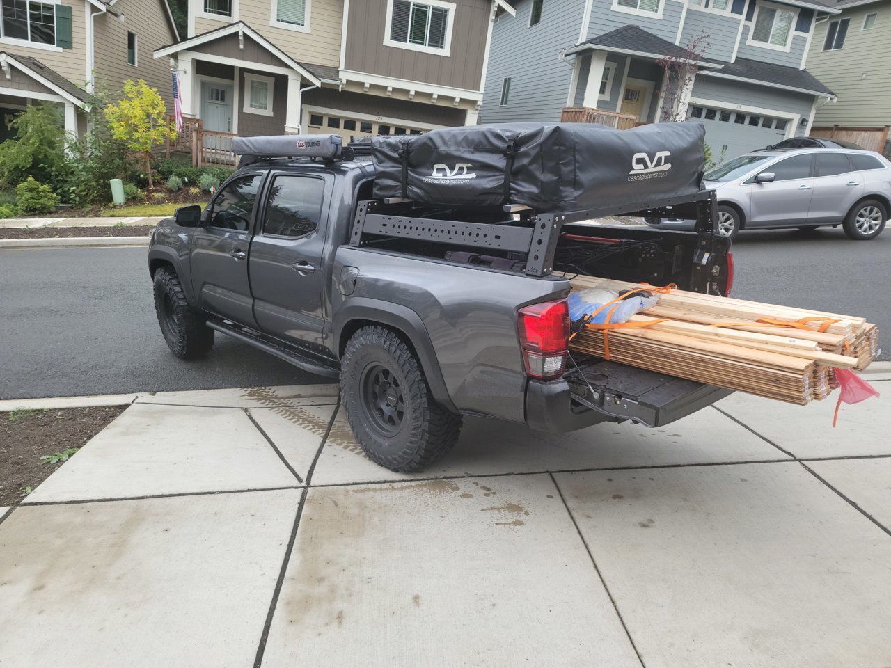

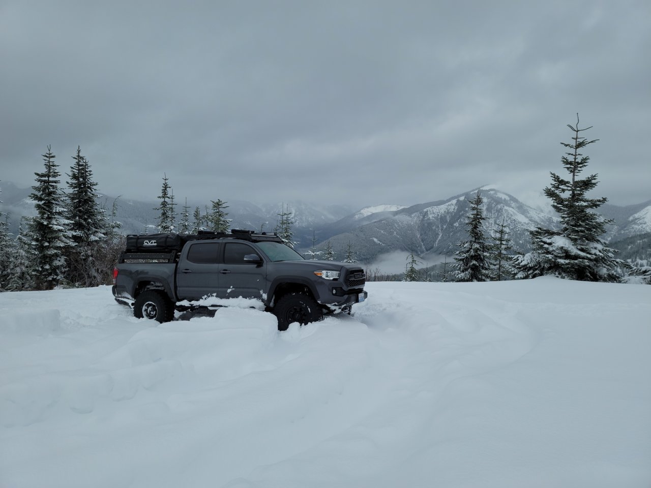

    here's my long bed rack on my short bed.

    Well that is EXCELLENT!! Got a pic of the front mounting spot??? Looks good proportionally.....My home made one one my long bed looks like it should go on a short bed BECAUSE I used the rails!! Didn't know about just using other mounting bolts. Oh, well.

    It goes into the normal rail with the supplied hardware.

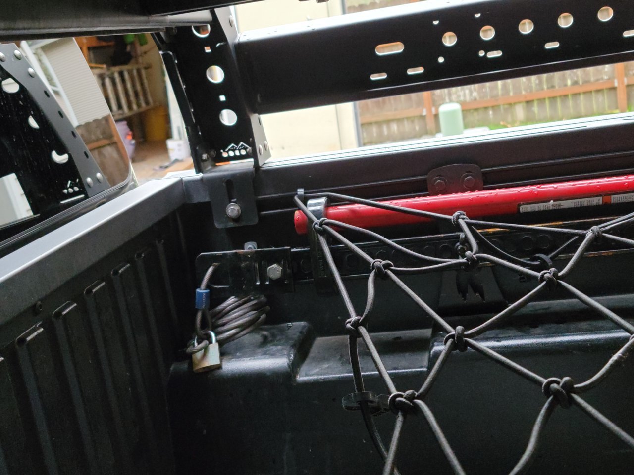

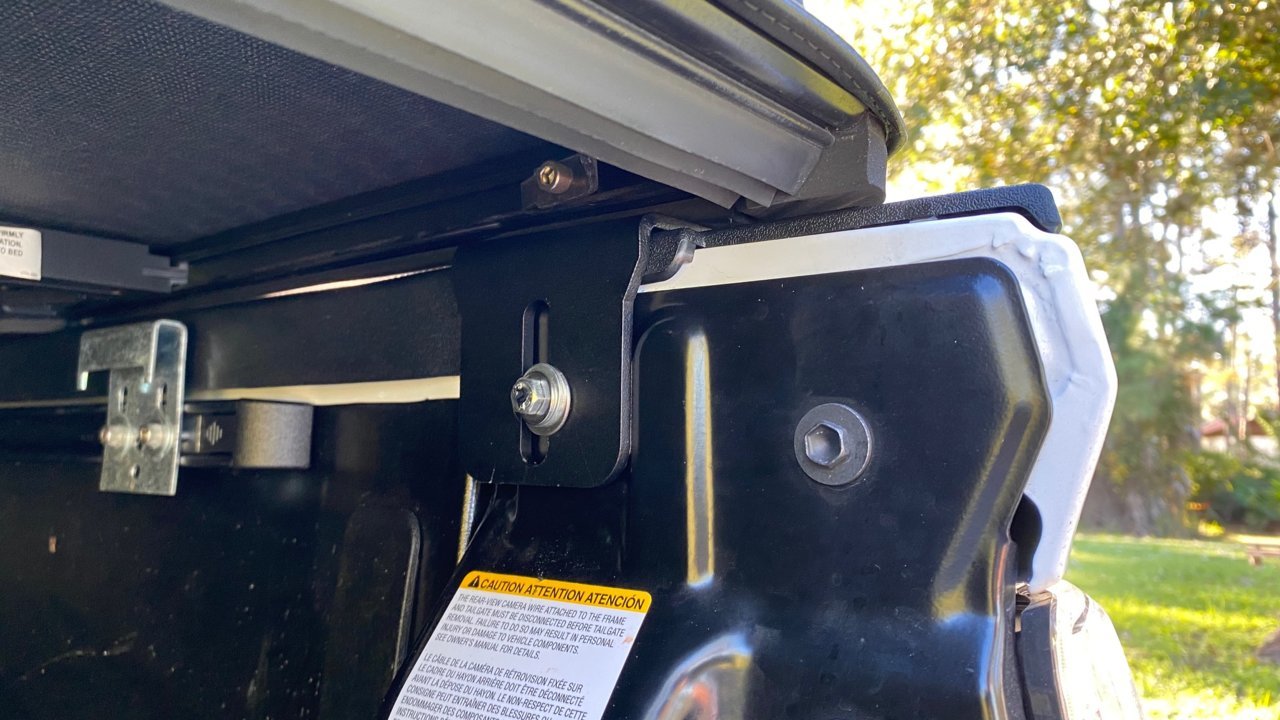

    So it seems that Taco_Dak, already answered your questions but heres my build for addition confidence that a long bed rack does fit on a short bed tacoma. The only thing i would do it go out and buy a longer M6 thread screw. If you decided to use the original screw off the Tacoma it barely has a enough threads to give a good torque down. The mounting screw closest to the cab will utilize the tracks as it should.

    Also build instructions is very vague. It gives you a rendering of the product to build off of and says to build rack upside down on a flat surface then install. If you do decide to buy one i suggest to install everything upside and on a flat surface as recommended but not to torque anything down until installed on the truck. It took some pushing and pulling in order to align the mounting holes to the tonnaeu cover brackets.
