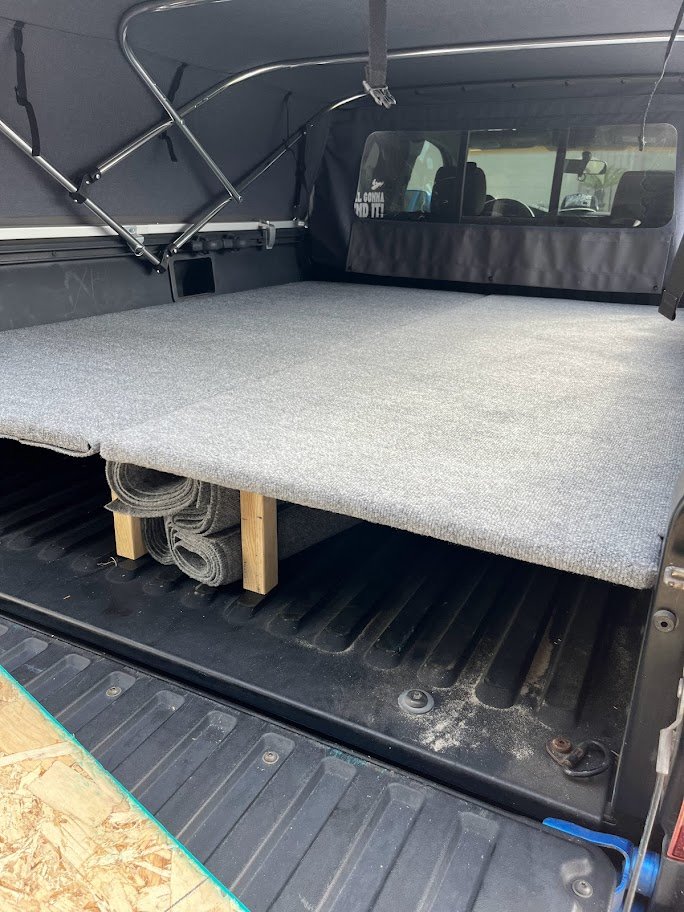

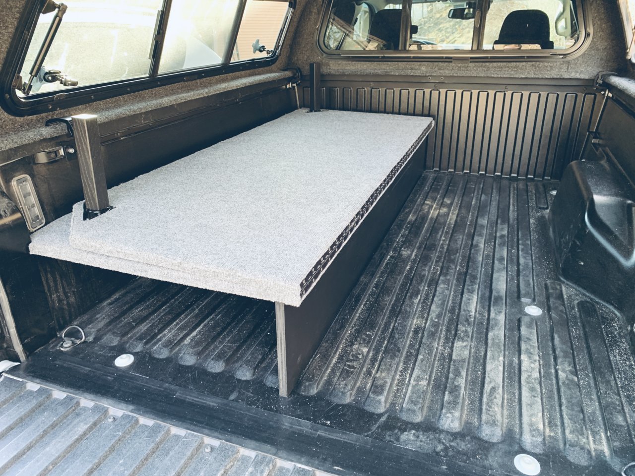

    Want to try your setup. Where did you get your hands on the screw in supports and the metal bracket they screw in?

    I would guess the legs are 2x2s, the threaded parts are studs - wood screw on one end, machine thread on the other and the plates are furniture leg bases.

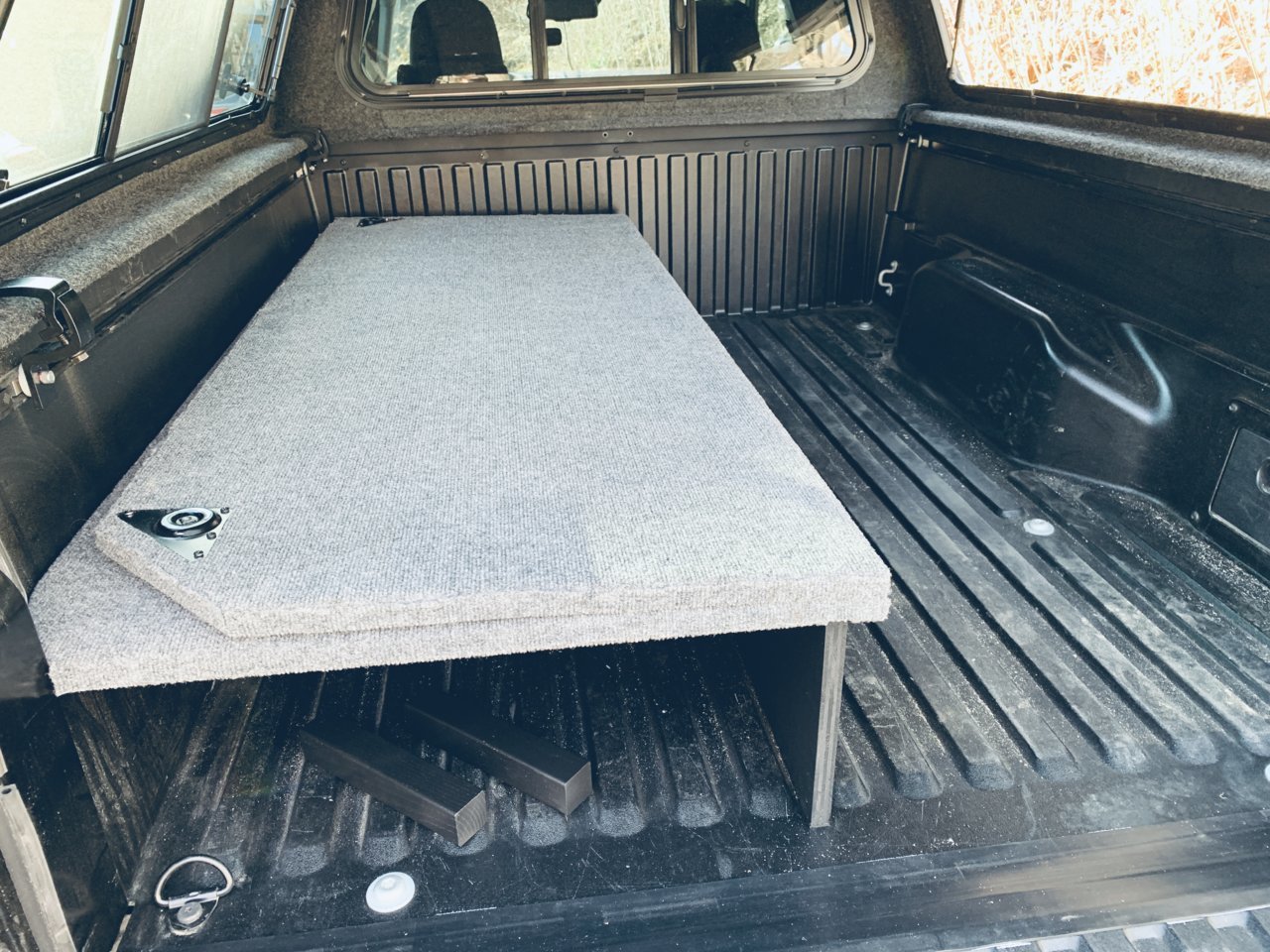

    Finished my platform the other day. Super happy with how it turned out. Thanks for all the inspiration folks!

    Awesome work!

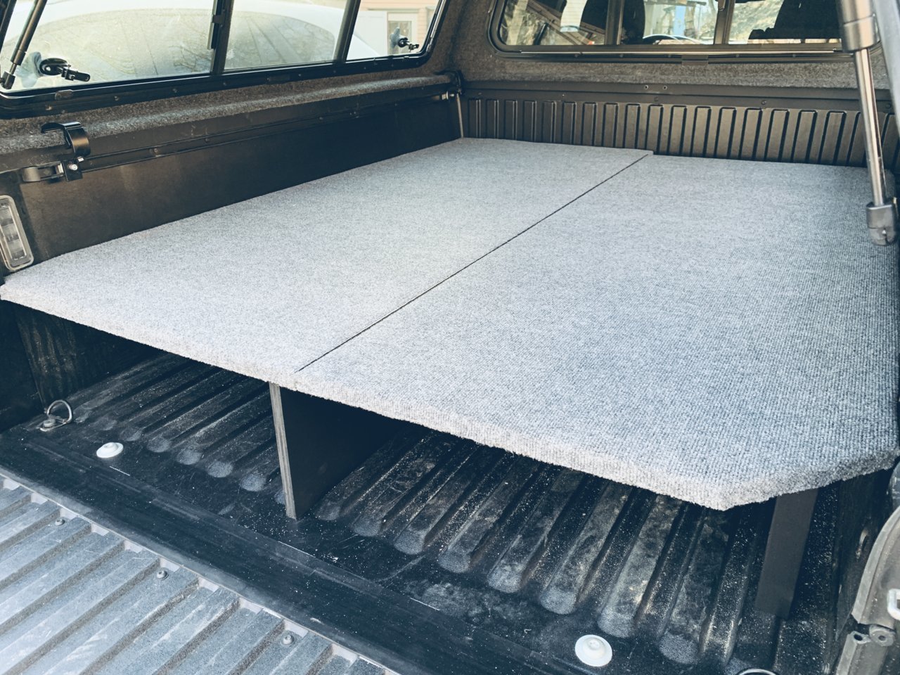

    Sorry for the delayed response, haven't been on the forum in awhile. I bought the legs from Home Depot. They're made to be furniture legs, but work great for this also. I cut them to length and painted them black.
    https://www.homedepot.com/p/Waddell-15-1-4-in-Parsons-Table-Leg-2665/100540024?
    https://www.homedepot.com/p/Waddell-Heavy-Duty-Top-Plate-2755/100390125

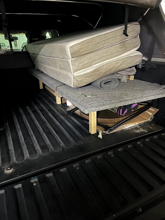

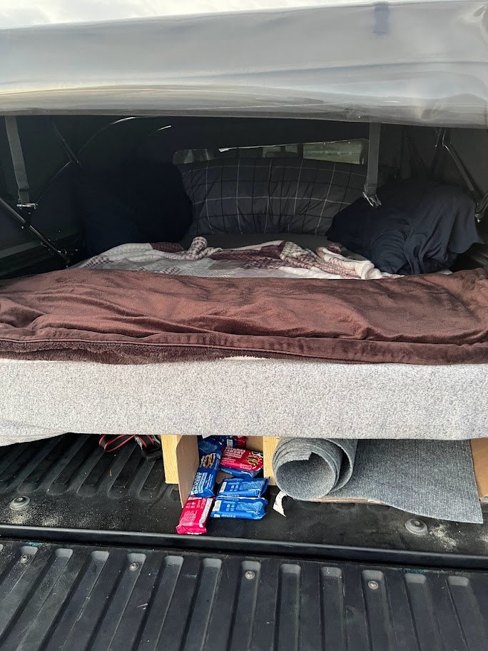

    I did this original build because I was doing a two-week road trip and some of the dates would be a single night in a campground, leave in the morning. So instead of pulling in late, setting up an entire campsight, then breaking it down in the morning, I could just sleep in the truck, leave in the morning.
    It's about quickness and convenience. Some people will drive and need to sleep. Better to sleep in this than the backseat, if you're taller than 5'8 anyway. It was honestly something I didn't use a ton but when I needed to it was great.
    Also, I strategically packed the underside: only things that were "maybes" got pushed to the very back. I also attached those things to bungee cords so I could pull them out. Low-height plastic tubs are great, they can fit under the platform and can be slid out. It's a really convenient setup if you have any desire or need to sleep in a covered part of the truck.

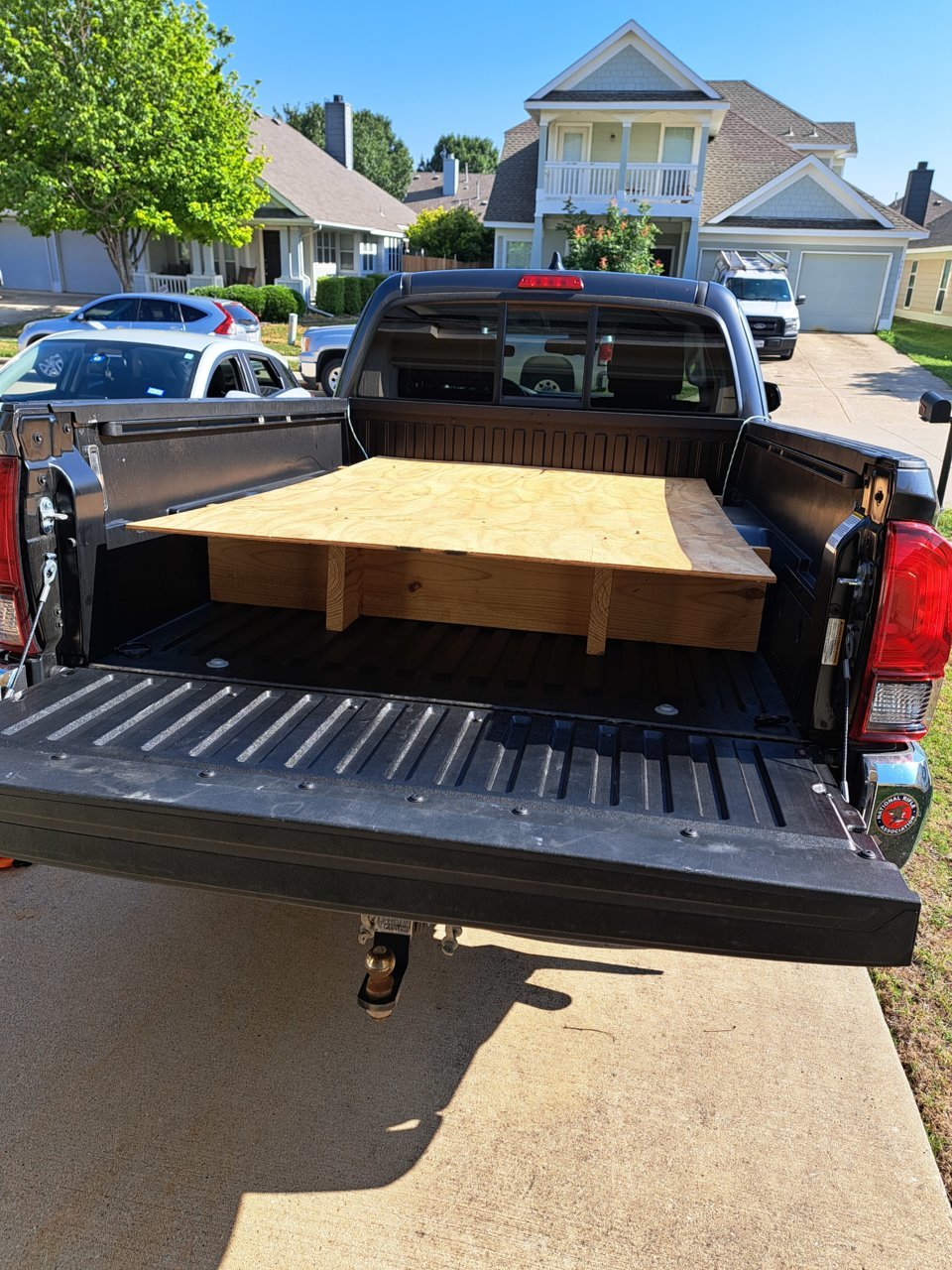

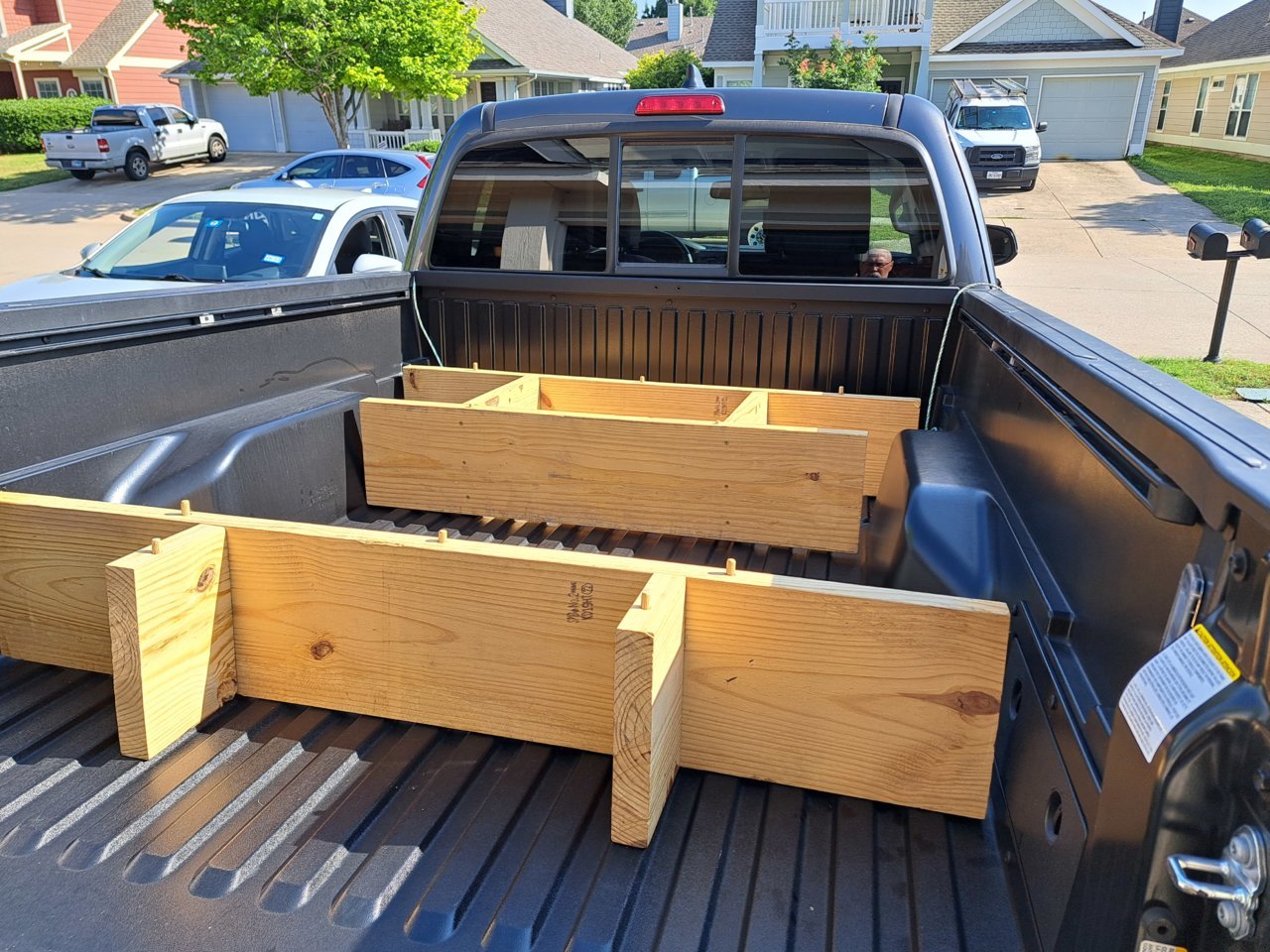

    Nice. I went a bit less complex. Made two frames(a fore and an aft) with 2x10 material. Only use 3/8's plywood. Marked and drilled holes for wood pegs. When not in use all the pieces are in the attic. When in use we toss an inflatable queen size mattress on top(fits perfectly into the bed) and a Tacoma specific tent over. Stowable space is still available under the platform. Built this in 2017 and used it for 7 nights in SD and just this past May 4 nights in NC.20230522_204435.jpg 20230522_204420.jpg 20230520_093143.jpg 20230520_092216.jpg
