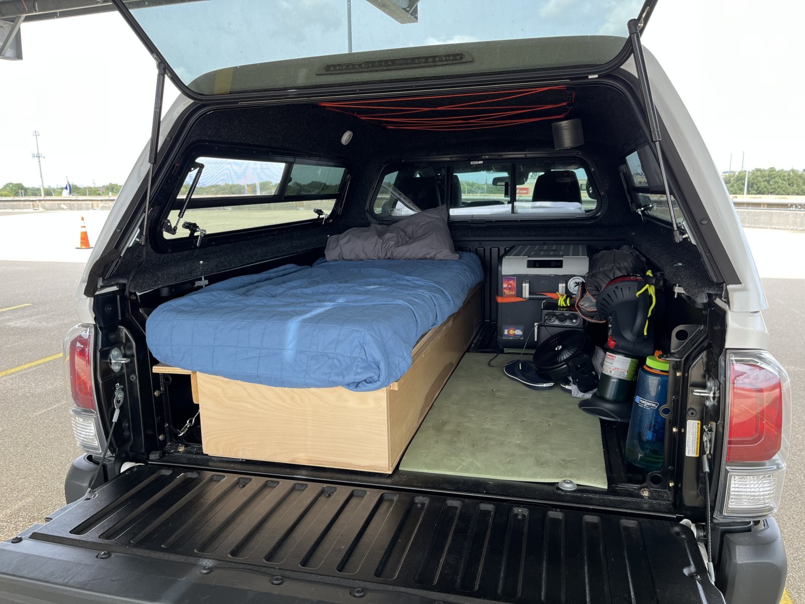

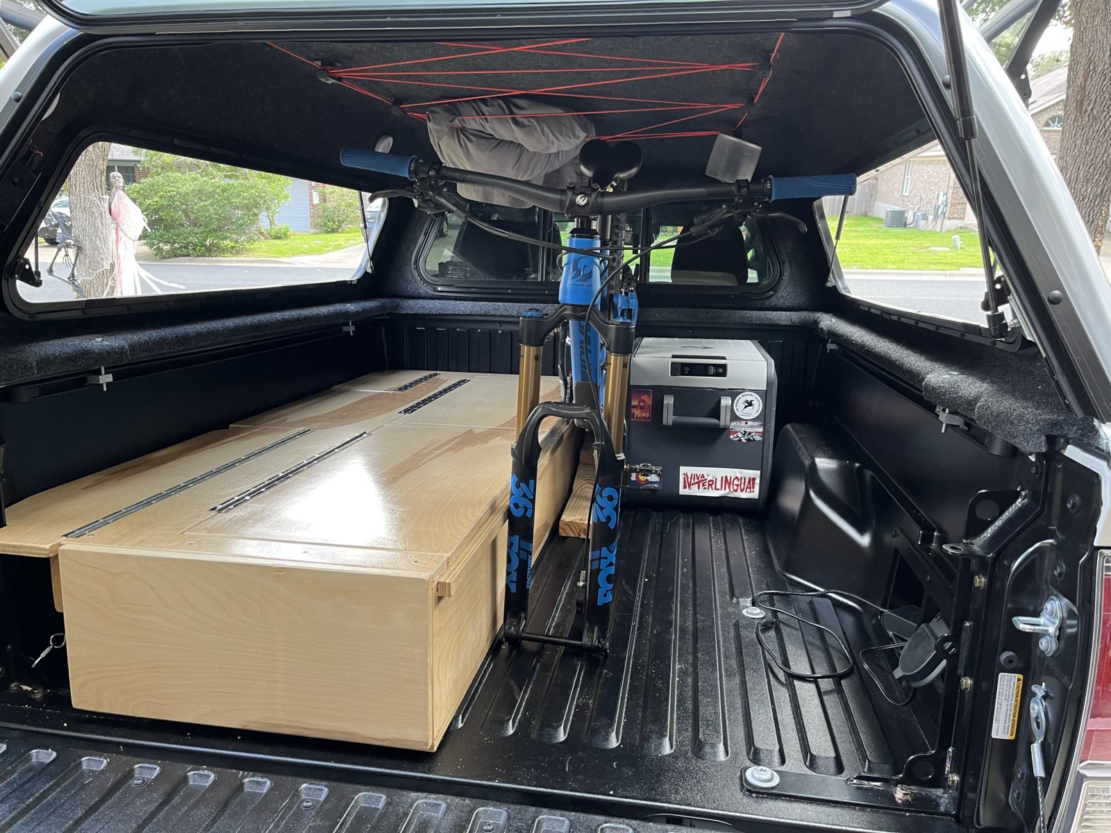

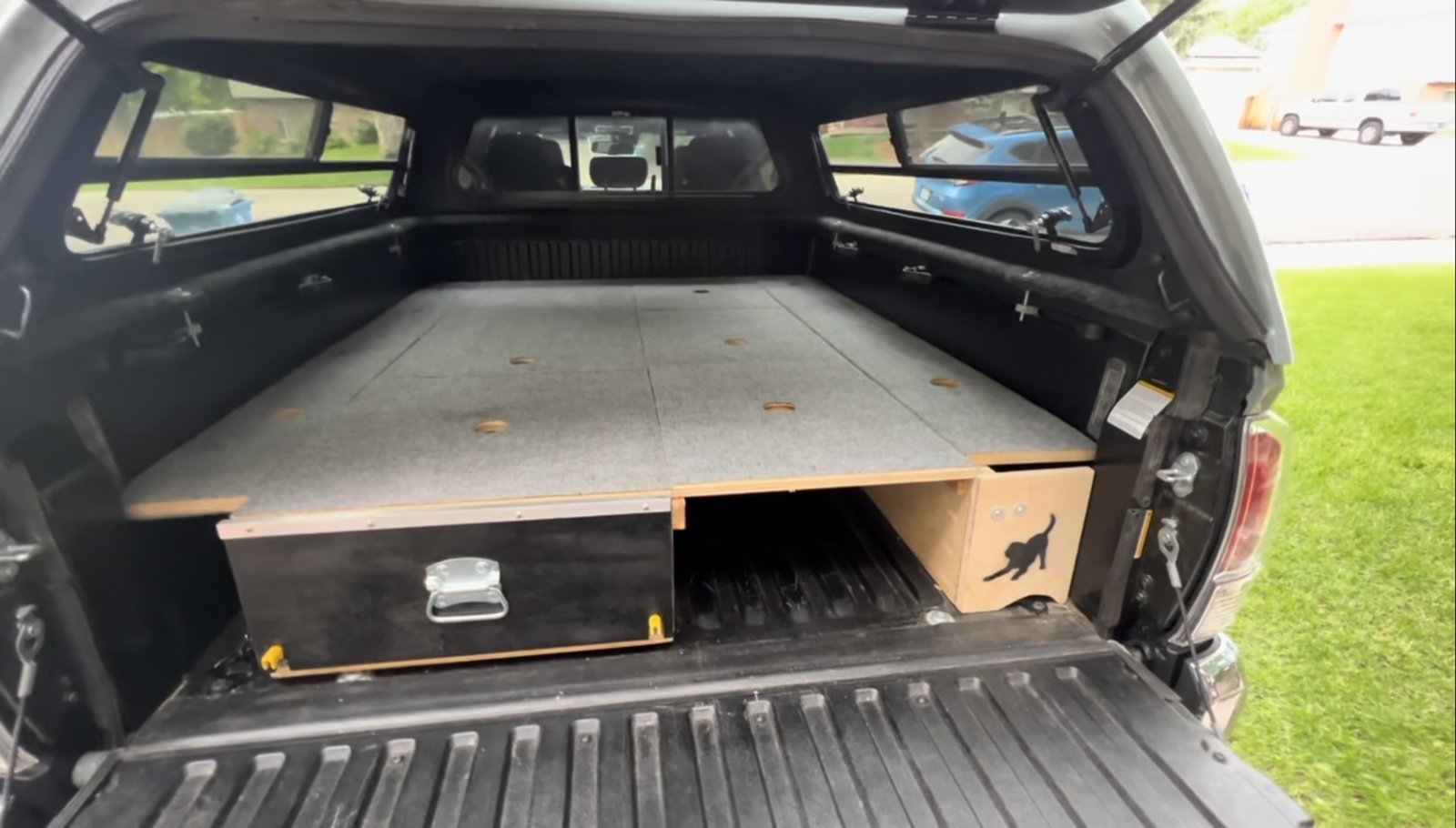

    I love when this thread gets updated. Here’s my contribution I finished a couple months ago. I’ve spent 12 or 13 nights in it so far. Love it.
    It’s a mix of 3/4 and 5/8 birch. Access doors on top so I can get stuff out without opening the tailgate. Flap doors over the wheel well cubbies too. And I keep the fridge near the cab for a nightstand. I can access it from the windoor, no slide needed.
    There’s another panel I can insert for a double bed when the lady friend joins me. Fridge goes in the backseat for that.

    Looks like some quality work. Like the versatility of the second bed area and a really nice layout.

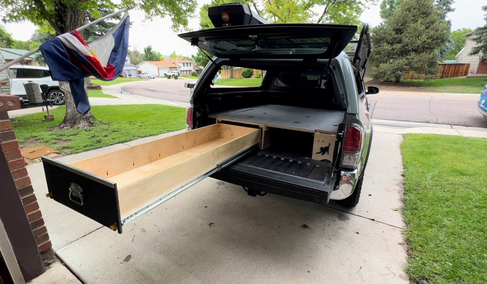

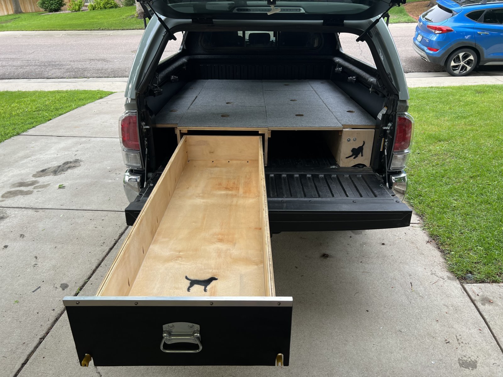

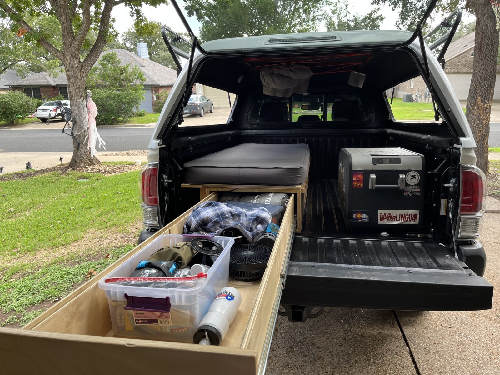

    Finished this last summer. So far this winter leaving that second side open has been great for skis, chairs, etc! Wish I would have made the drawer out of 1/2 inch ply instead of 3/4 but it’s just a little heavier than it needs to be. Fun project!!!

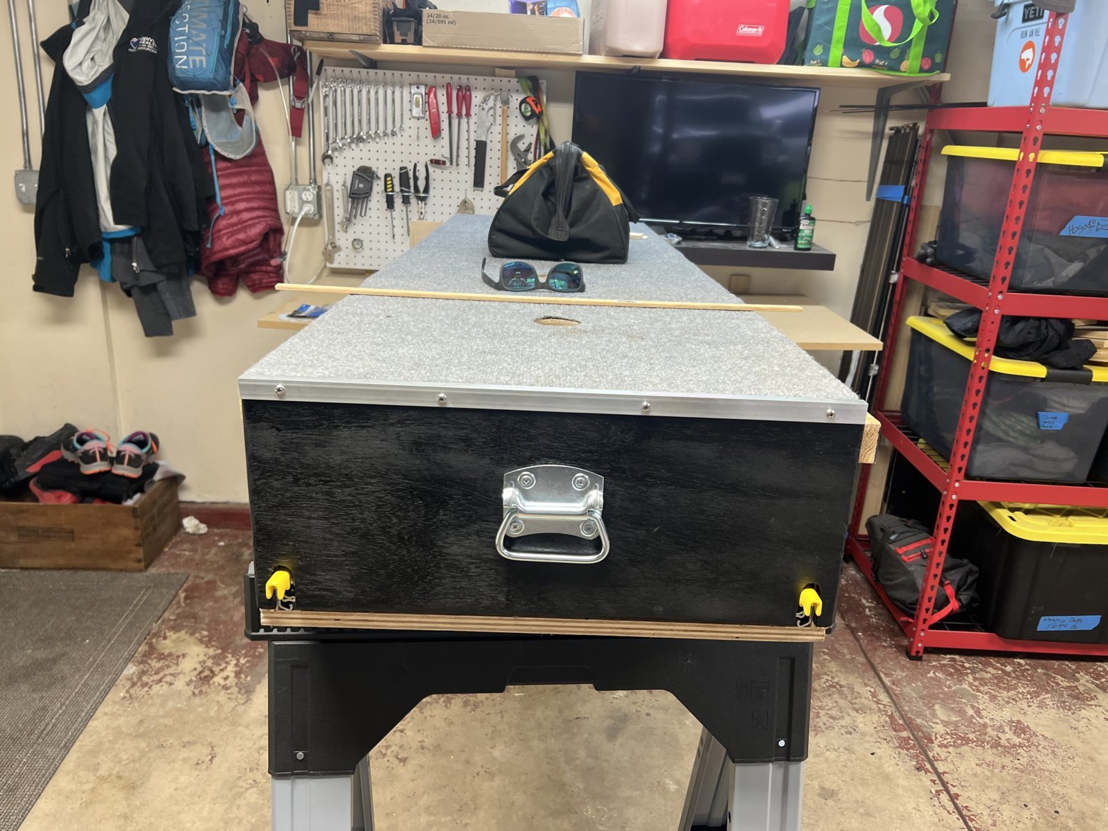

    I guess I didn't post mine up. I went a bit different route, steel.
    20230805_200728.jpg 20230805_204627.jpg 20230529_163314.jpg 20230414_184519.jpg 20230414_184547.jpg
    The platform has since been covered with carpet. The battery/solar controller/inverter fit under the platform, with plenty of additional storage. Traction boards have since found other mounting. Hooking/unhooking the tent from the truck takes just a couple of minutes and gives me room and flexibility in case of rain.
