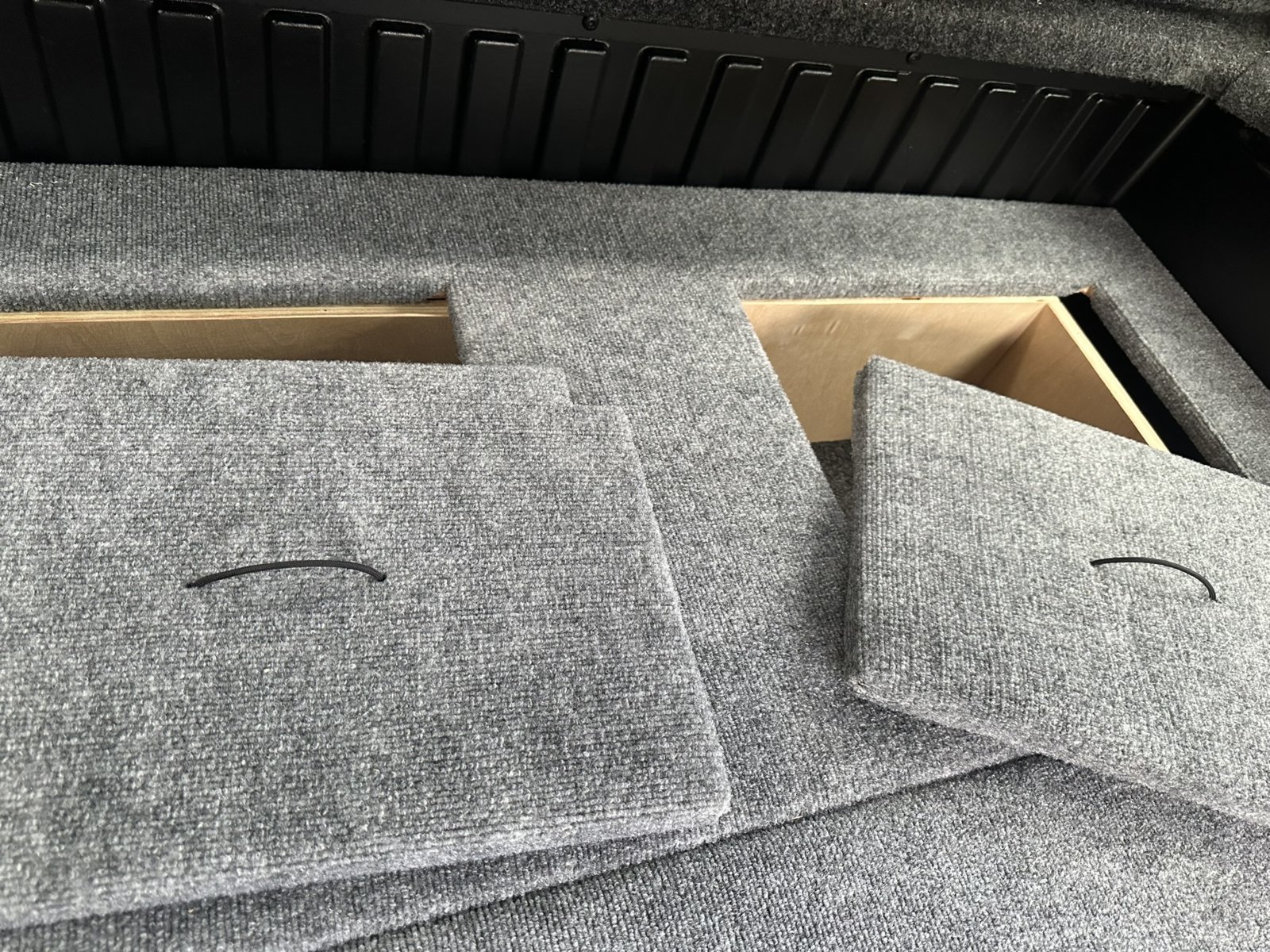

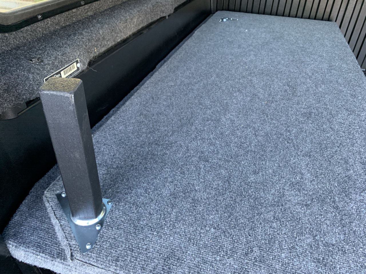

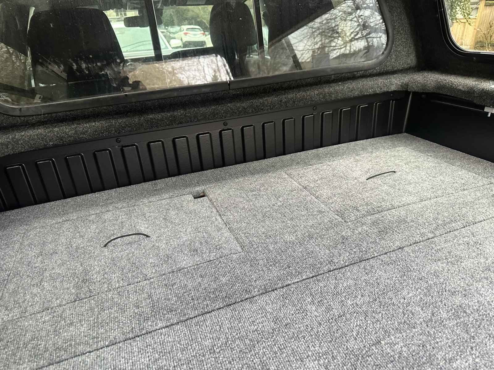

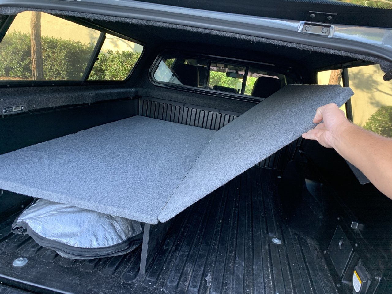

    2023 Tacoma Limited DCLB
    Built this platform upon getting my new DCLB. Pretty much went exactly like the original. Had some issues as I used scraps of residential carpet and it made things too snug with the bed rails. Otherwise it worked great!

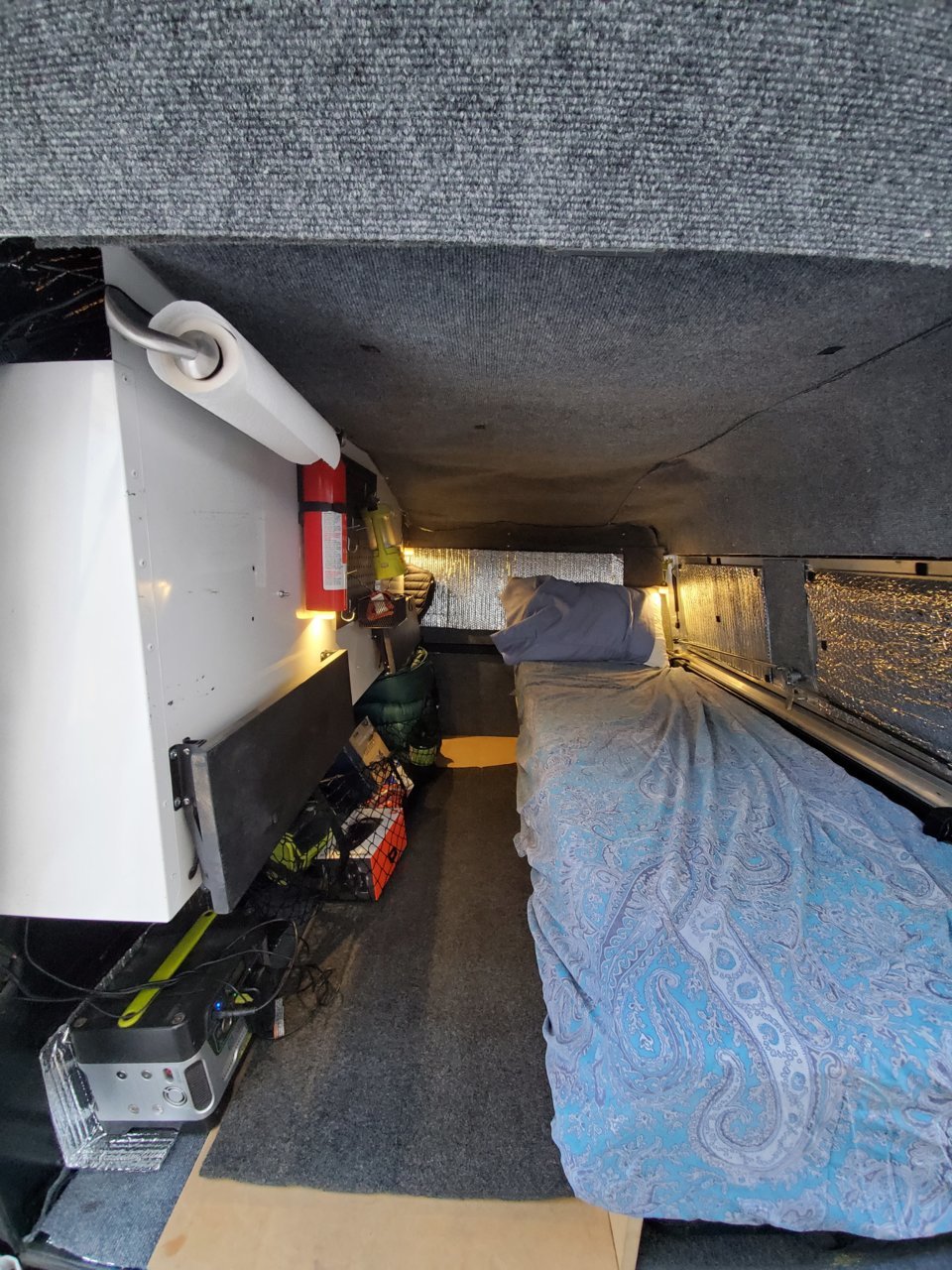

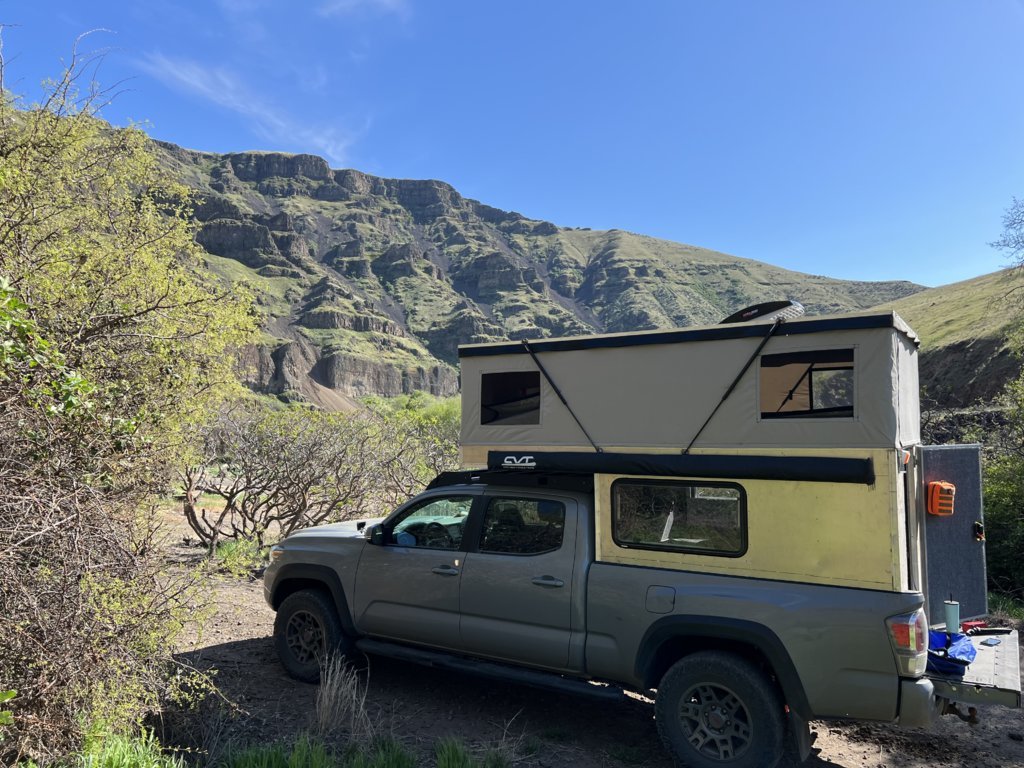

  12. Sep 15, 2024 at 9:38 PM
    #152
    G_W_Chonkr
    G_W_Chonkr Well-Known Member
    Mar 11, 2021
    #359012
    89
    Enzo
    Clackamas, OR
    2020 Tacoma TRD OR
    I have one that I installed on my DIY wedge camper. While I just got the setup completed and camped 4 nights in throughout west Idaho, I can confirm that they are quiet and move air. Also draw very little power. I ran mine through the night, 2 nights in a row and it only drained 1 4aH Dewalt battery on my temp electrical setup. I was running 3 sets of LEDs for bed lighting as well. Not for long but long enough to drain some of it down. I have more pics I will add to my profile of my setup with the electrical if interested. I through it together since the trip was last minute.
    Update: Uploaded a few more pics of the setup and can grab more tomorrow if needed for the electrical panel. Should be pretty straight forward to understand though.

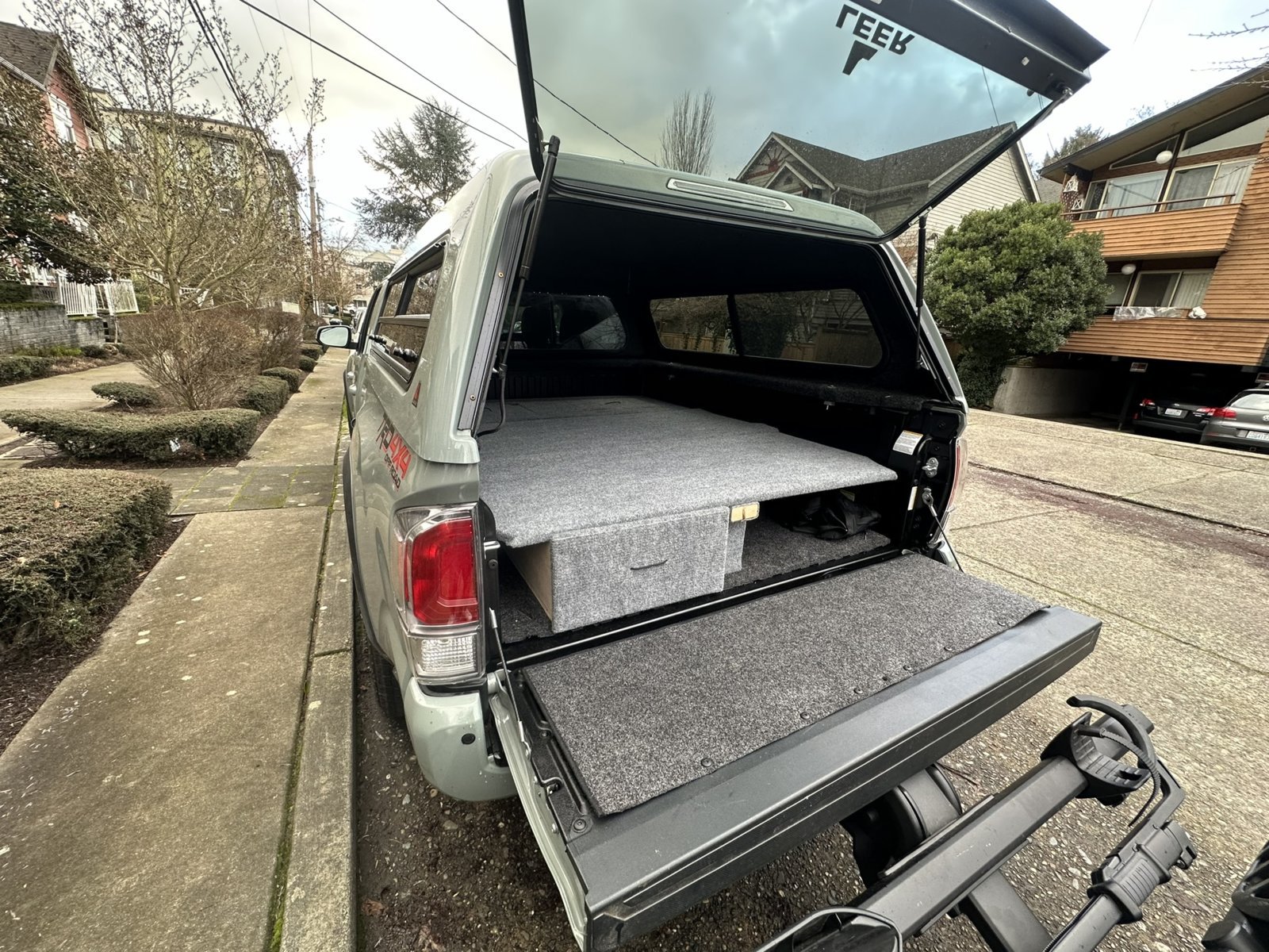

  13. Sep 27, 2024 at 3:44 AM
    #153
    Samsquatch
    Samsquatch Member
    Mar 26, 2024
    #446708
    17
    Sam
    Burnaby, B.C.
    2023 Grey Tacoma TRD Sport
    OME MT-64 2.5 lift Falken Wildpeak AT4W 275/70/17 Pedal commander throttle control Westin sidestep Leer cap
    I finally got the leak figured out fully. Turns out the windows were mounted low, so when it rained, and especially while driving, water would get in from the top edge of the caps windows. We re-mounted all the windows so they covered all the edges of the holes evenly and bam, no more leaks.
