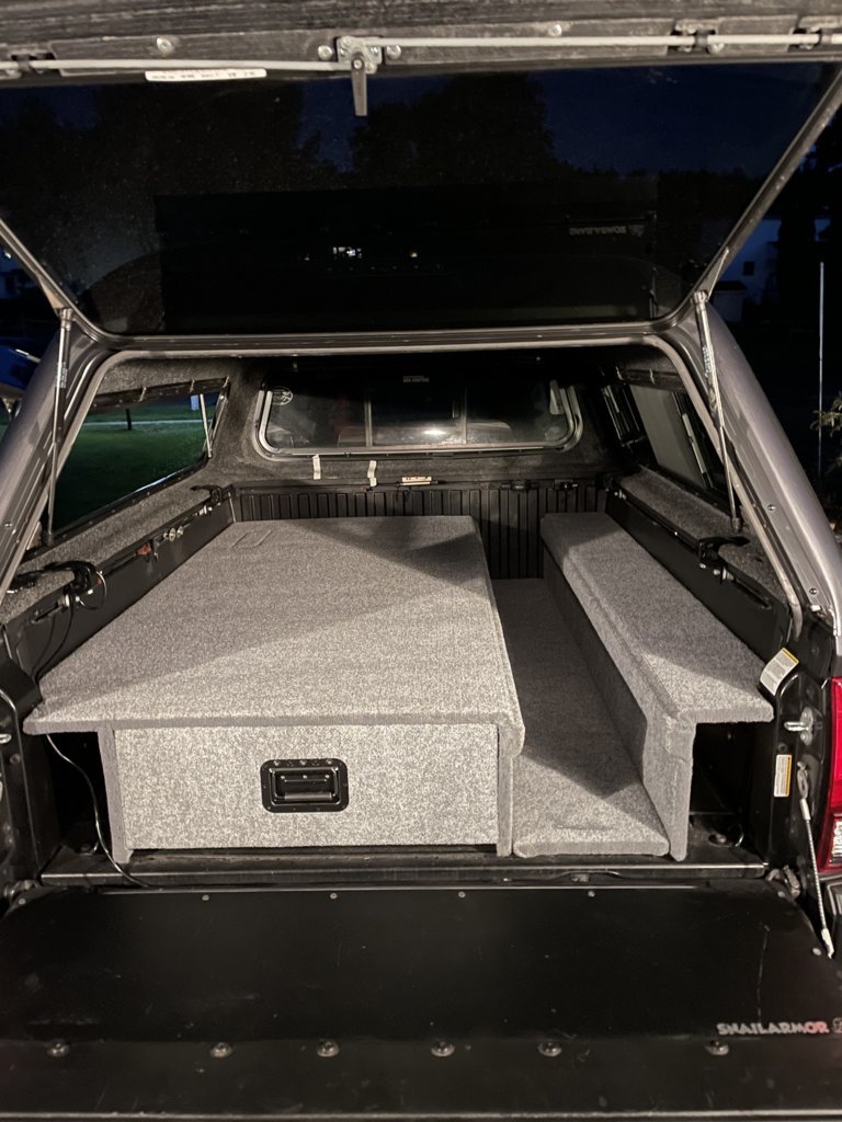

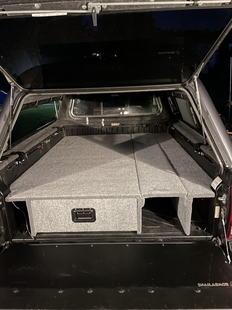

    How it’s done Boyz.

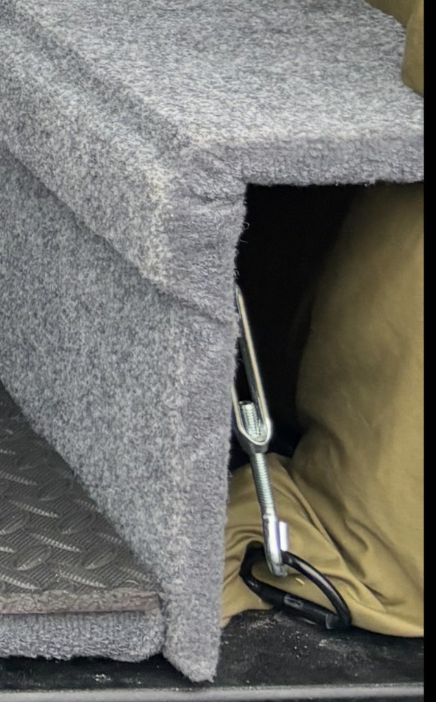

    @SavageAdventure that looks awesome!! How does the smaller section stay attached on the right side? Is that carpet and what's the drawer system slide on???

    A turn buckle at the font and back of the bed. It pulls the piece tight to the side of the bed so it doesn’t fall off the lip on the bed wall. Pressure holds it.

    The entire thing is wrapped in RV carpet from Home Depot. The drawer slides on rollers.

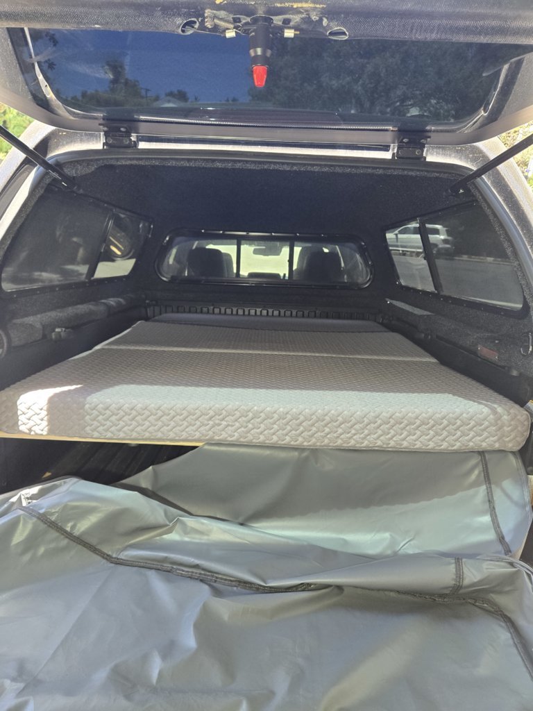

    I tried to use bam beds + Milliard Mattress in a hifhliner to be able to sleep at an angle as I'm close to 6'5". There is no comfortable solution for someone my size if you want to close the tailgate and hatch to stealth camp.
    Trying to fit between the wheel wells with a pad directly on the bed was even worse.
