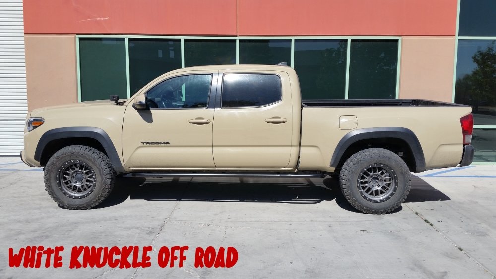

    17A65041-D801-4546-909B-8072781699CA.jpg D6B3F450-FE7A-4B5C-BCFF-806AC615D845.jpg
    These are DCLB sliders.
    DCSB sliders would be shorter. There are no mounting points for the sliders under the bed (highlighted area). The only mounting points would be under the double cab.
