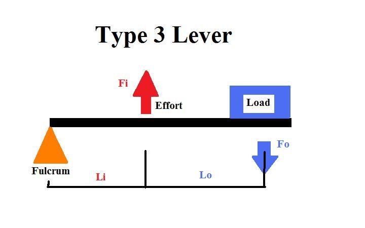

    For those of us who tow, physics really answers this issue - a trailer tongue weight is the load portion of a 3rd-class lever, the rear springs and rear wheels are the effort keeping the load up, and the front wheels are the fulcrum. The further the load (trailer tongue weight) is from the fulcrum (front wheels) (Li + Lo) the greater the effort (rear springs and wheels) must be to support the load - also, the further the load is from the effort (Lo), the greater the effort must be to support the load, thus the springs and rear wheels on a short bed undergo less downward force from the load than those of the long bed.
    A short bed may be a better choice for towing heavier trailers, as the tongue weight will be more equally balanced between the front and rear wheels, and the rear wheels and springs will require less effort to support the tongue weight than those of a long bed.

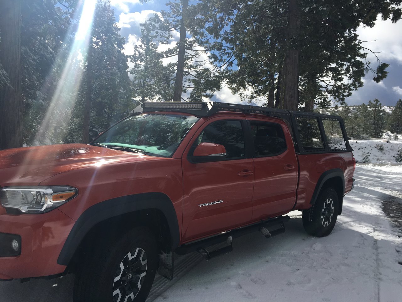

    Lol, my long bed hauls a lot of plywood and drywall .
    But only because I’m remodeling my wife’s Nuno’s home that he built over 100 years ago. Damn thing has rock walls almost 3’ thick !
    My longbed does a good job of hauling everything...almost everything :).
    But not the reason I bought it.
    I just really like the long bed !D42BBECE-26A6-41DC-BE3A-59BEBB9871D0.jpgbesides as you can see by the heavenly light I think god likes it also!
