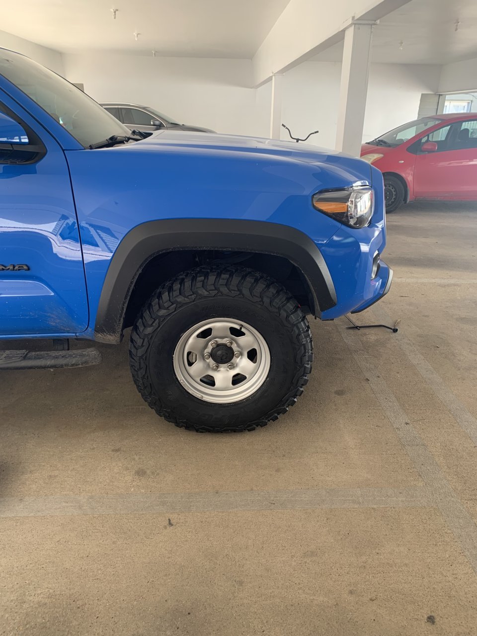

    New boot goofin. Real ostrich. Only 3 payments.
    Actually, these are Land Cruiser 70 Series steel rims with 255/85-16 km3’s, not ostrich. Just trying them out for a week before they went on my 1971 FJ40.

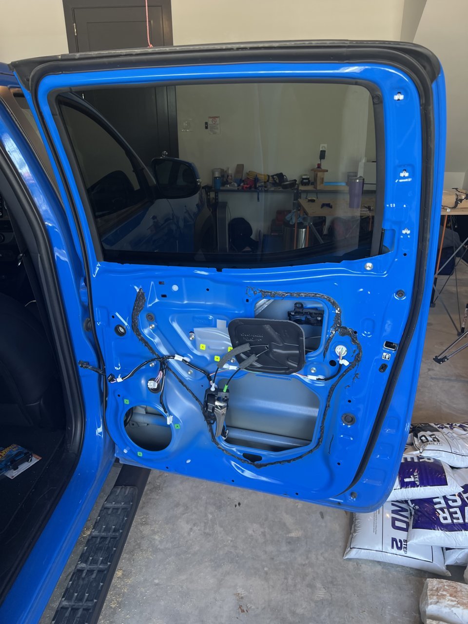

    Decided that the taco was too loud during long road trips (where I get most of my miles in). So I added dynamat and 1/4” closed cell foam.
    Foam also helped with temperature insulation. There used to be heat from the transmission hump coming in and that is gone now. The doors stay cool too. The ac quickly cools the cave here in houston, even on the hottest texas days.

    Layer 1 - dynamat
    Layer 2 - closed cell
    I tried to get as much coverage on both sides of the door as possible. Also covered the speaker box and plastic sheet covering the door opening in closed cell foam.
    Once the 4 doors were done, everything went back together and you couldn’t tell I took them apart.
