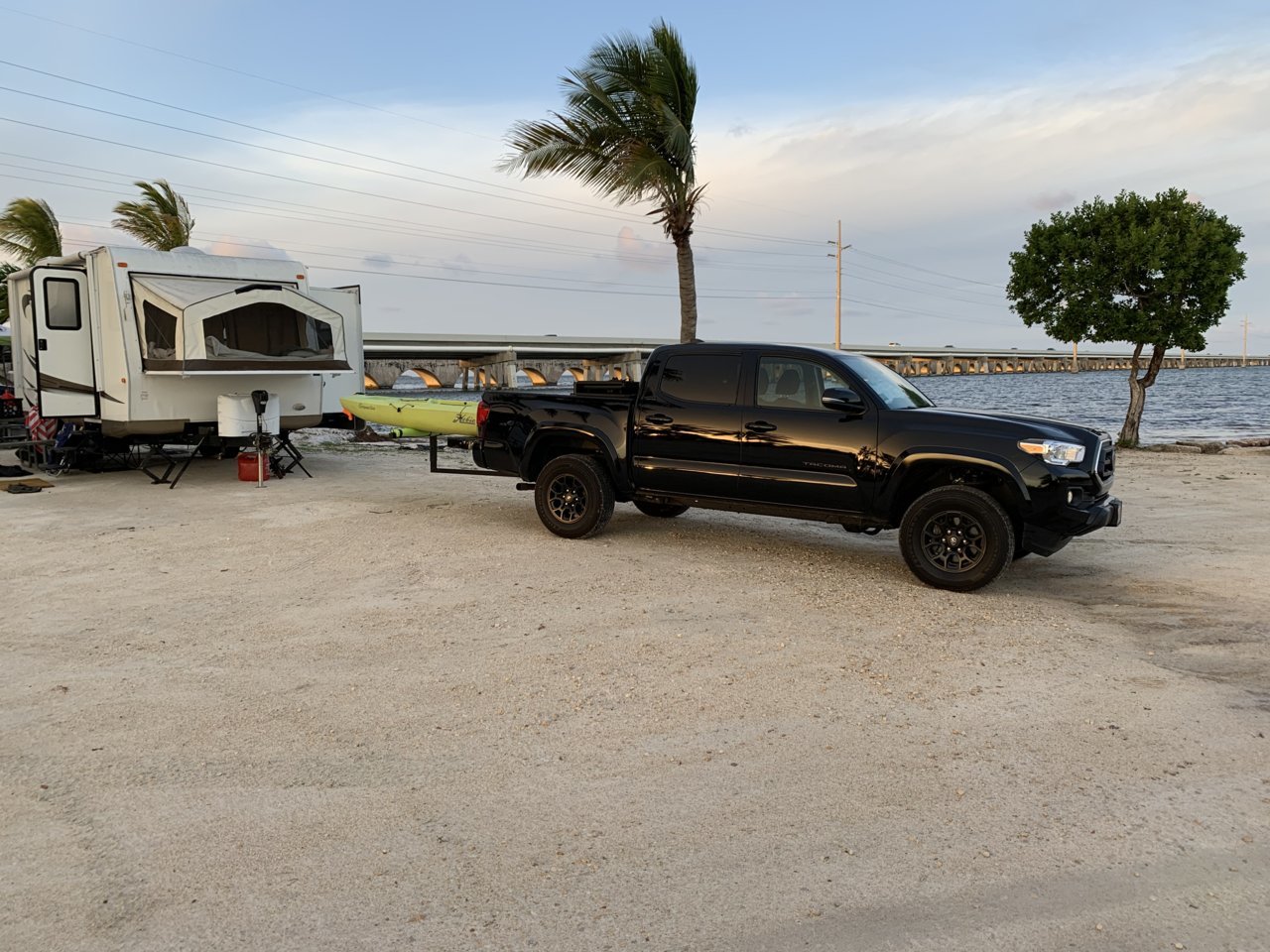

    Well we made it! MA to Disney in three days. Then Orlando to the lower keys! Hope the return trip goes as smoothly… but forget about that for now, where’s my fishing pole!
