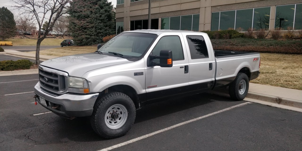

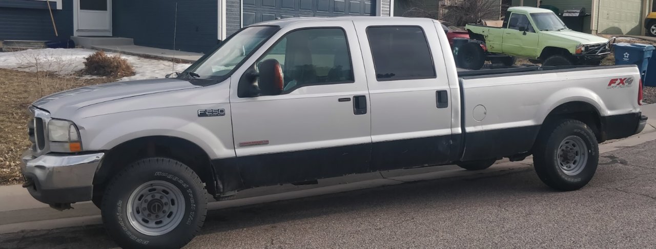

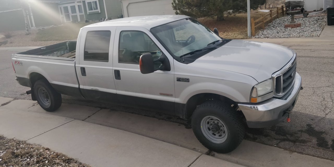

    picked this one up right before Christmas. Goal is to have a long-term reliable truck that I can drive through winter and use to tow my Tacoma to/from the trails.
    I bought the truck in December 2018 with only about 1000 mi on injectors, turbo, high pressure oil pump, oil cooler blah blah blah. We've all heard the story from previous owners :rolleyes: I bought the truck for a deal expecting to have to make up the price (1/3 of one in mint condition) in parts and labor and I am definitely doing that as I discover how full of shit the PO was.
    Her'es what it looked like when I picked it up

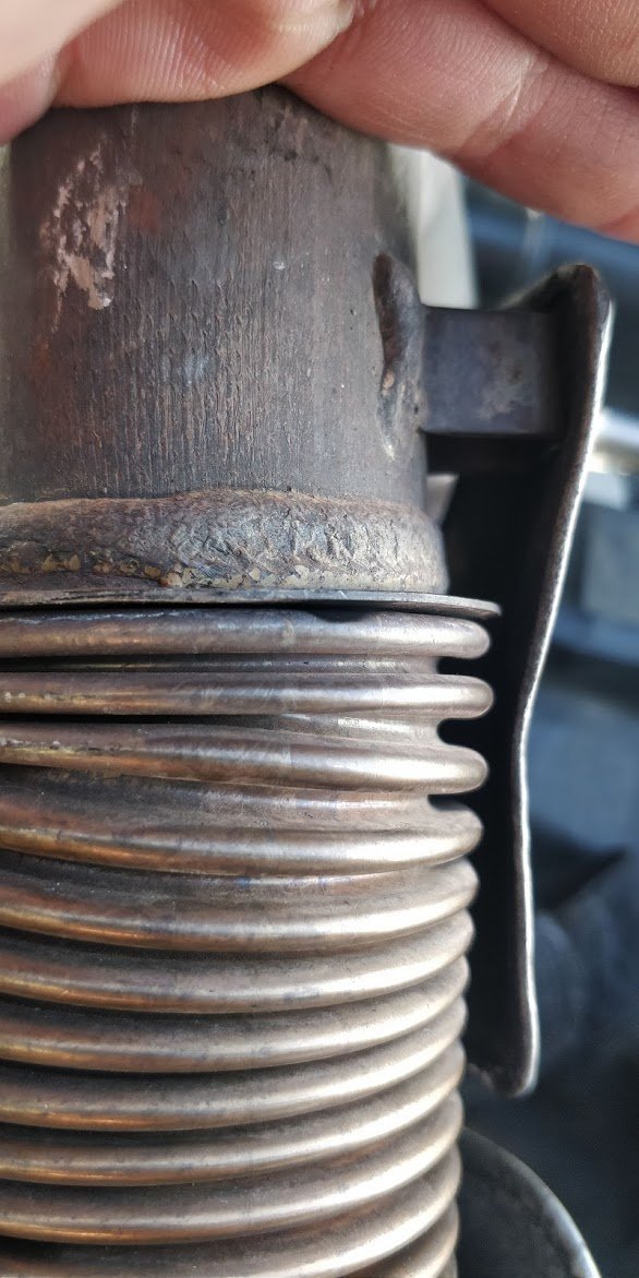

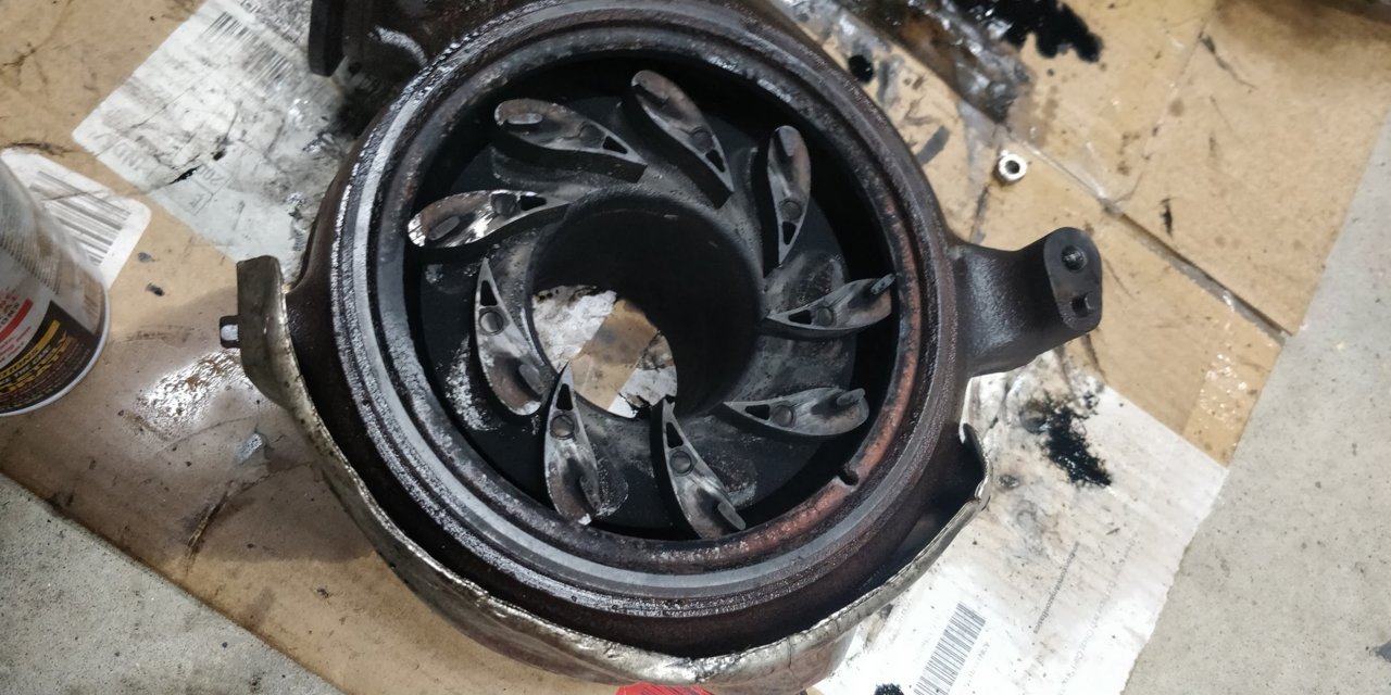

    Of course I only made it a couple hundred miles before it started having issues where it was struggling to boost and not revving past 2000rpm. I pulled the variable geometry turbo off to clean it and discovered that it was very sooted and definitely more than 1200 miles old.
    PCGJ-_HOfaupsnDFqINxzROS3fzEodVhTb2XRXvo_248696fc67b36993dc7047290cb1e1cd1c43151c.jpg

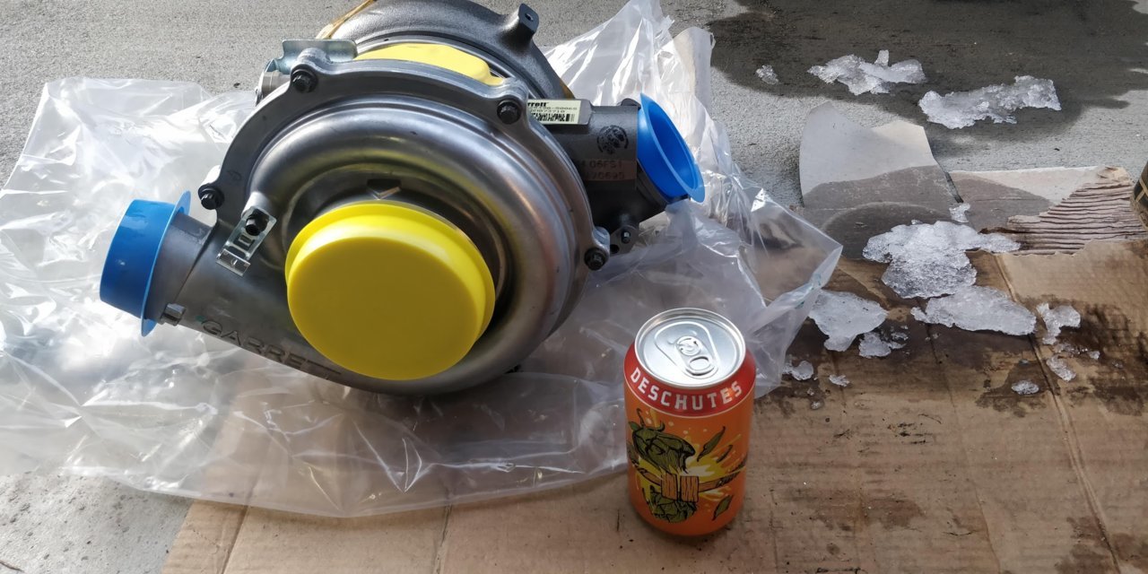

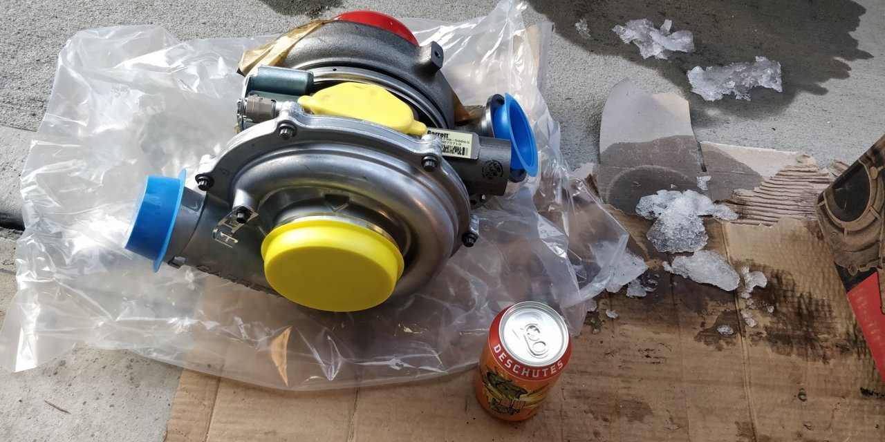

    blah blah I ended up replacing the turbo with a new one after discovering that it also had shaft play and needed a full rebuild anyways
    SEqnaDVw37AryfOmEGL3oJLMCaaPuLs4p53e5FEp_3cf3e1bcb970d1dd57896b62aca418a3ae88637c.jpg

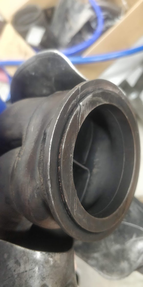

    oh yeah, the y pipe was cracked and starting to leak and had some mystery damage on the flange from the previous owner so I replaced that too.
    mY8QHREgzdkX6Q-YmjqGHpyk3h0xuN1w18GdyIEU_be50f7c291e3b7b3153608ec8f57b16687293810.jpg
    7xo0U8JgnP1EXKe_GOGtfZyFkuV1SK-EZJfP-tyQ_d7649af9fa291f8ac15e231ed308d507a4c44d19.jpg

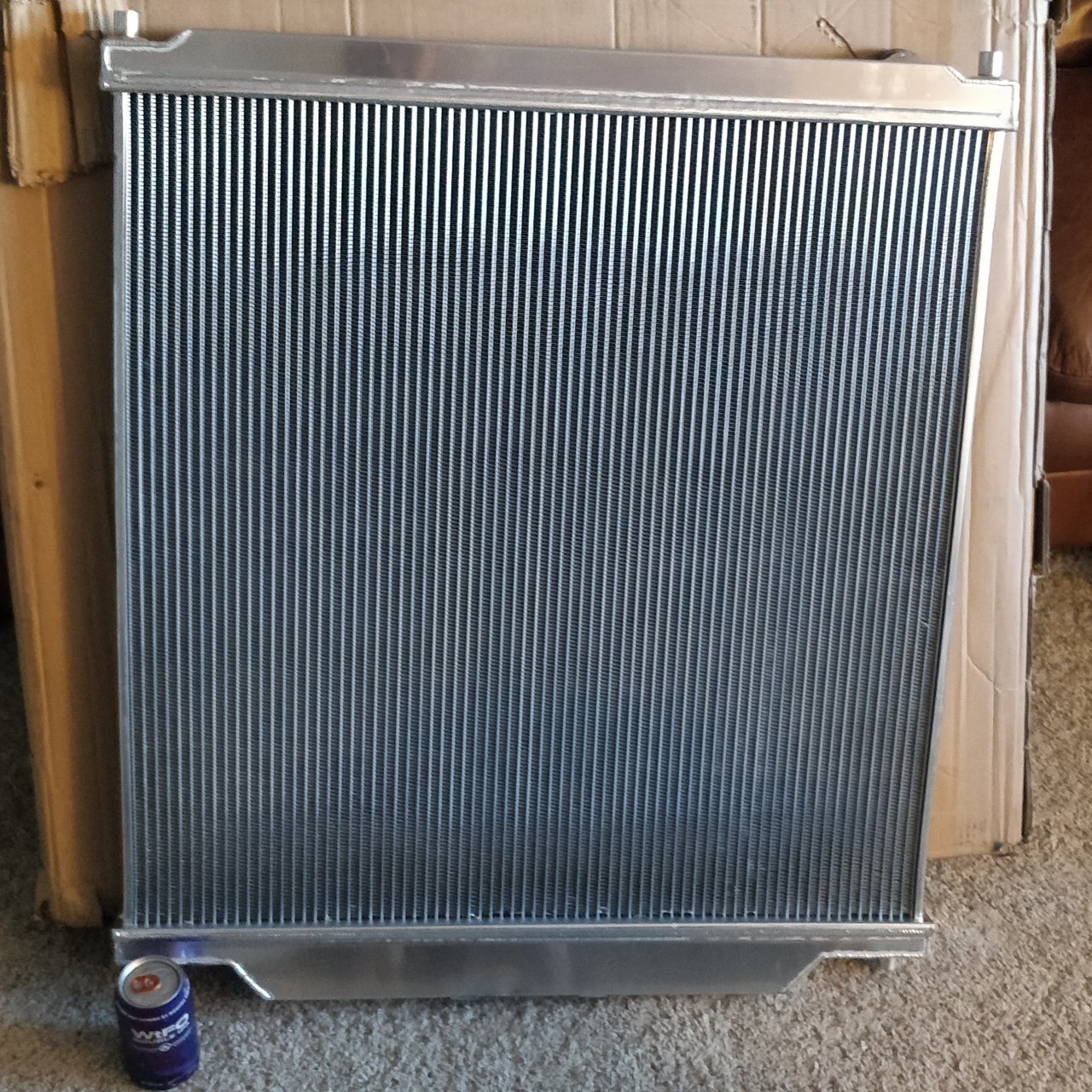

    eBay all aluminum radiator

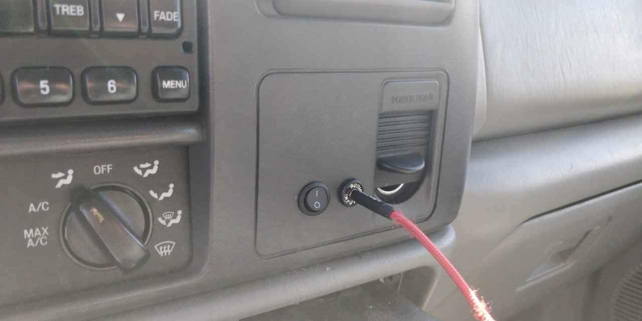

    I added an aux input FM modulator that I picked up from @JasonLee so I could play some tunes
    Dg51fa_91esnbTdbAT67Tn3GcoToMzuTSqygglMF_a9cbd1620c3a4edab4bc88f6b5ad4b6b95929834.jpg

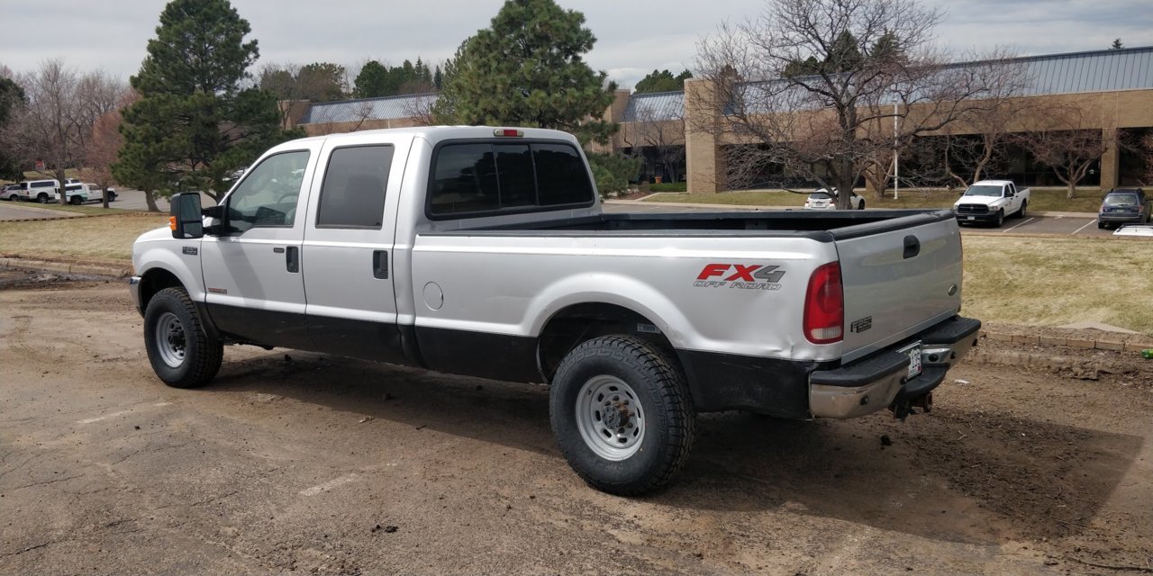

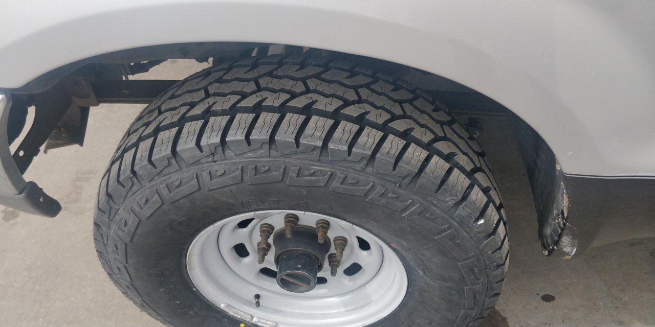

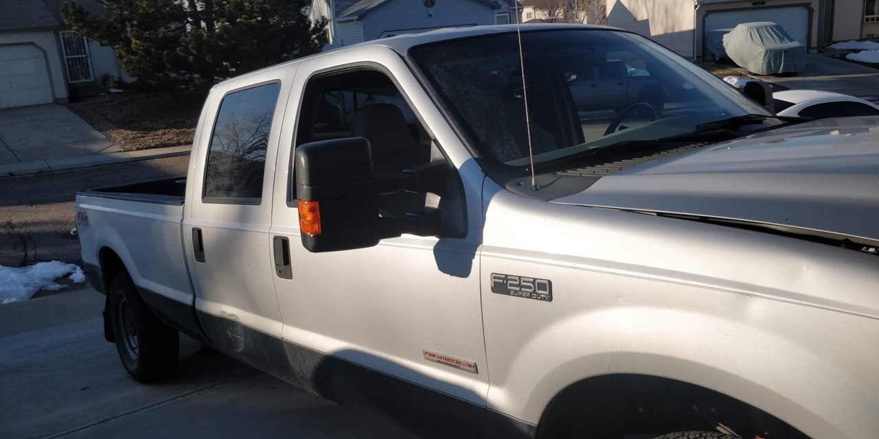

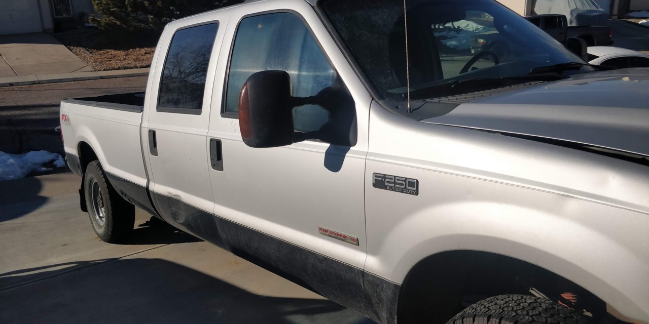

    How the truck sits today 4/3/19 with a brand new set of 285/75R16s. When I bought it it had a set of very dry rotted but new tread BFG rugged trails and I decided I didn't want to roll around on 16 year old tires at 80MPH
    O1l13nYWuRPOEWmMmAhV2FpixUV9wXZhcnZRXQqy_866e3be15a7655a23b5185bca78fb814b19244a1.jpg
    eJ5_e_xtLdoO2j14iyXL3QZDEHfe-ygHP9j11-8L_41af8d2ea730715d89589f0b11587b5365e26ab5.jpg
    IYu6j5XTK94OboiAaknrjbDGYKl9eb8ukp4sdJ1x_bb4e06b6f01e89aaf37fc83767f3e4d0d112c587.jpg
    egGAuJjkdaWaPG-sLYdDeaaetUKX-uzvUb5PsnD8_393ff7fcb2e8f6398c39069f8f14f8fbdf7b608a.jpg

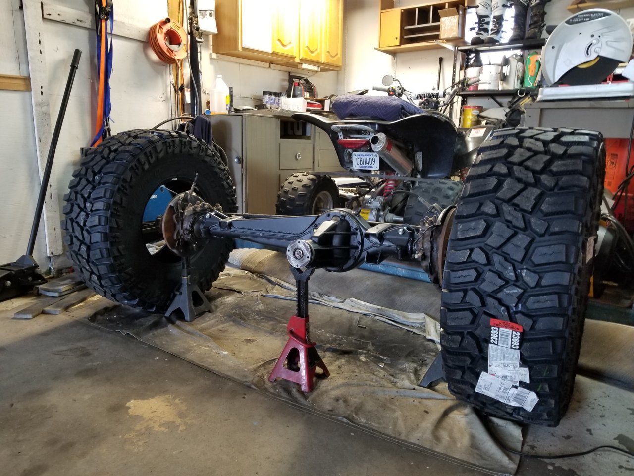

    Good eye, it was a bobbed 85 so it had the factory FI and solid front axle. I picked it up last fall thinking I would make a street legal side by side or something. If I'm being honest with myself it will be years before I get to it because of everything I want to do on the Tacoma so I actually just sold it about 2 weeks ago.
    I have a love hate relationship with these trucks. They sound awesome and make a ton of power when the run right but are really mechanically finicky and intensive. An older 12v Cummins or 7.3L would have been nice but they aren't worth the prices they command here

    Damn that sucks. I love my 4runner. I bought it 10 years ago and finally getting around to doing a SAS. Its an 88 22re. Got some 37s and working on the axle

    Do it!!! That would be so nice having all that power and not relying on momentum lol. I have Cooper STT Pros 37x13.5r17s that I just got from discount tire. I have 5.29s ready to drop once I start the SAS

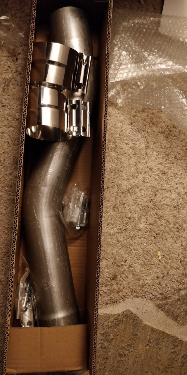

    New muffler setup hath arrived

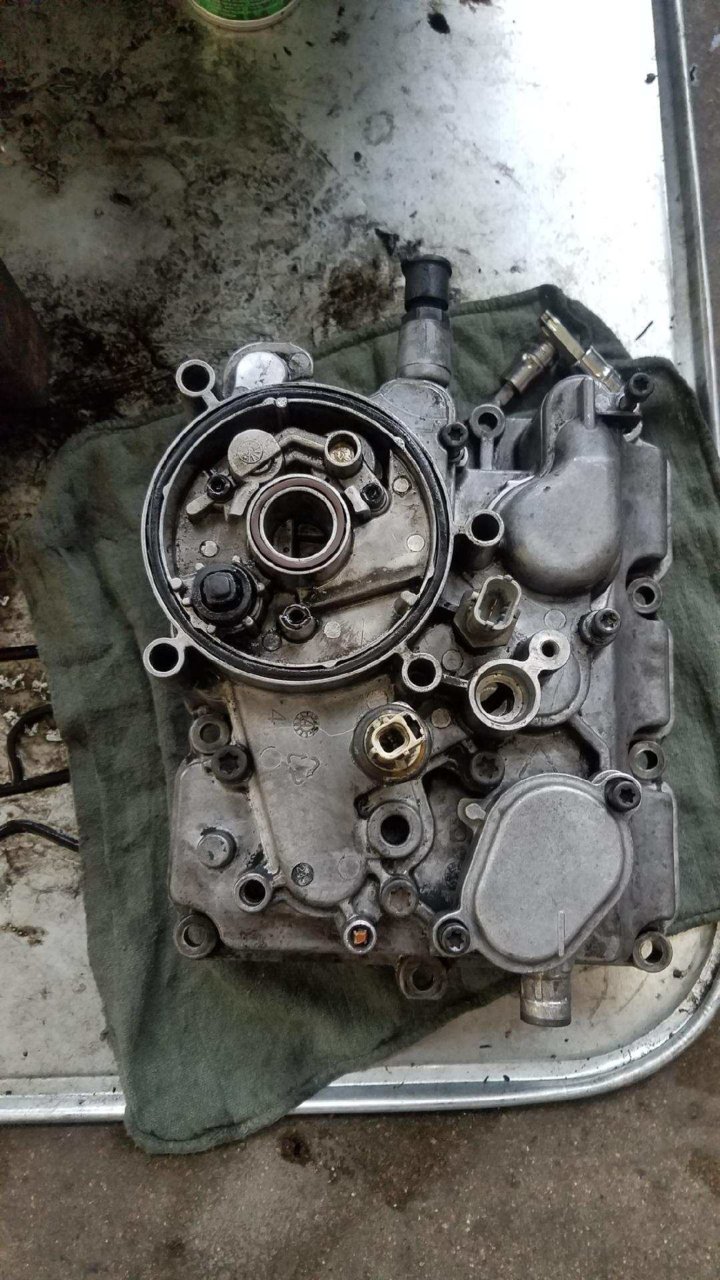

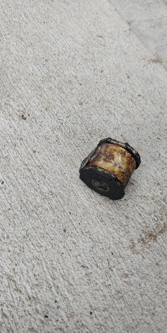

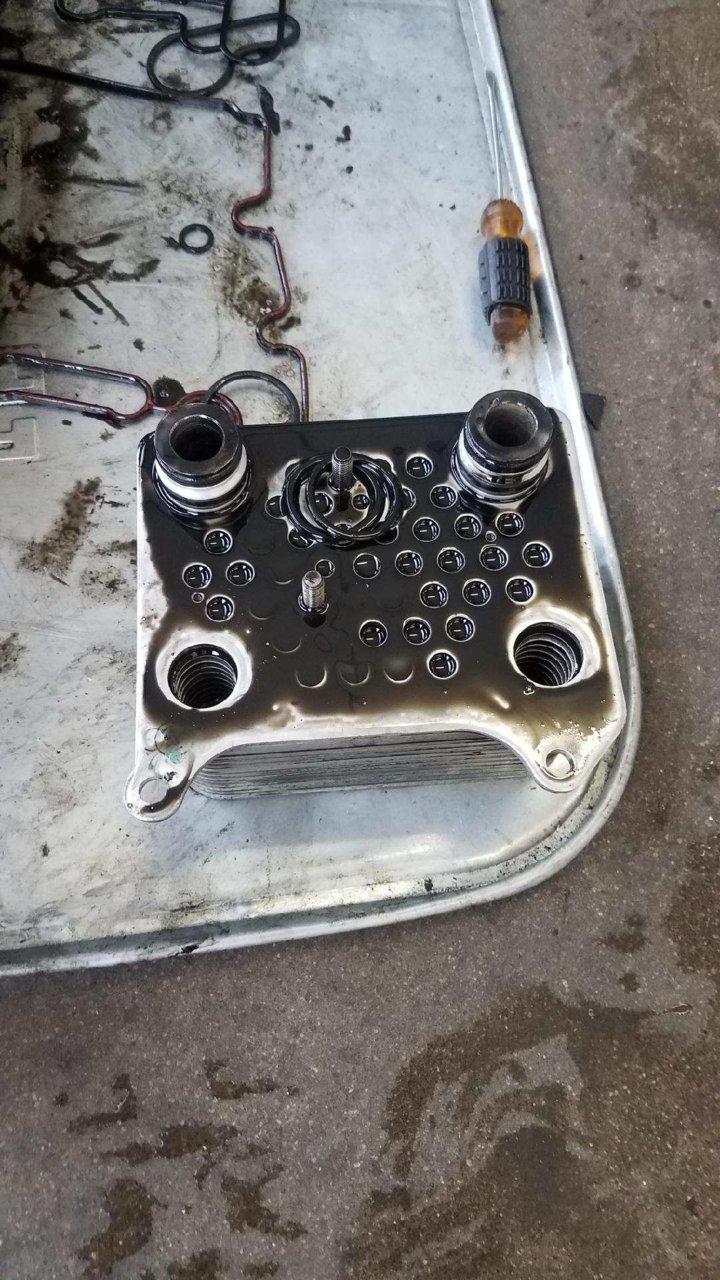

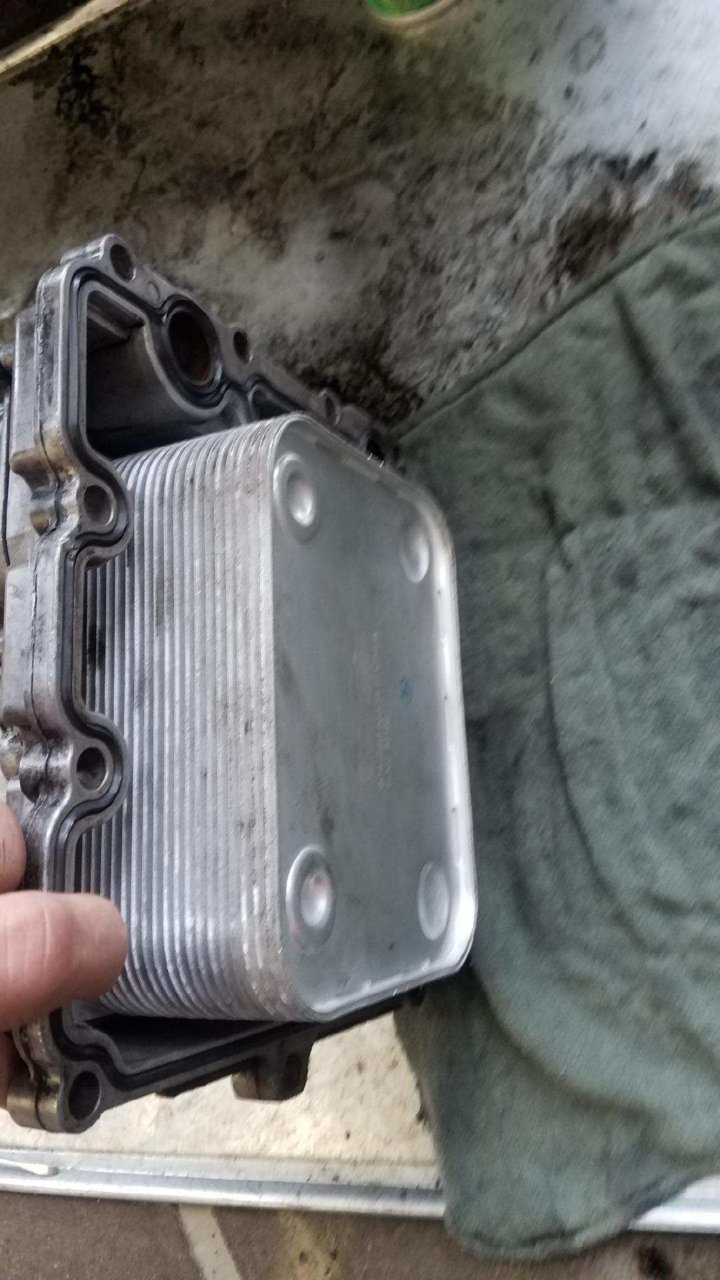

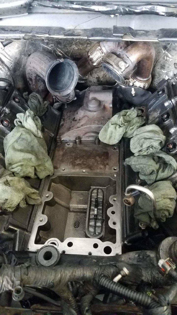

    Found the source of the oil leak, the oil cooler failed and was pushing oil out into the engine valley.
    It looks like it was the original one, the
    updated OEM cooler does not have the small indentations on the top. Usually when the oil cooler fails it lets oil into the coolant or vice versa so I guess I'm lucky there.
    20190508_090649_1557328079481.jpg 20190508_090639_1557328079677.jpg 20190508_090636_1557328080166.jpg 20190508_090633_1557328080739.jpg

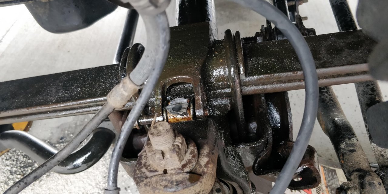

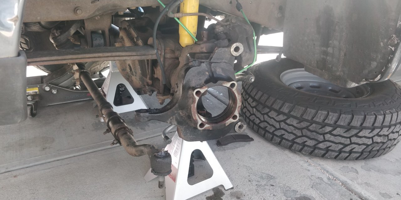

    Different kind of front end Friday... New ball joints, tie rod ends, u joints, sway bar links etc for the front end.
    Didn't make it too far in the teardown today
