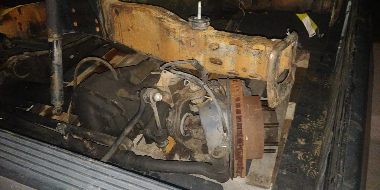

    The coil suspension requires the matching axle which is 2" wider and has cast in radius arm mounts. but....I will have the leaf sprung front left over after I do the swap :gossip:

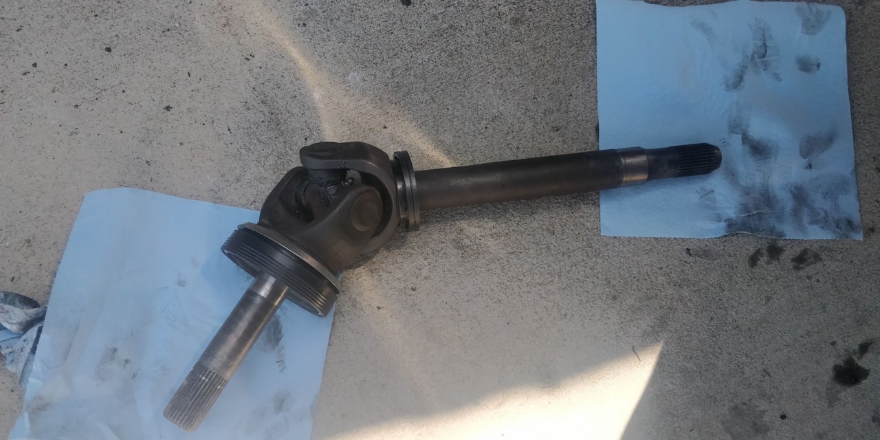

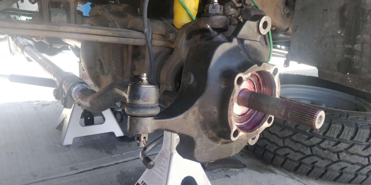

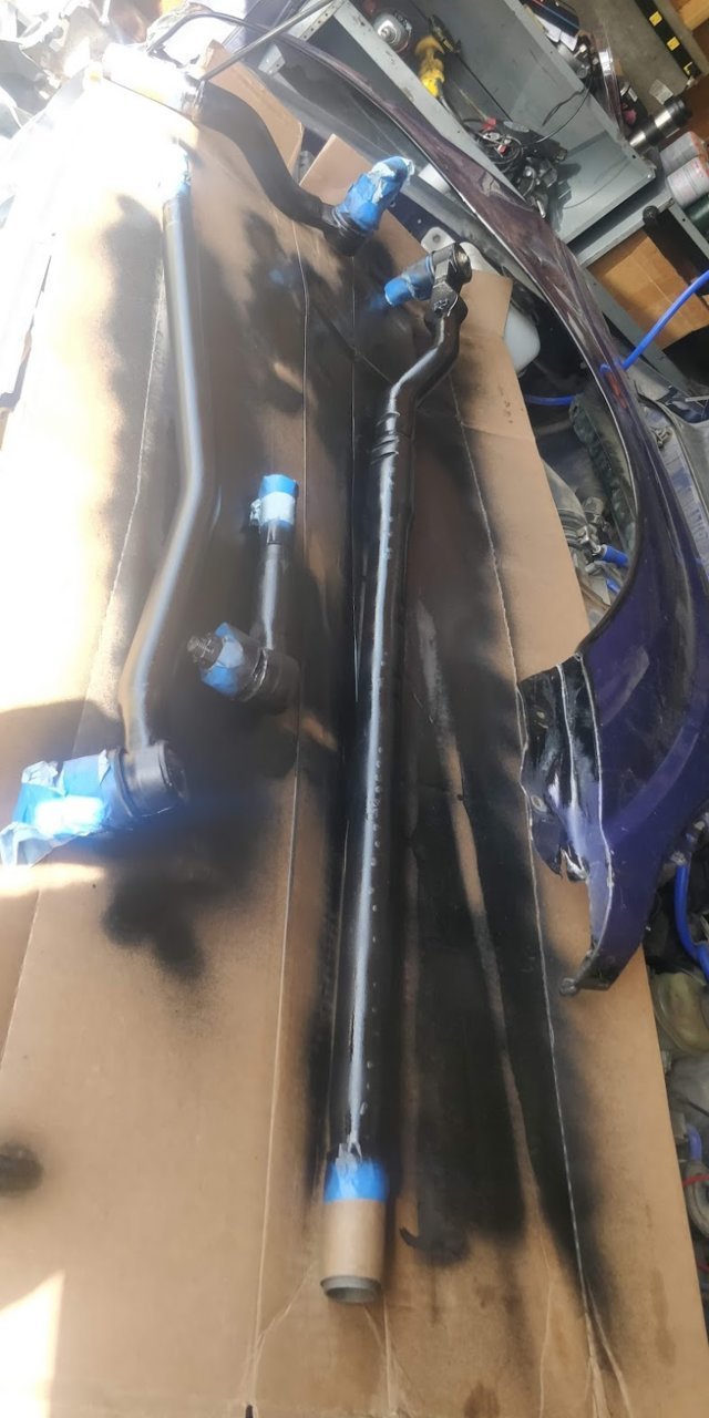

    I got the front end together with new tie rod ends and ball joints and the steering is much tighter.
    Stuff doesn't come painted anymore so I hit it with some rustoleum so it doesn't instantly turn into an ugly brown mess.

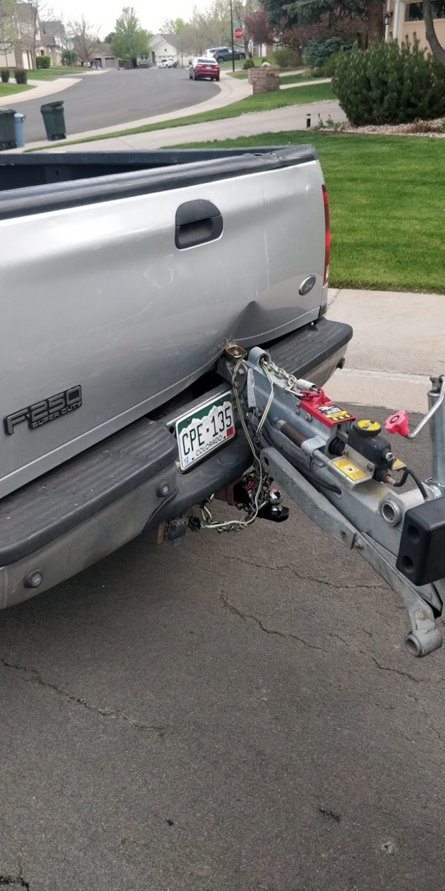

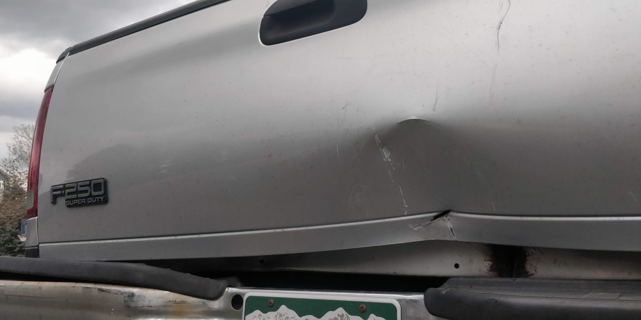

    I have kept quiet til the check cleared but after 2+ months Uhaul's insurance settled. After admitting fault they kept """forgetting""" to send the check to me. I rented a trailer in May to pick up a car I bought, let them hook everything up, and then it came off the ball and fucked my tailgate and bed.
    m_jfpmZi4t1ut4wyX2G0HuQIEpg7--fGYSsngtYU_5e6fbe1f823058d198d70cd58aa7576e96756cdc.jpg
    Truck must have previously had an accident that cracked the bed, you can see the dark spot where it was welded together but said welds cracked when the trailer hit.

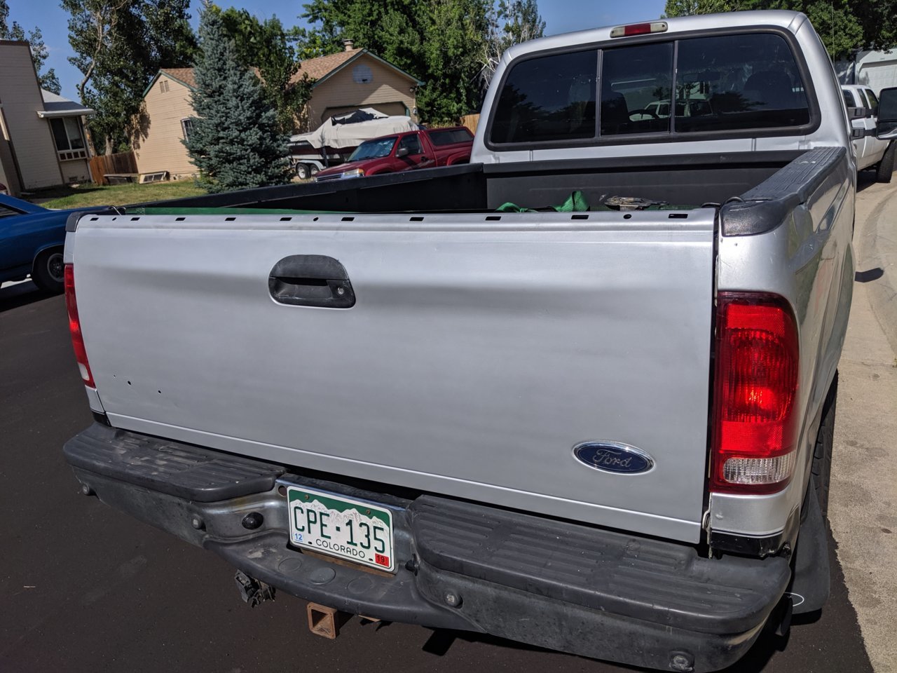

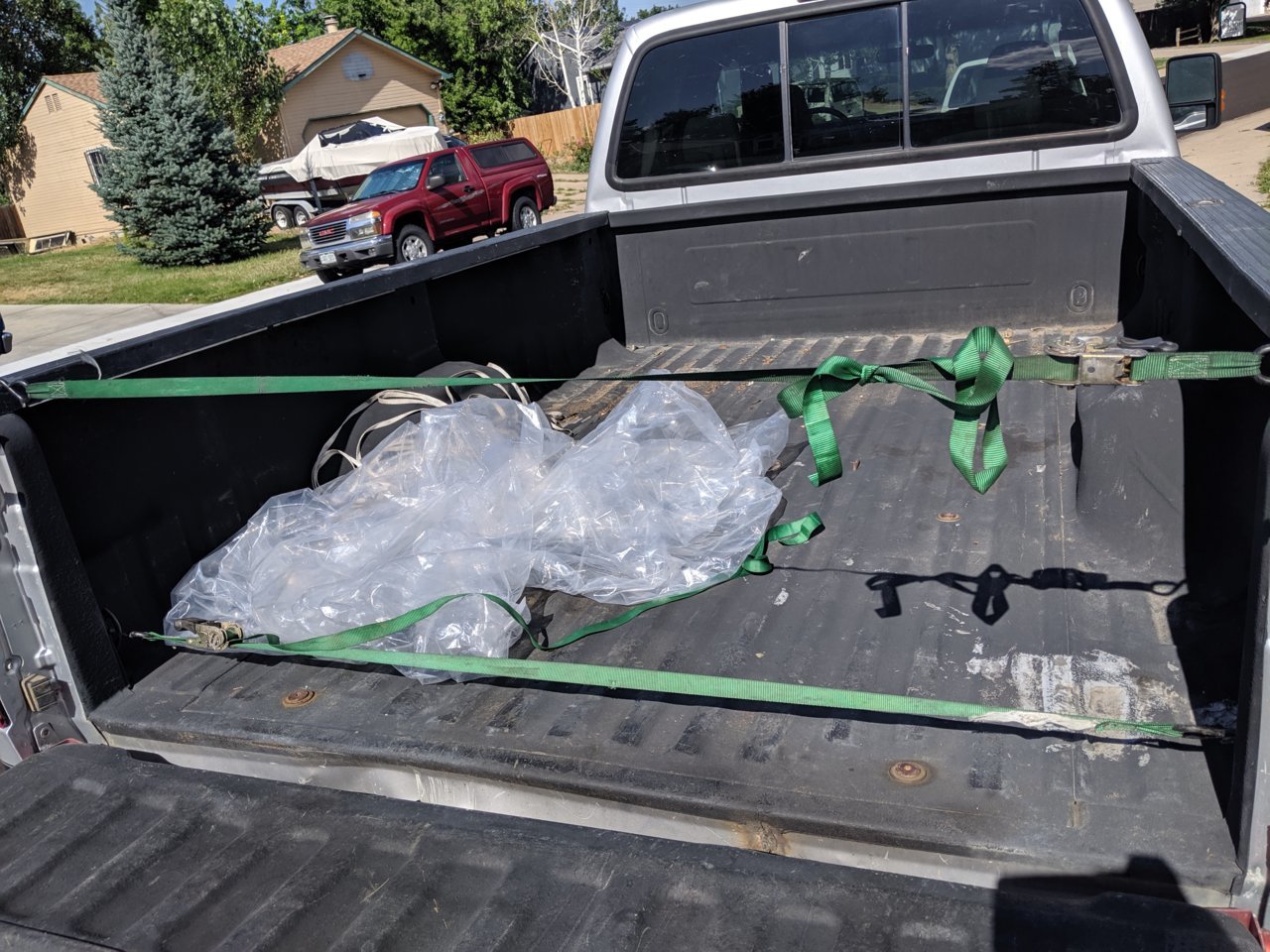

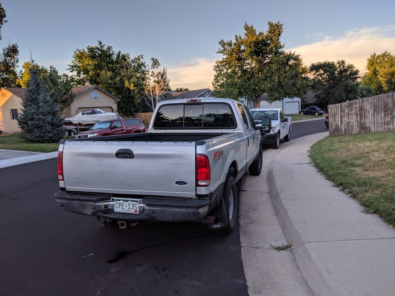

    Got my "new" tailgate on. Hoped I could get a better finish with plain old "aluminum" Rust-Oleum but with 7 coats, lots of wet sanding with 800,1500,2000 grit I still ended up with some streaks, even after cutting and polishing. It doesn't look so great but it is way better than denty. I'm going to cover it in some vinyl graphics to hide the paint if I can manage to get around to it.
    (Forgive the parking job, my friend parked it like that after borrowing it to move :bananadead:)

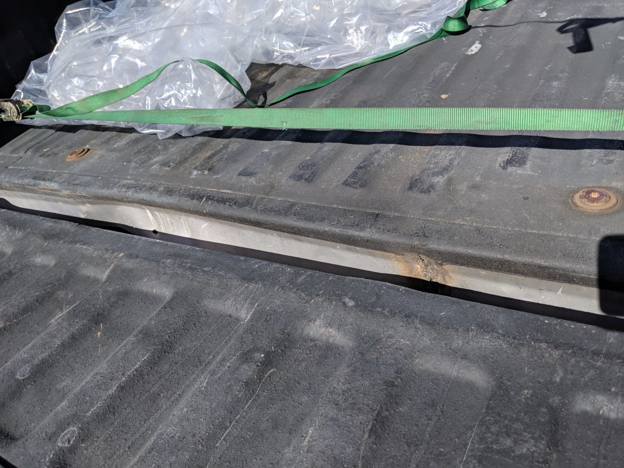

    The bed had been repaired after a previous accident but those welds broke when the trailer hit. The gate would shut because the pass side quarter of the bed was pulled out about an inch.
    Til I can reinforce and reweld it I pulled the bedsides in with ratchet straps. Gate closed nicely and the gap isn't perfect but it's way less hideous.

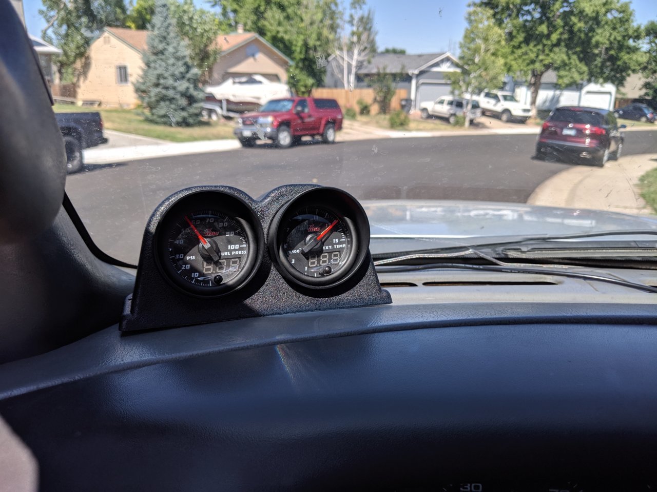

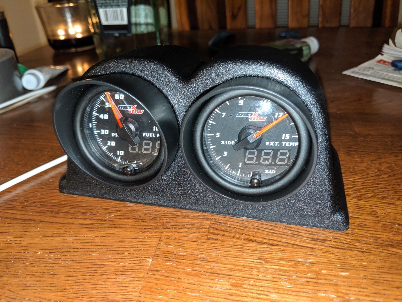

    Before I put a heavy trailer behind the truck I've been wanting to add fuel pressure and pyrometer gauges. Glowshift is the cheapest option but I felt like they'd do the job well enough.
    The other night I combined the harnesses for the 2 gauges I'm installing so I only have to hook up one power, ground, illumination, ignition wire.
    Today I put in a sender for the fuel pressure gauge and the pyro into the exhaust manifold and ran the wires for both through the firewall and up to the top of the dash.
    I still need to wire up the gauges but I burned through all my project energy for the weekend.
