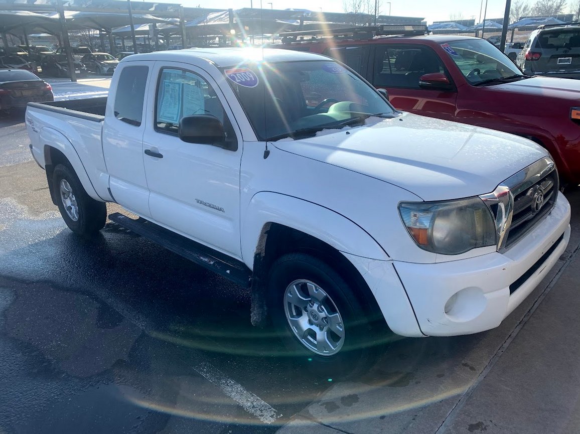

    Early 2021, I found and bought the truck the day they released it on the lot and before pictures were taken, thanks to the conditions in early 2021... the blank canvas.

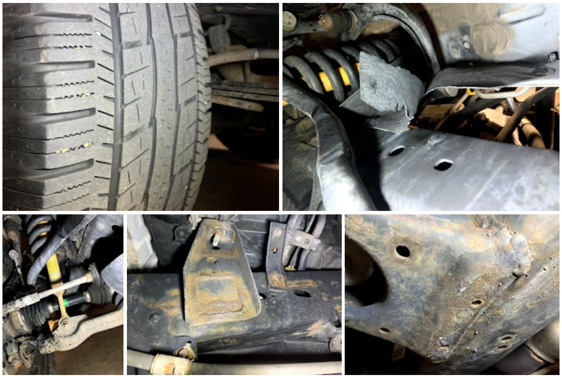

    It had plenty of little problems.

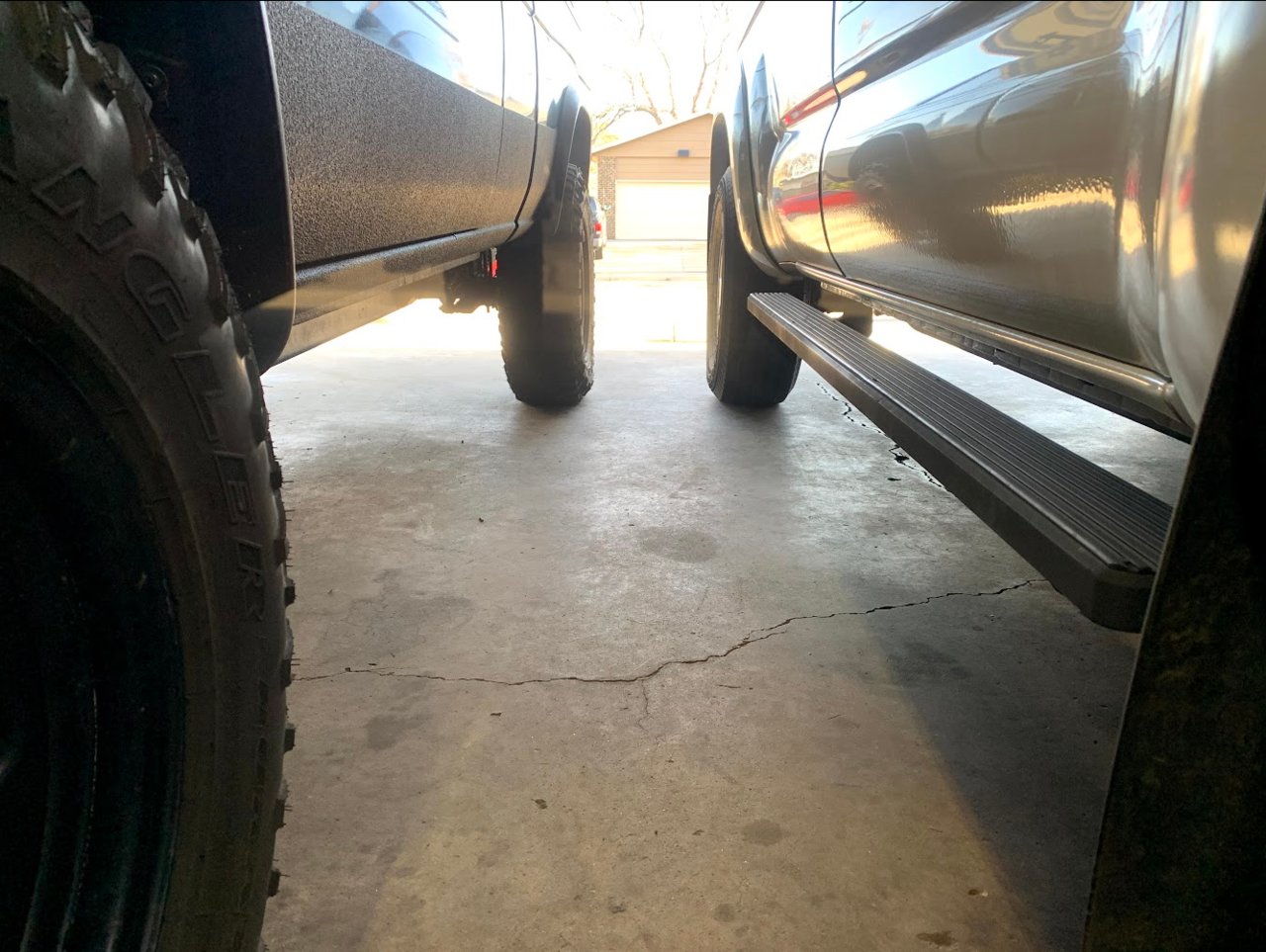

    Trucks have changed since the '90s, given how low the Tacoma is next to my stock-height '95 Nissan D21 Hardbody with stock-sized tires ...

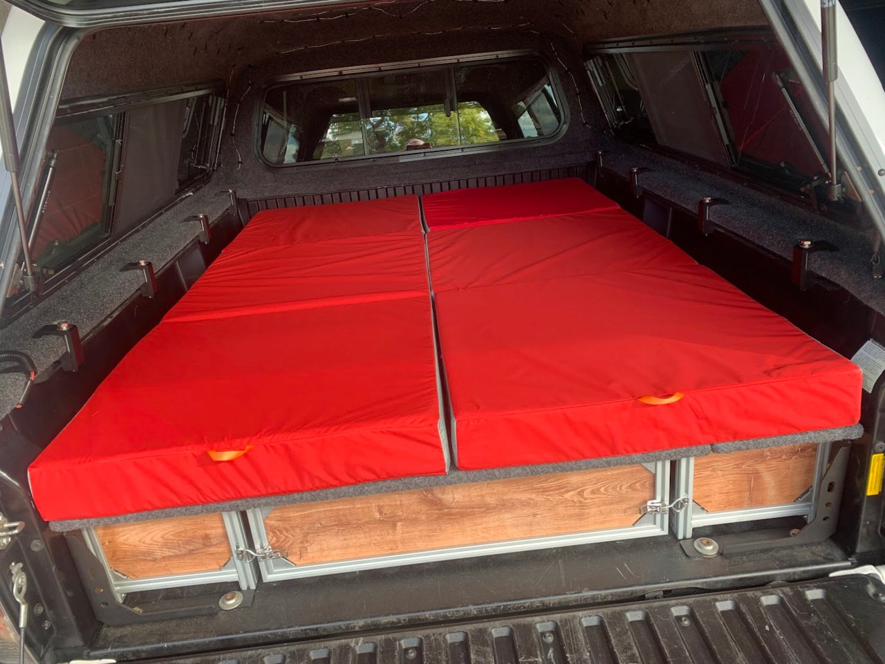

    I designed and build a custom deck / false bottom / organization system for it (added weight first, then built suspension to size / weight).
    Then, I made some home-made camp pads for the deck.

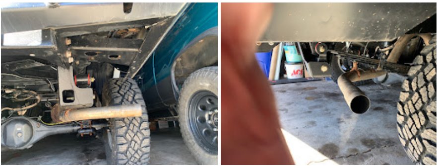

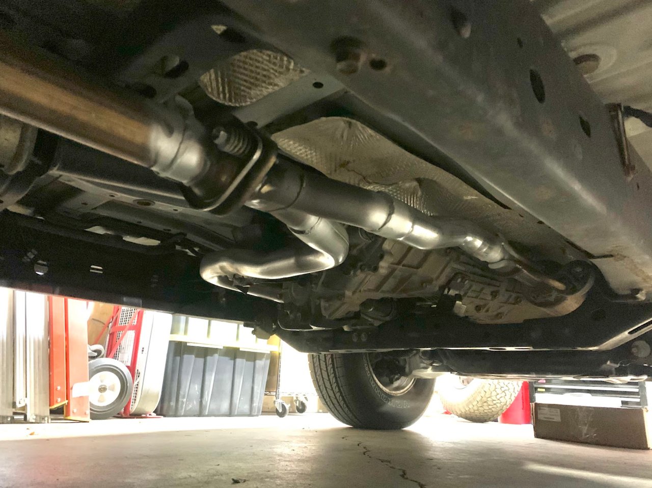

    For less cowbell, I had the exhaust cross-over rerouted by a local exhaust shop.

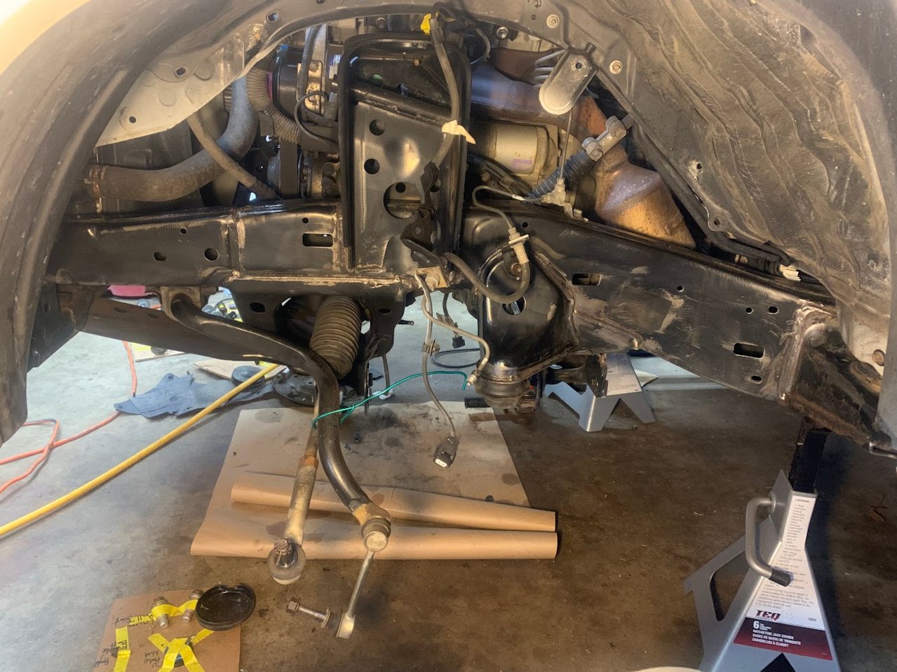

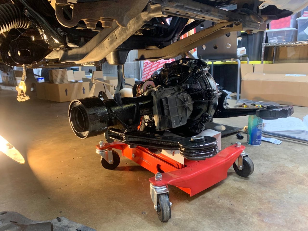

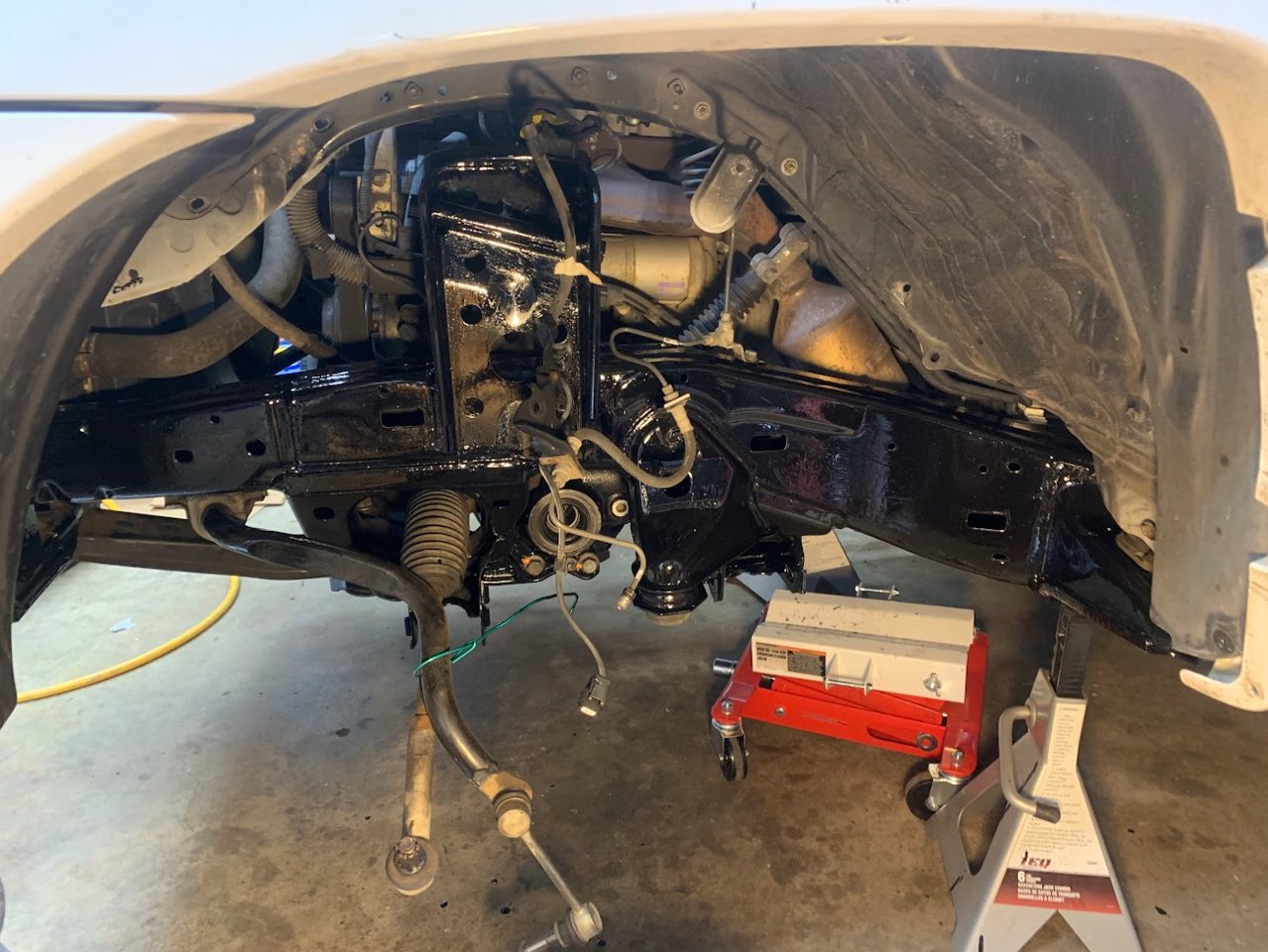

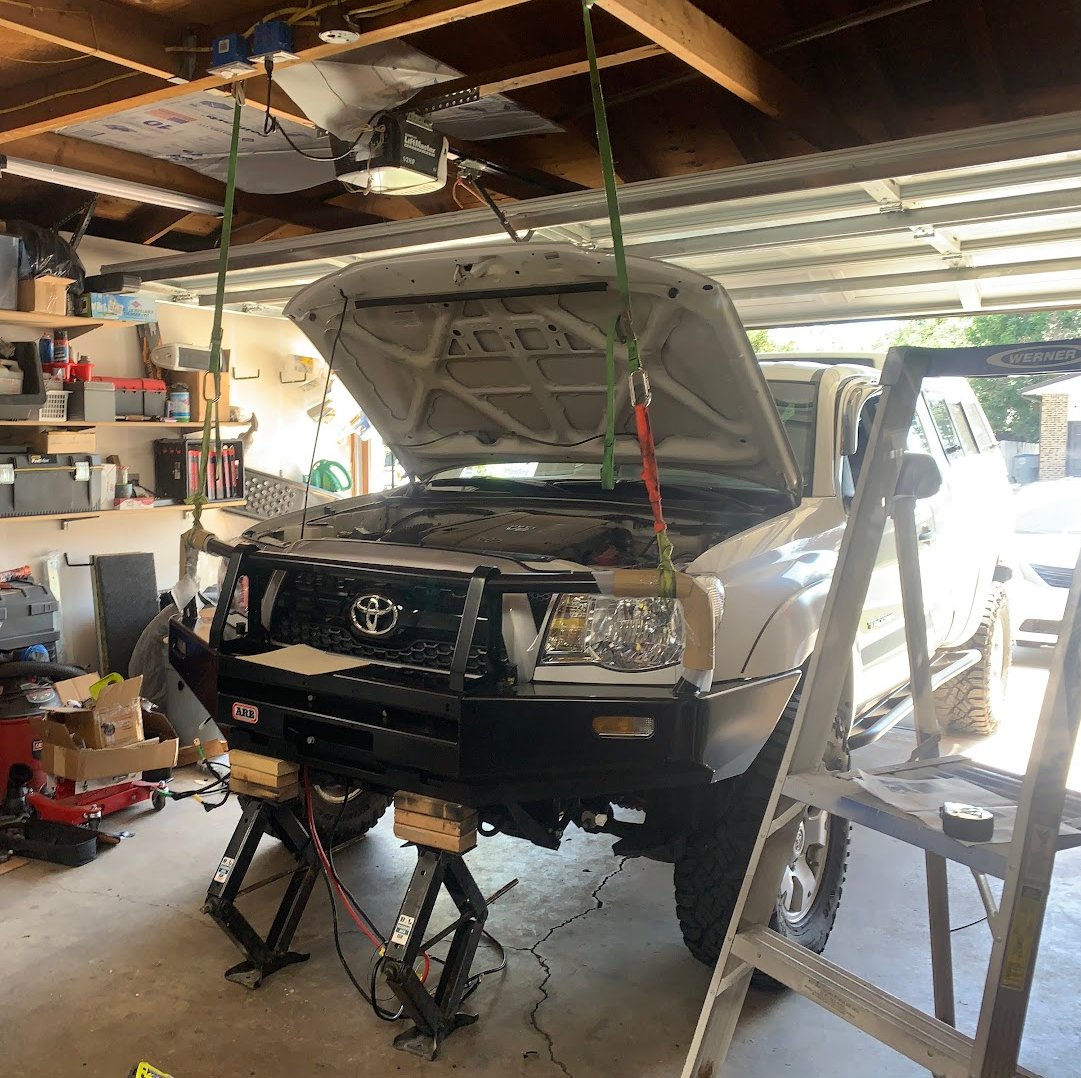

    Then, I put it up on jacks for two months and gutted the entire suspension and final drive.

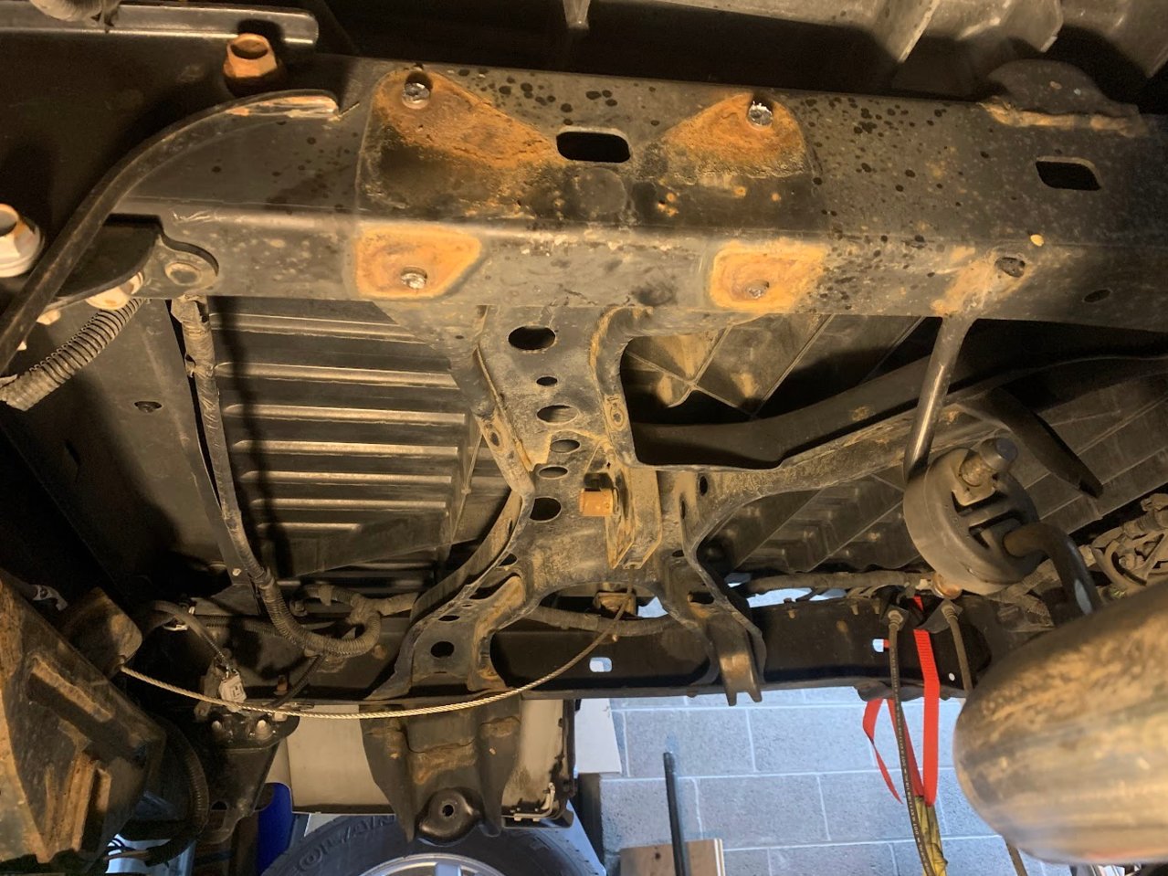

    I scuffed it all up to prep for the refinish...
    And thanks to ECGS, I refreshed the diffs with seals, gaskets, 4.30 gears, the famous ECGS clamshell bushing, and I repainted it, too...
    Fresh paint.

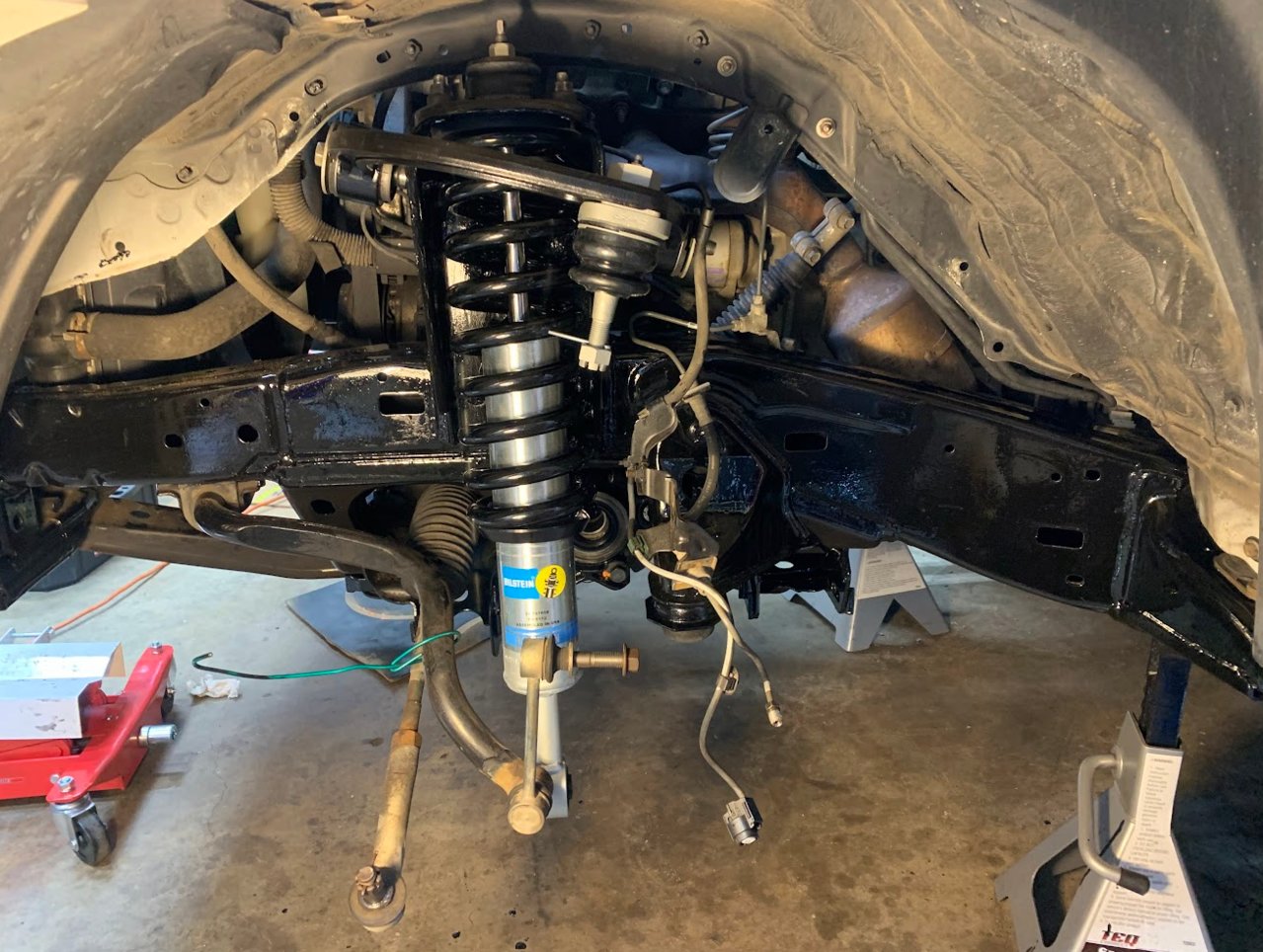

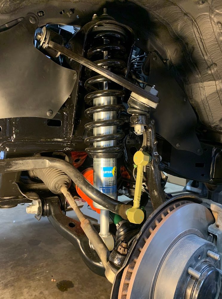

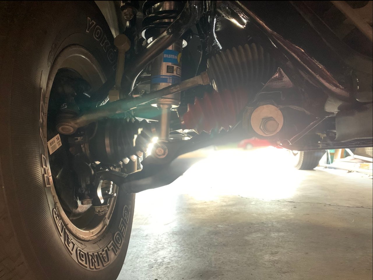

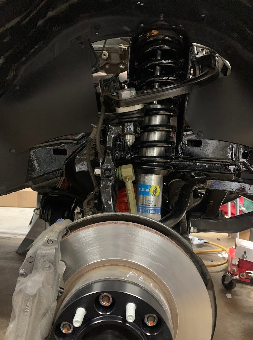

    And the rebuild begins (SPC UCA, Bilstein 6112 + B12 springs shown).

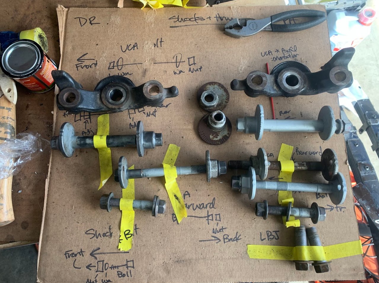

    I bolt-map everything, and torque everything to factory or part MFR spec (always).
    I cut off the cursed leaf spring hangers with a cutoff wheel and an air-hammer.
    Finished the front refresh/rebuild!

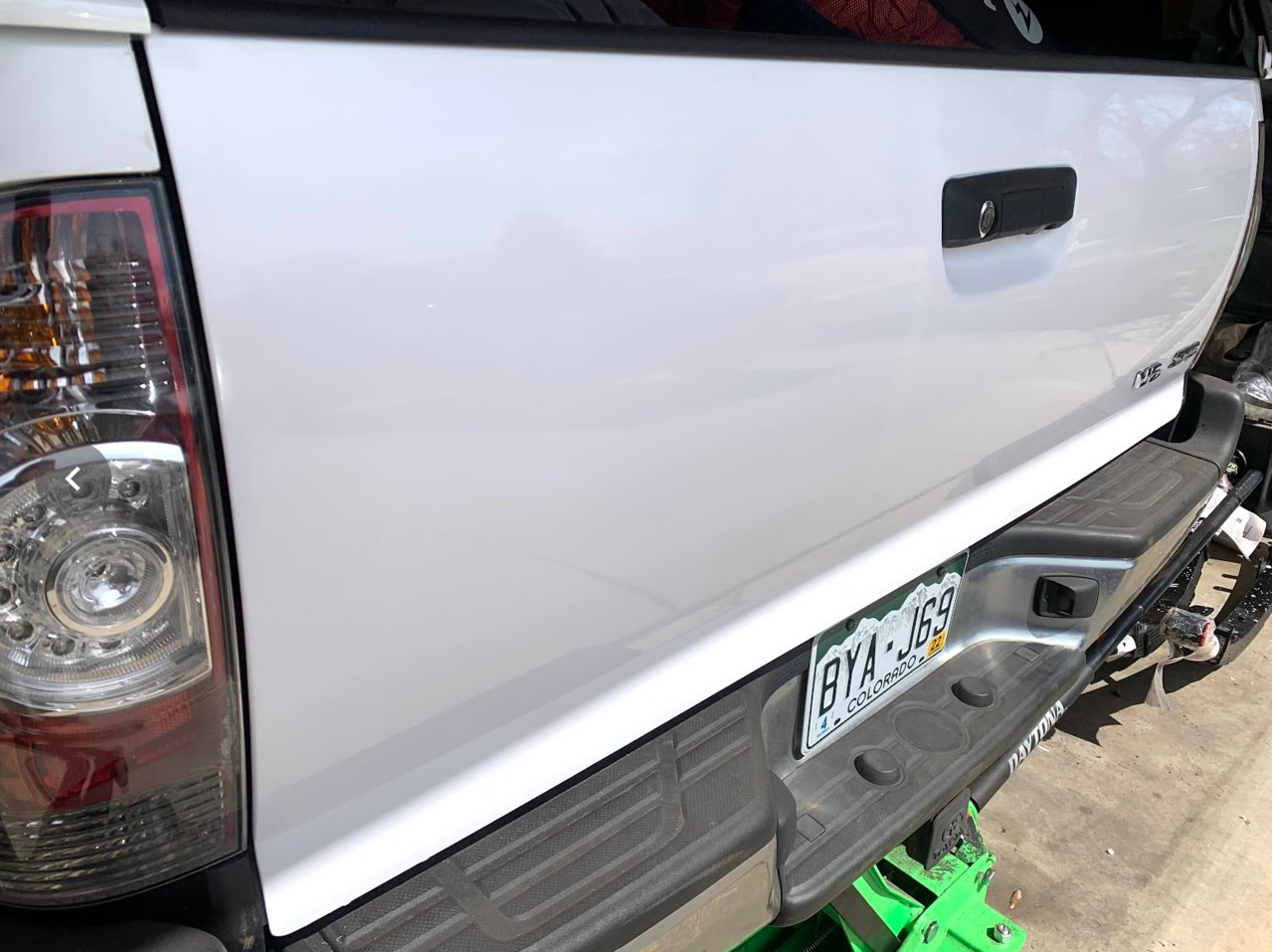

    Repainted the tailgate with PPG paint and [partially] re-badged it for that stock-ish look.

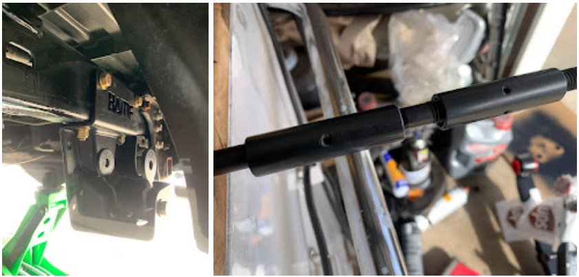

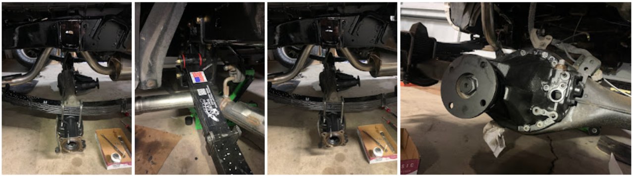

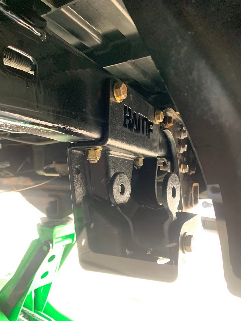

    Added BAMF rear-hangers after the refinished, and modified the shackle bushings to deliver grease to the new poly bushings via the grease-ported bolts (sprayed with moly paint for a lil extra):

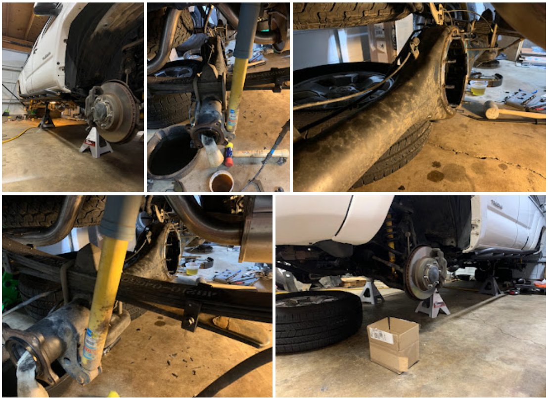

    New Alcan springs in, rear third member in, ready for next steps.

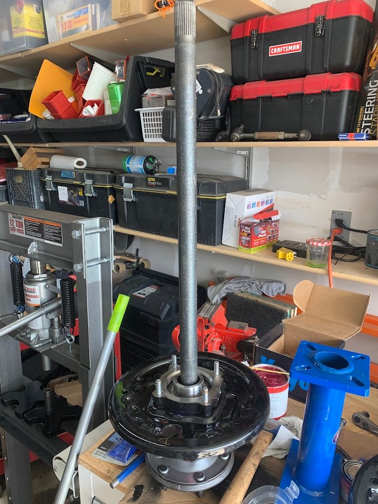

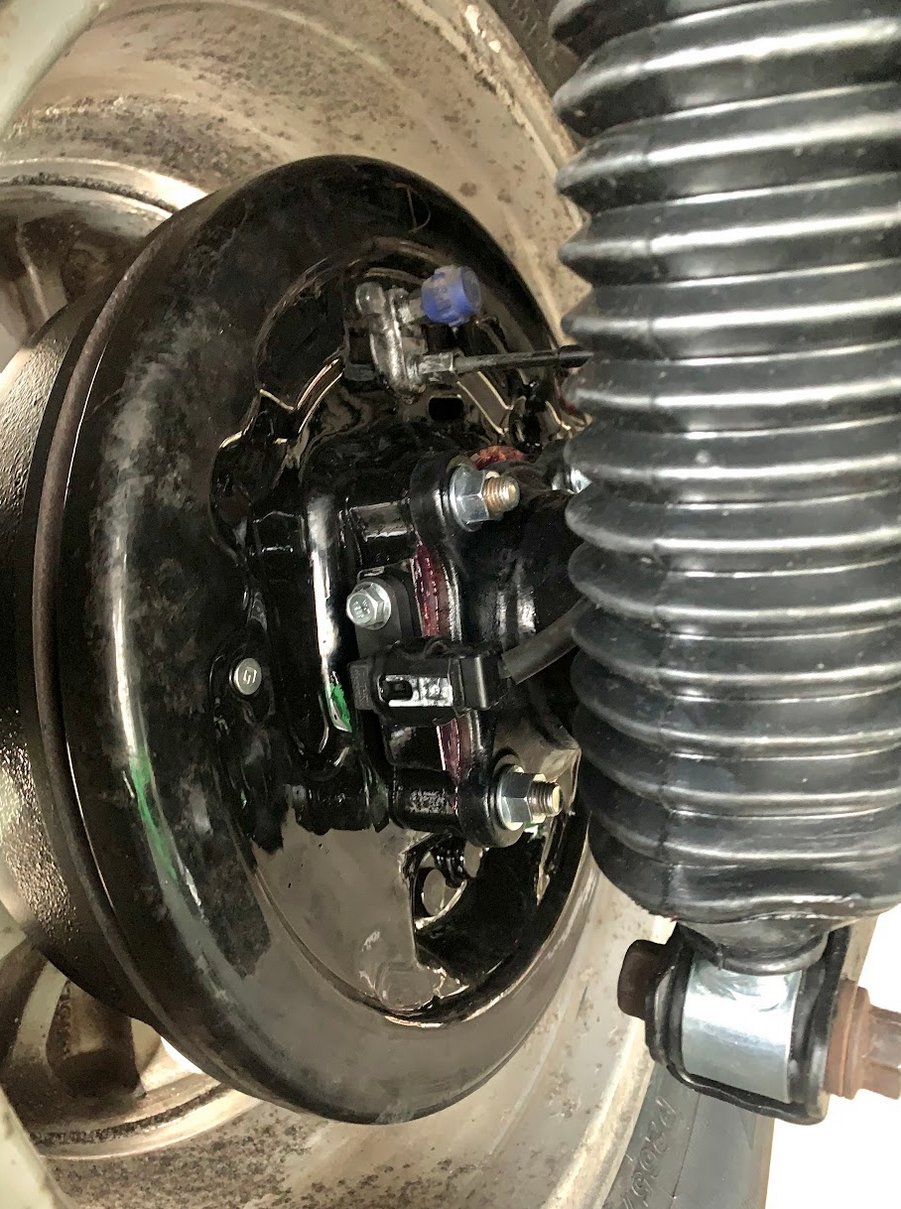

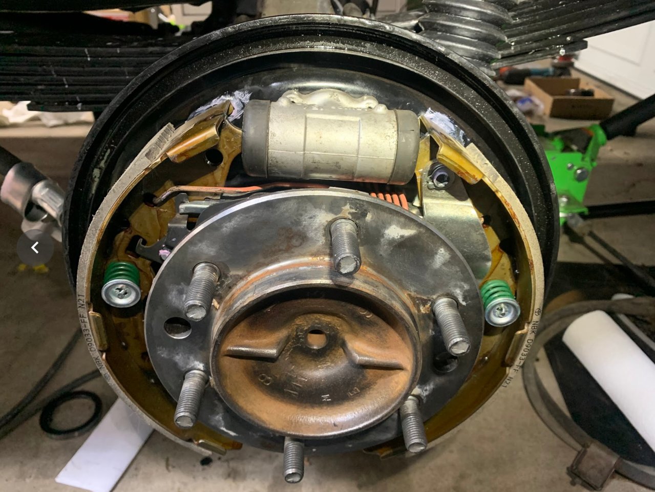

    Fully rebuilt the rear axle assemblies, including new Koyo bearings. (Awful job even with a press and job-specific tools, btw.)
    Full refresh of the rear drums, including turned and re-painted drums.

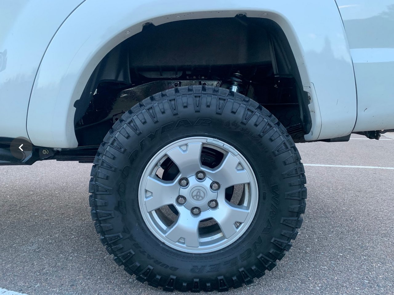

    New shoes added! They're not fancy, but they're available everywhere in this size in case a replacement is needed.

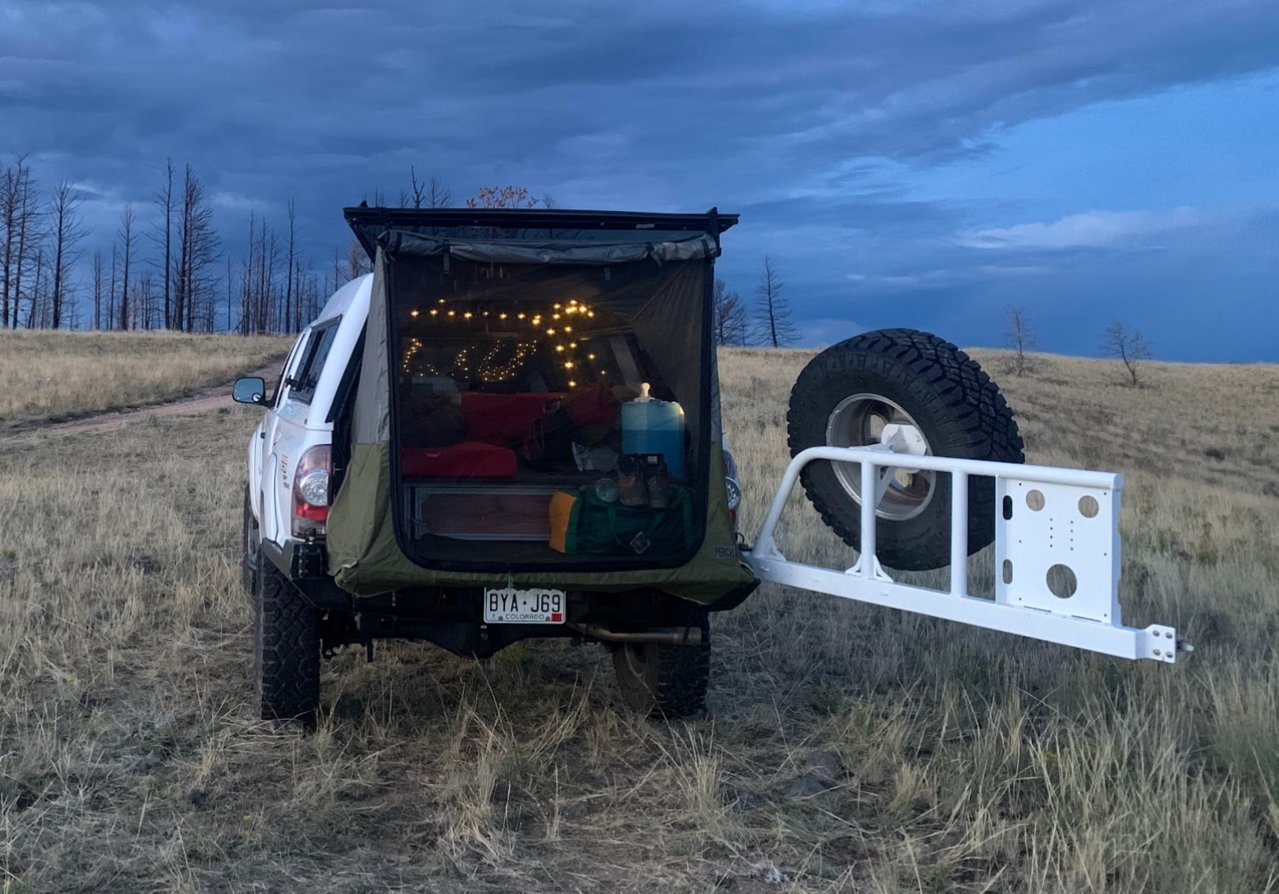

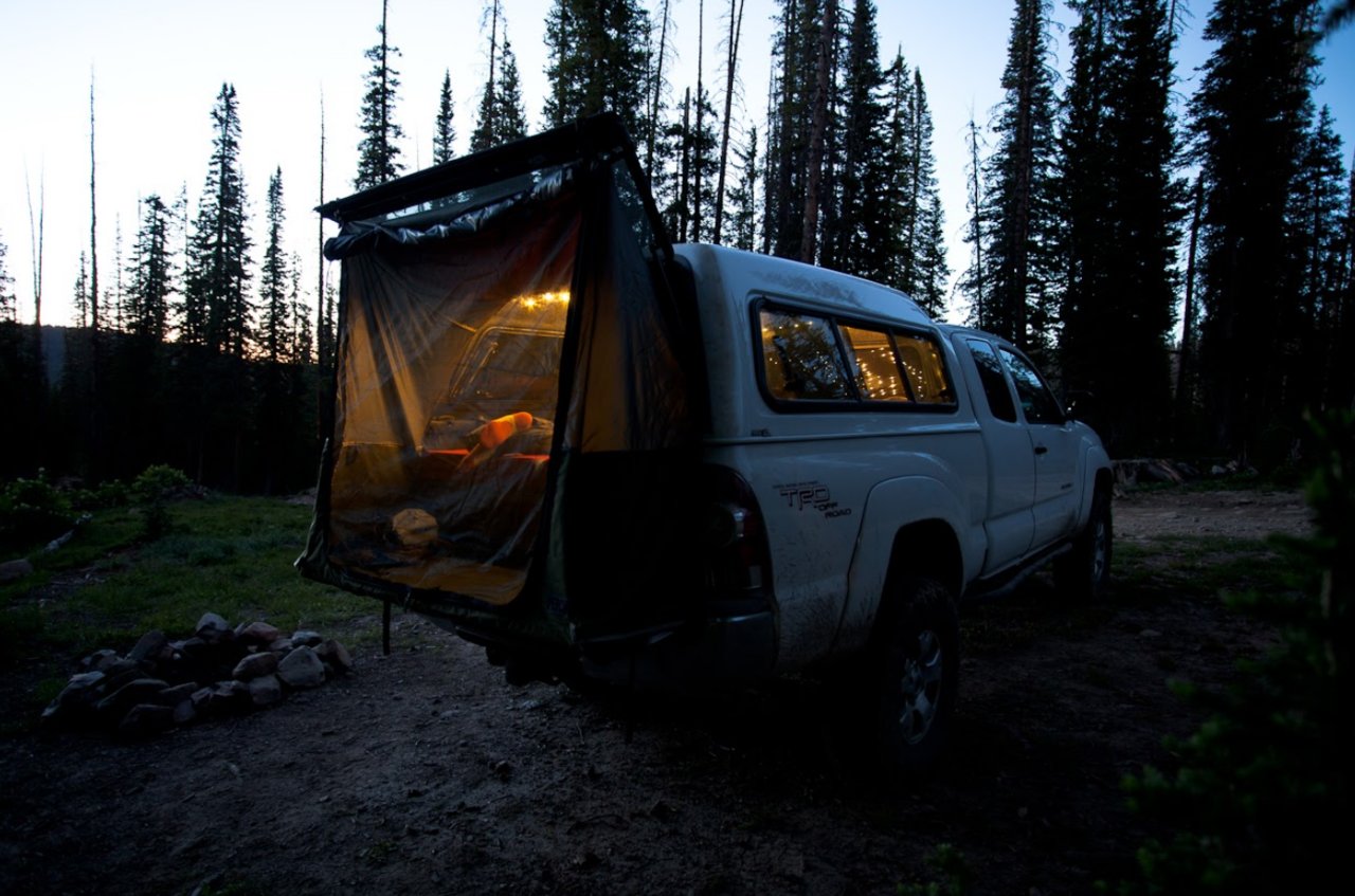

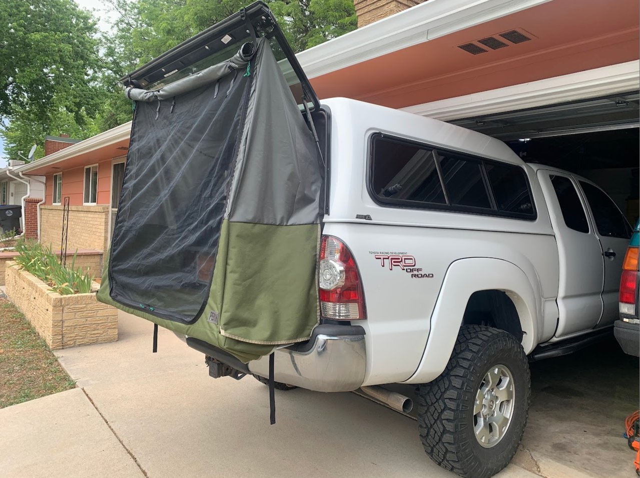

    Tent system prototype complete, concept proven, patent pending!
    And now I'm working to get this tent into production for Tacomas, and eventually other trucks. Can follow on Instagram if you're interested: https://www.instagram.com/perch_equipment/

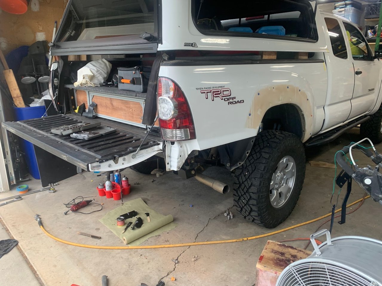

    Cut off the booty to clean up that exit angle and protect the body from inevitable trail damage...

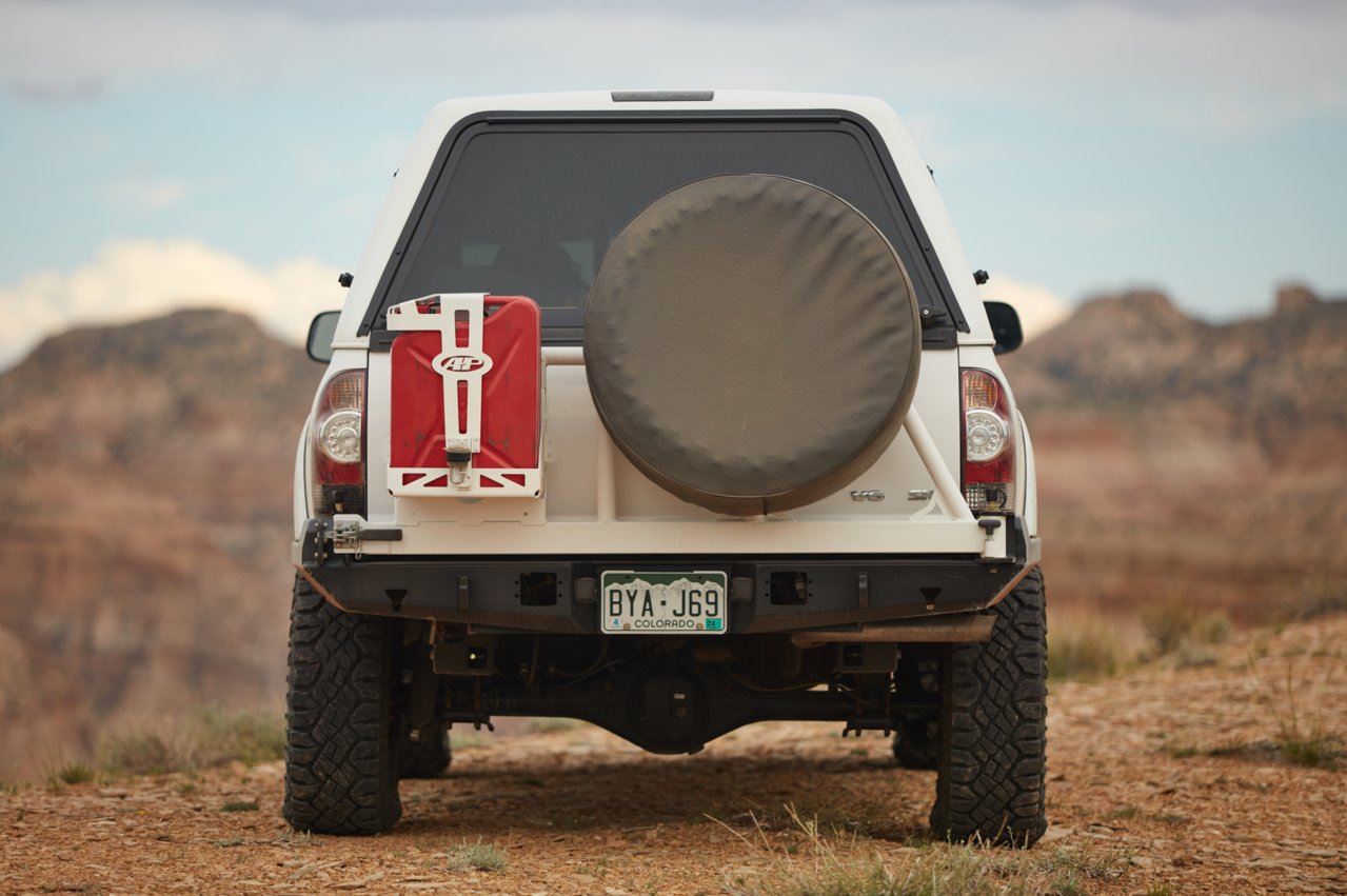

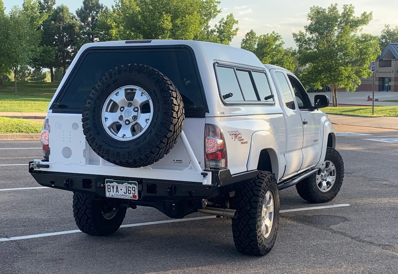

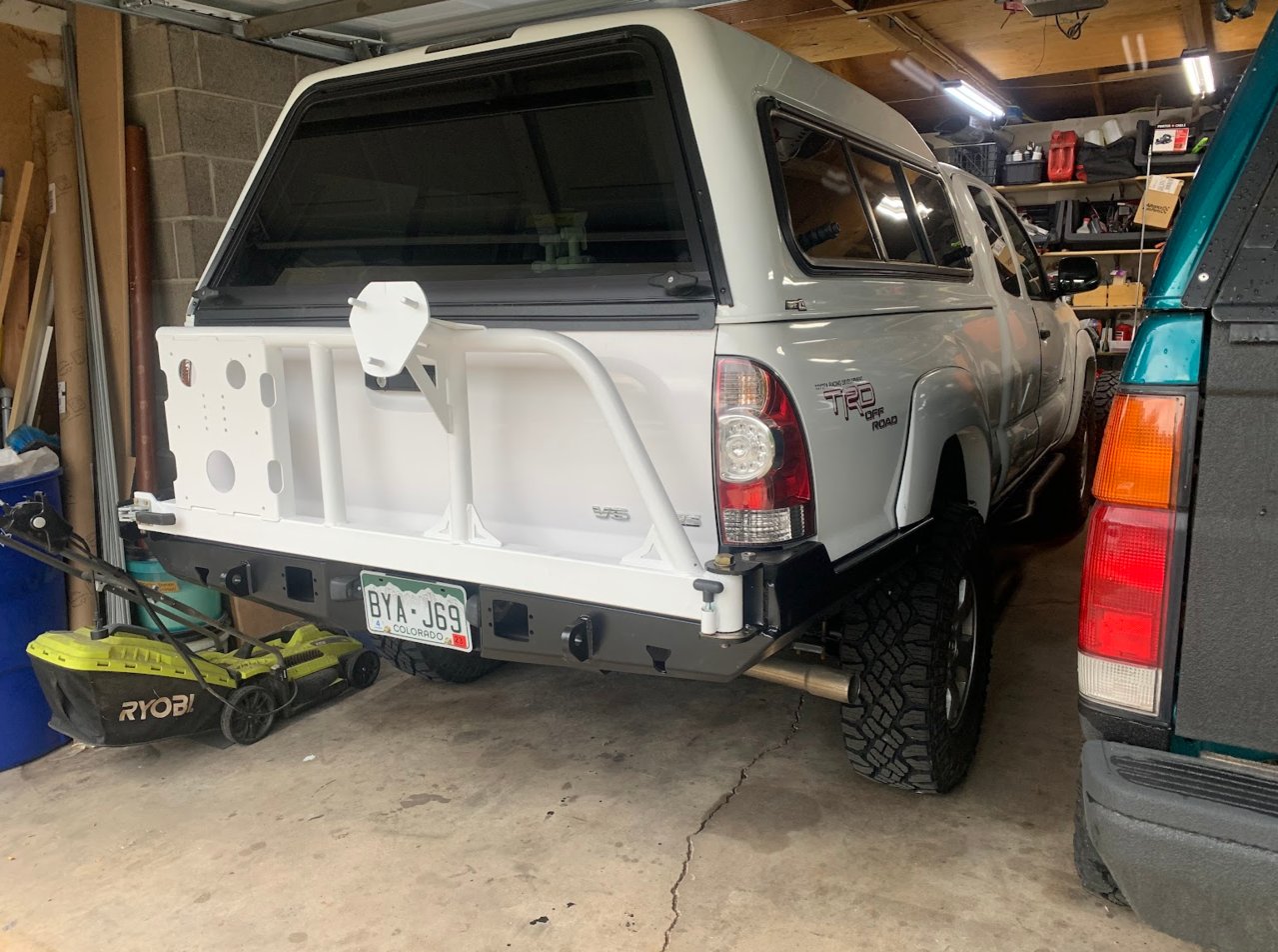

    Home painted the ATH Fab high clearance rear bumper and skateboard decked it.
    Color-matched the ATH Fab rear swing to keep it looking stealthy. This thing ROCKS, thanks Morgan!
    Shakedown run 2! Now with swing arm...

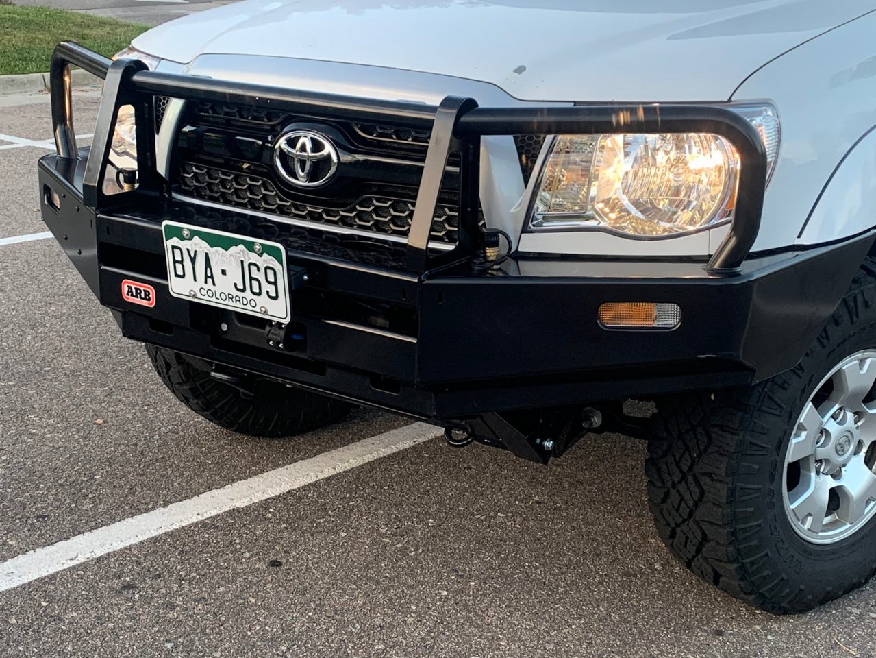

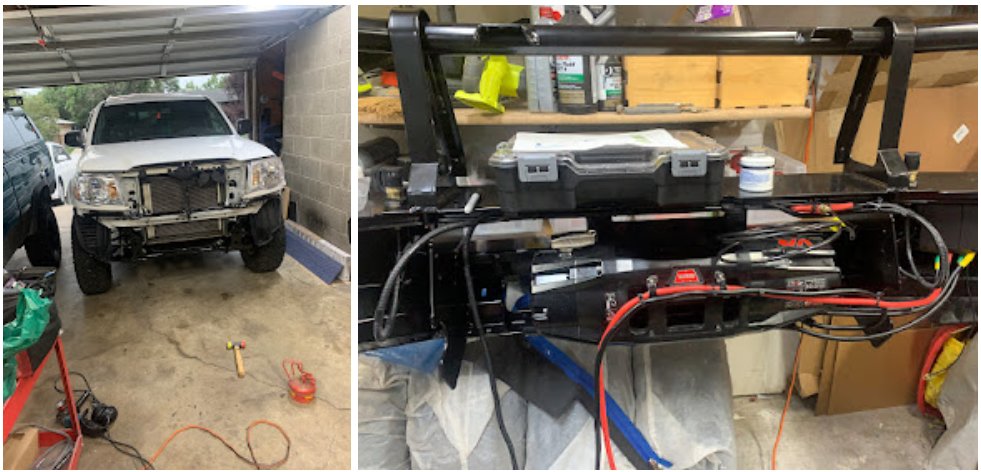

    And now for the front with the ARB Deluxe bull bar, including a custom rewire job of the winch control box, plugs, and power leads to make it all stealthy and only receiving power when I want it to ...

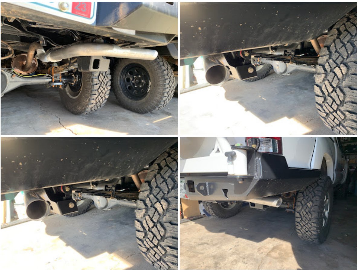

    Final exhaust reroute before and after. (Less cowbell.) Before...
    After...

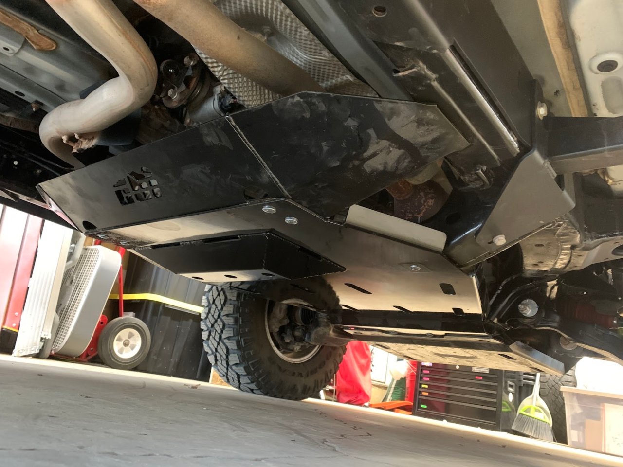

    Happened way back in the earlier part of the project, but here are the CBI front and mid-body skids (sprayed at home):

      • ~1.5-2.0 inch lift with Bilstein 6112 + B12 spring struts up front
      • Bilstein 5160 shocks in rear with Alcan springs with +750 Lbs capacity, and replaced OEM leaf spring hangers with BAMF hangers
      • Replaced UCAs with SPCs, and replaced LBJs with Mevotech TTXs
      • Replaced swaybar endlinks with Mevotech TTXs, as well, and replaced swaybar bushings and brackets with Energy Suspension urethane + greasable brackets (yep, keeping sway bar)

      • Tires changed to 265/75R16 (31.6”), Goodyear Wrangler Duratracs (123Q-E1 rated)
      • ARB Deluxe bumper in front with Warn VR8S Evo winch
      • High clearance rear bumper with swing arm by ATH Fabrication, home painted with black on bottom, Toyota color-matched Super White II on top

      • Front and mid-body skids by CBI Off-Road in steel, painted black
      • Refinished chassis with blood, sweat, tears, and POR-15 paint

      • Rerouted the [heinous] exhaust crossover and the rear tailpipe to fit the high-clearance rear

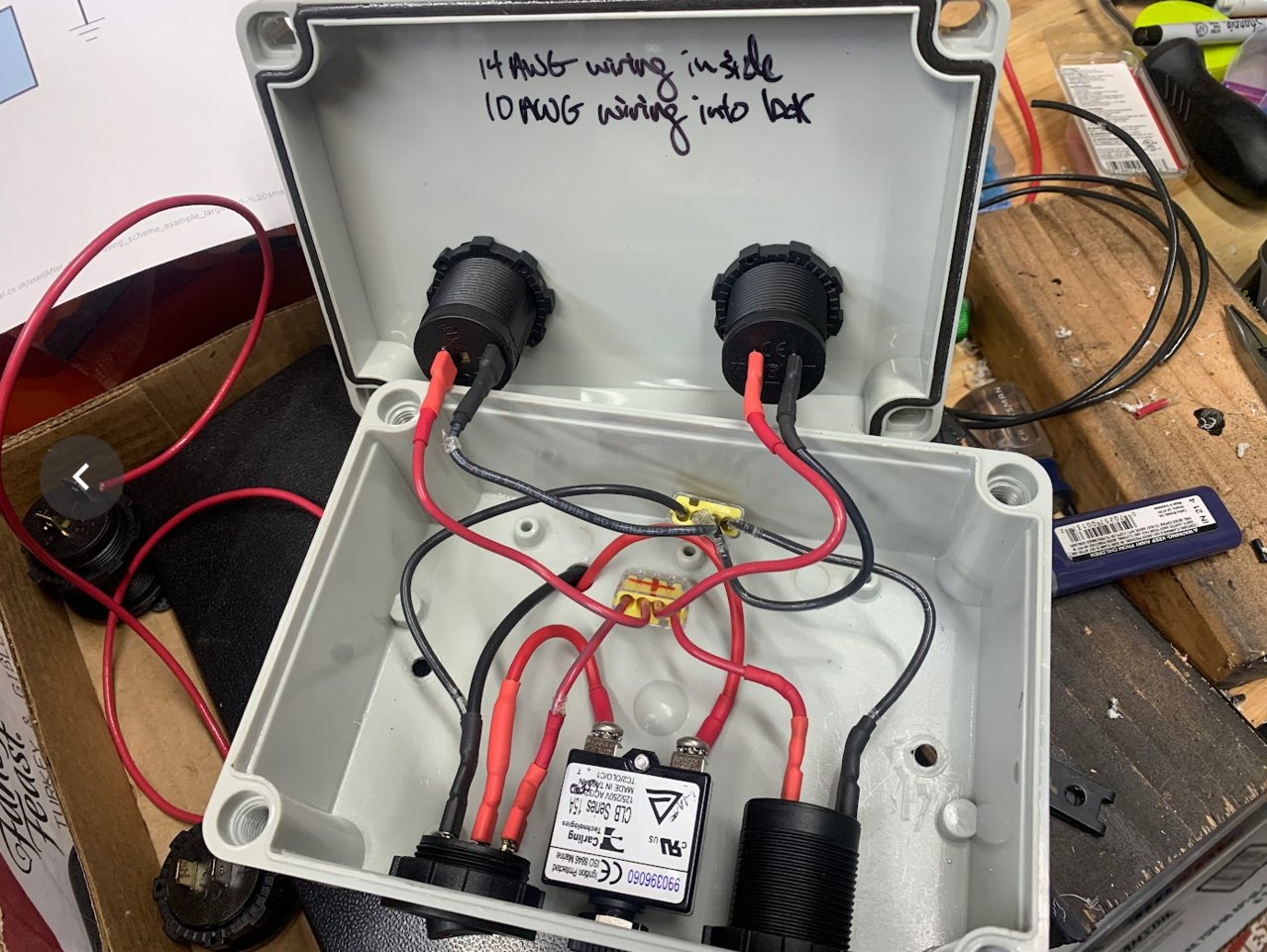

      • Removed stock subwoofer and custom-made an electrical box that allows for USB and car plug charging from the connection point in the rear – and connected a Dometic CFX3 25L refrigerator to that
