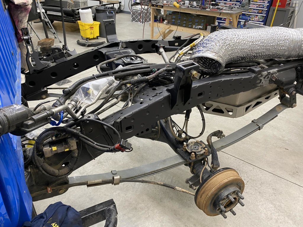

    I run 44 gallons with an aux tank where the spare tire used to be and it's been a game changer for long trips offroad. (on highways I just keep it mostly empty)
    You never know on long stretches if there's an obstacle that forces you to turn around, which if I'm crawling in low range, I get 5-8mpg so having the peace of mind to make sure I won't run out is worth the extra weight. Plus my furnace runs on gasoline straight from this tank so no need for additional fuel cans and finding a safe place to store it.
    415289284_10118132505894653_797082052638_f0bbb55be6e3875c6a94591a0b9333c88936deee.jpg
