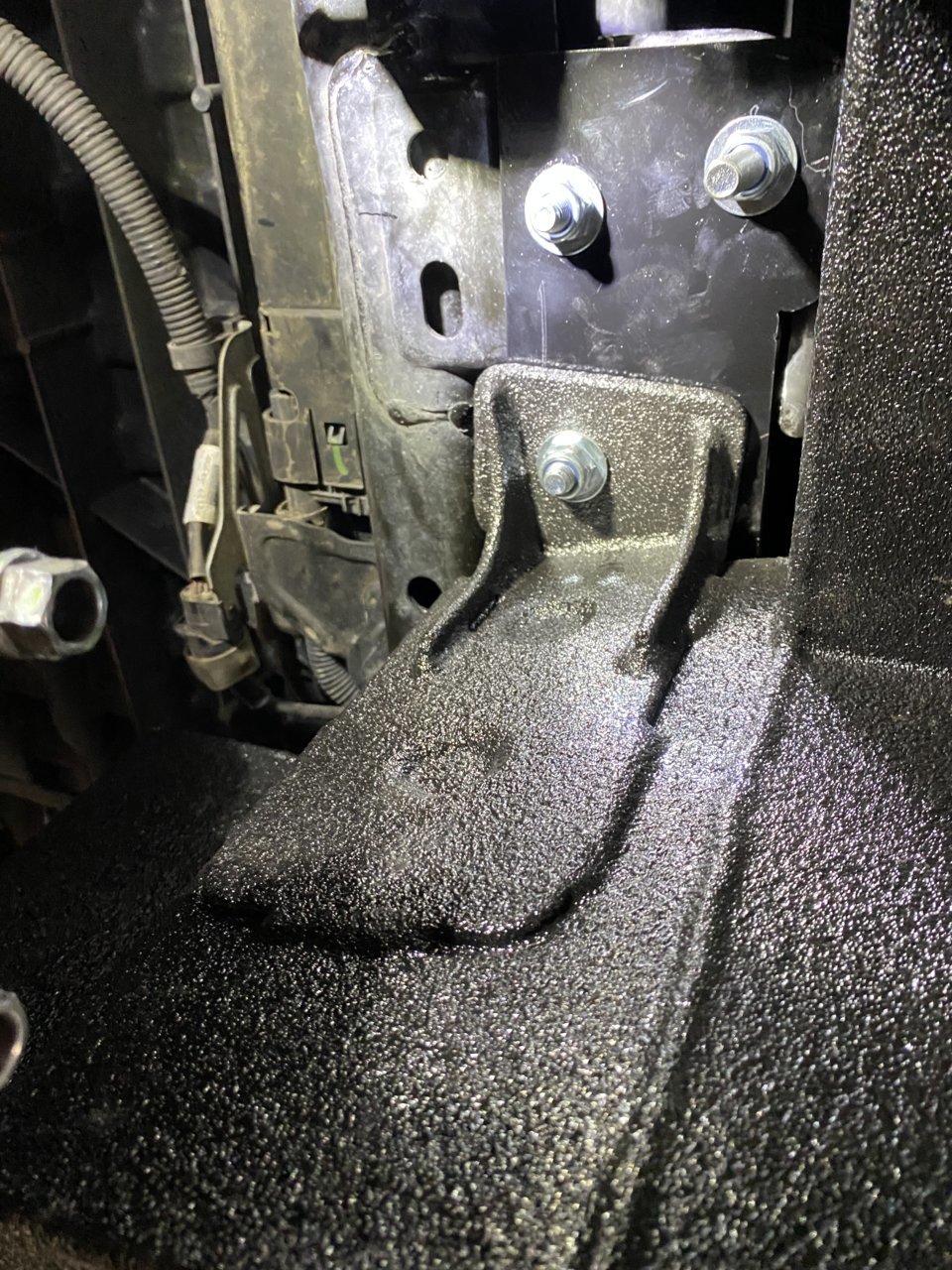

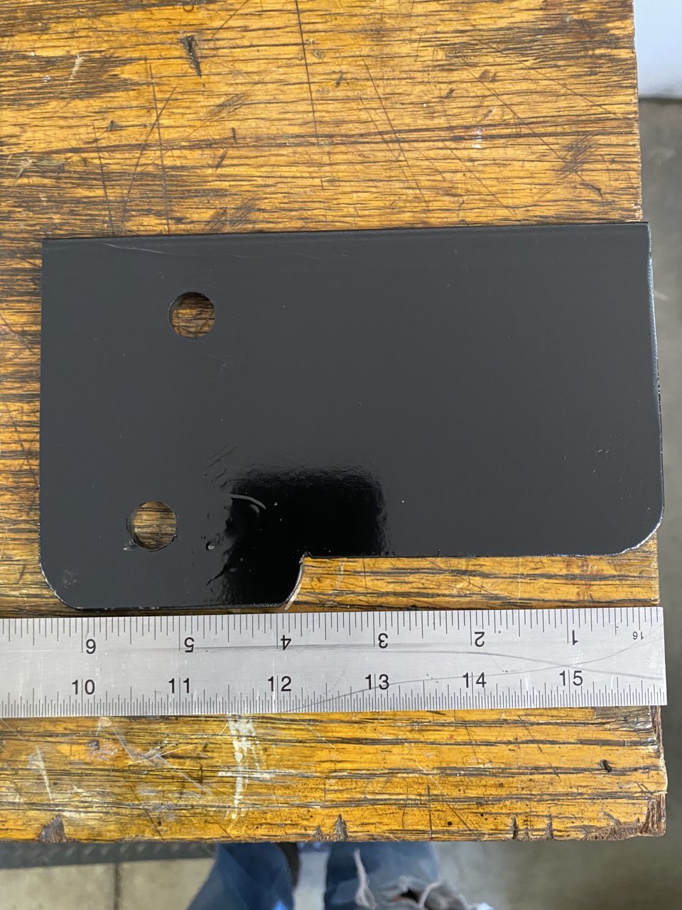

    I managed to get my Long Range America fuel tank in my taco this weekend. It was a pain given the brackets provided by them were nothing close to what I needed from the importer but after a little fitting and one home grown bracket we're back in business. The tank is a durable unit and I look forward to less fill-ups on trips. Here's some photos of the bracket I had to fab up for the rear passenger side mount of the tank. The two mounting tabs on the drivers side mated up with the OEM mount and the fourth on the front passenger side required me to drill a hole in my crossmember for a bolt. Have fun if you get one of these tanks. The guys I purchased it from were at a loss on the brackets but it wound up being a clean install once I committed to fab my own. Good luck.
