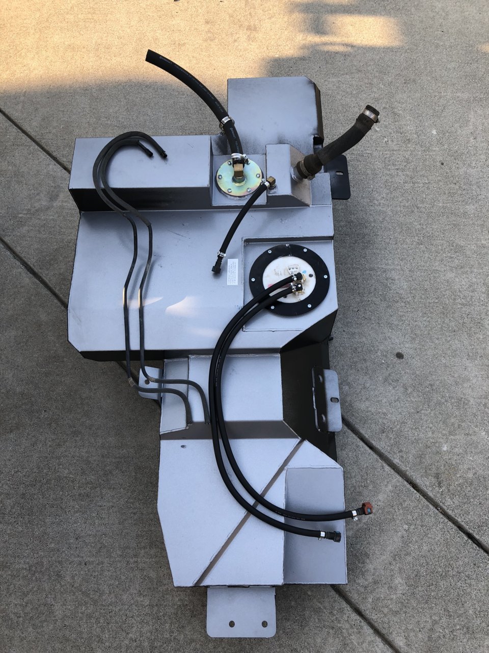

    I like clean air to breathe. I want clean air for my daughter to breathe.
    With that said, I installed my tank. I’m happy with it. I have no burping issues as others have had in the past.

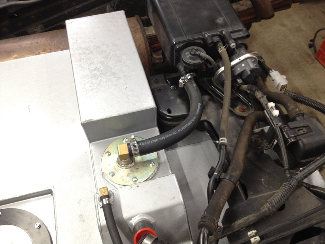

    I didn’t pull my bed for the install(have vagabond Drifter plus too many other stuffs) and I could immediately tell the charcoal canister line supplied was far too long. It was trimmed many times to find the correct length.
    This tank install is not for the impatient.

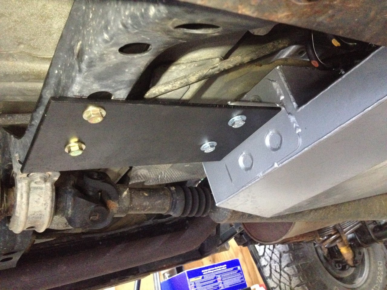

    Much less than expected, it was just extending the front mount to the crossmember which is further forward on the DCLB vs the DCSB. I provided all my measurements and pictures to Cruiser Brothers and I believe they'll be supporting the DCLB going forward with a bracket similar to what I made.

    Btw, I’m surprised you just went straight hose clamp instead of cutting out the factory fittings from the lines and inserting them into the new hoses supplied. I think I’ve got a pic of what I did. I know it’s seems unnecessary to some, but I like the security of the factory fittings clipping into their intended hoses. In the pic I uploaded it doesn’t show the charcoal canister line with its fitting terminated because I was still in process of finding the correct length.C1882301-D3AB-489E-8DA5-C5D1CF4D17FD.jpg
