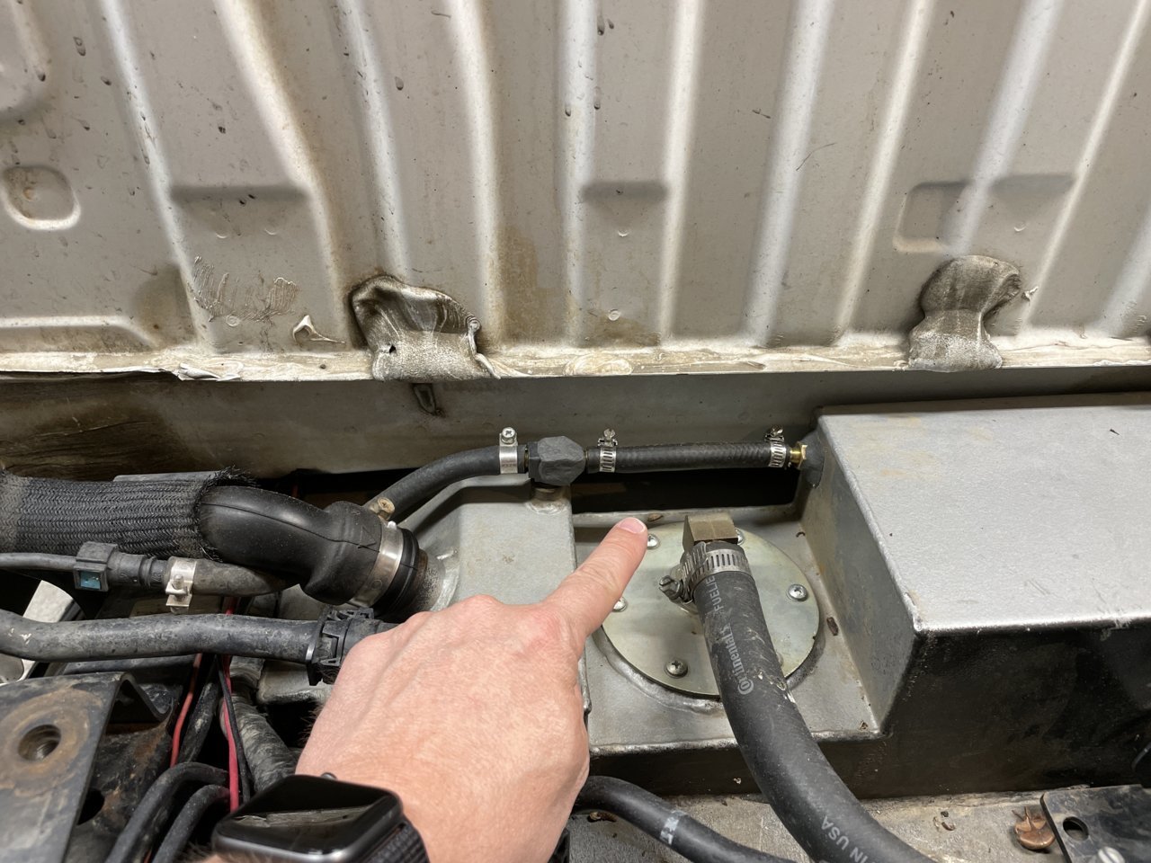

    Maybe you'll have better luck than me but I think the burp fix was a check valve at the filler neck connection. I put it in last year and still have pretty regular issues (about 50/50) with the pump not stopping if I step away from it on fill ups. Anymore I just go by what the scangauge says I've burned then go by ear as to when it's truly topped off. I think it's a matter of time before the evap throws a code but like you, the truck hasn't been out much with the rona

    Try this——>

    And to further explain:
    I had the anti siphon drain flap replaced by the fellas over at Valley Hybrids as well as the check valve. That didn’t alleviate my burping issue. I noticed that when I filled up at stations that had a larger “crown” to their fill stations, I had less issues with burping. I believe is a pressure issue that builds in the highest point of the tank. The vent tube should be venting the highest point(highest pressure) of the tank. Haven’t had an issue since I modified the vent plumbing.
    HomerTaco likes this.

    Innovative. Makes sense. I assume that's JB Weld?

    You are correct sir. Someday I’ll source the correct fitting. But for now, it works just fine.
