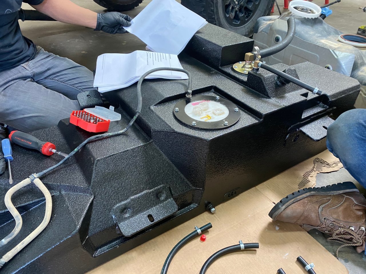

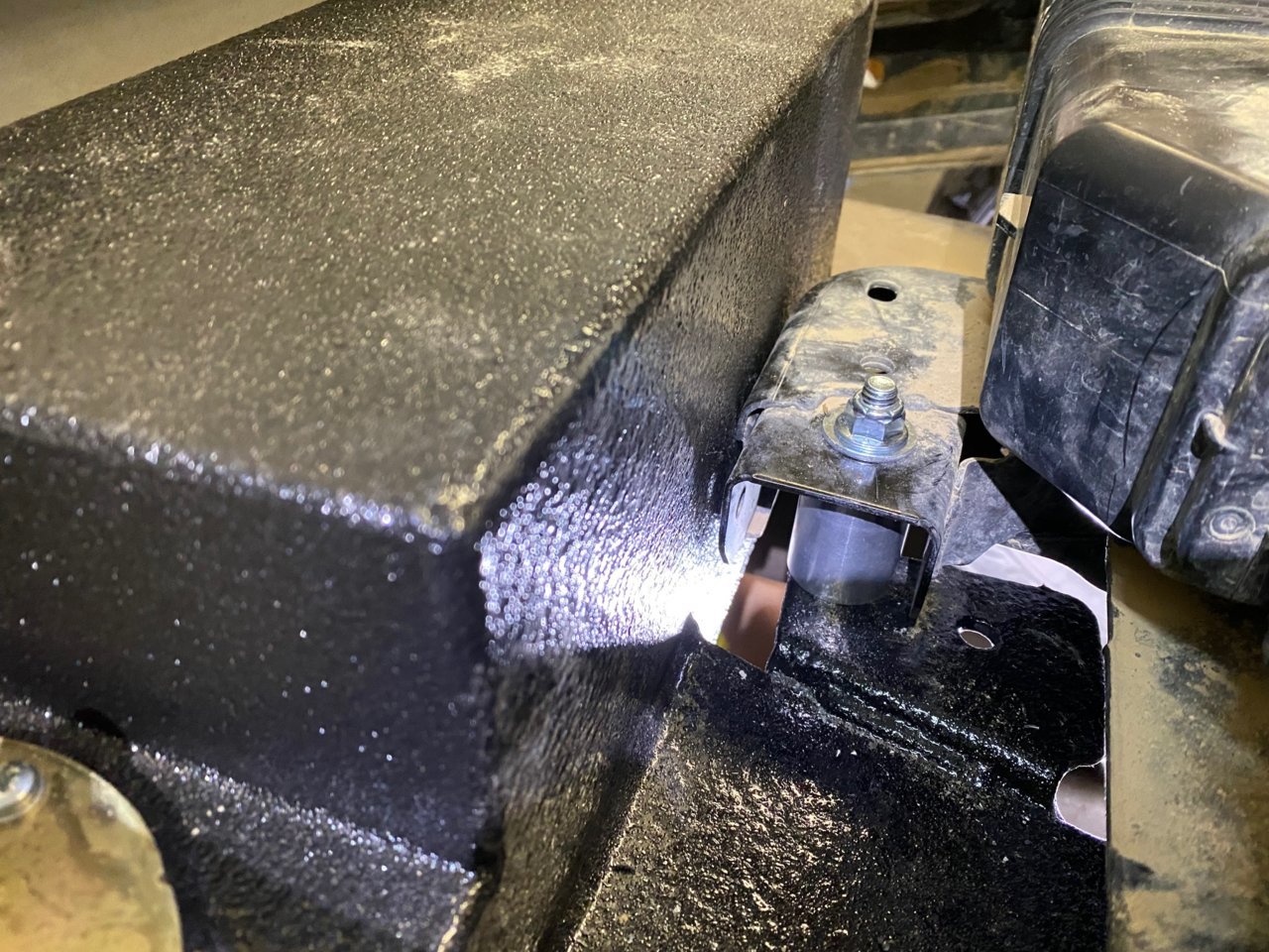

    This past weekend, myself and two buddies installed my LRA fuel tank on one (semi long) Saturday. So far, so good, no issues at all and no burping on the first fill (still on first tank and I'm at 410 miles). Tank took 32.8 gallons on the first fill (5 gal jerry, then went to the gas station and put in another 27.8 gal). LRA sent a new bracket spacer kit out to us last minute (with instructions), that was a big help. It required shaving a tank bracket gusset and drilling a new hole, which was relatively easy. To be completely honest, the install isn't as straight forward as it could be, but I think LRA is working hard to constantly improve their instructions and product, which has been seen by the great customer service so far. Quick rundown on the install is below, but I definitely think this is one of my top 3 mods.
    We were lucky enough to utilize a friends shop, which made pulling the bed super easy. I think the RLD canopy actually increased rigidity of the poly bed assembly. After this photo we lowered it slightly on to a few trans jacks to alleviate some weight from the rails where the canopy mounts to the bed.
    Prepping the tank for instal (I had it line-x'd for both protection and stealth).
    Shot of the new spacer adapter kit they sent out.

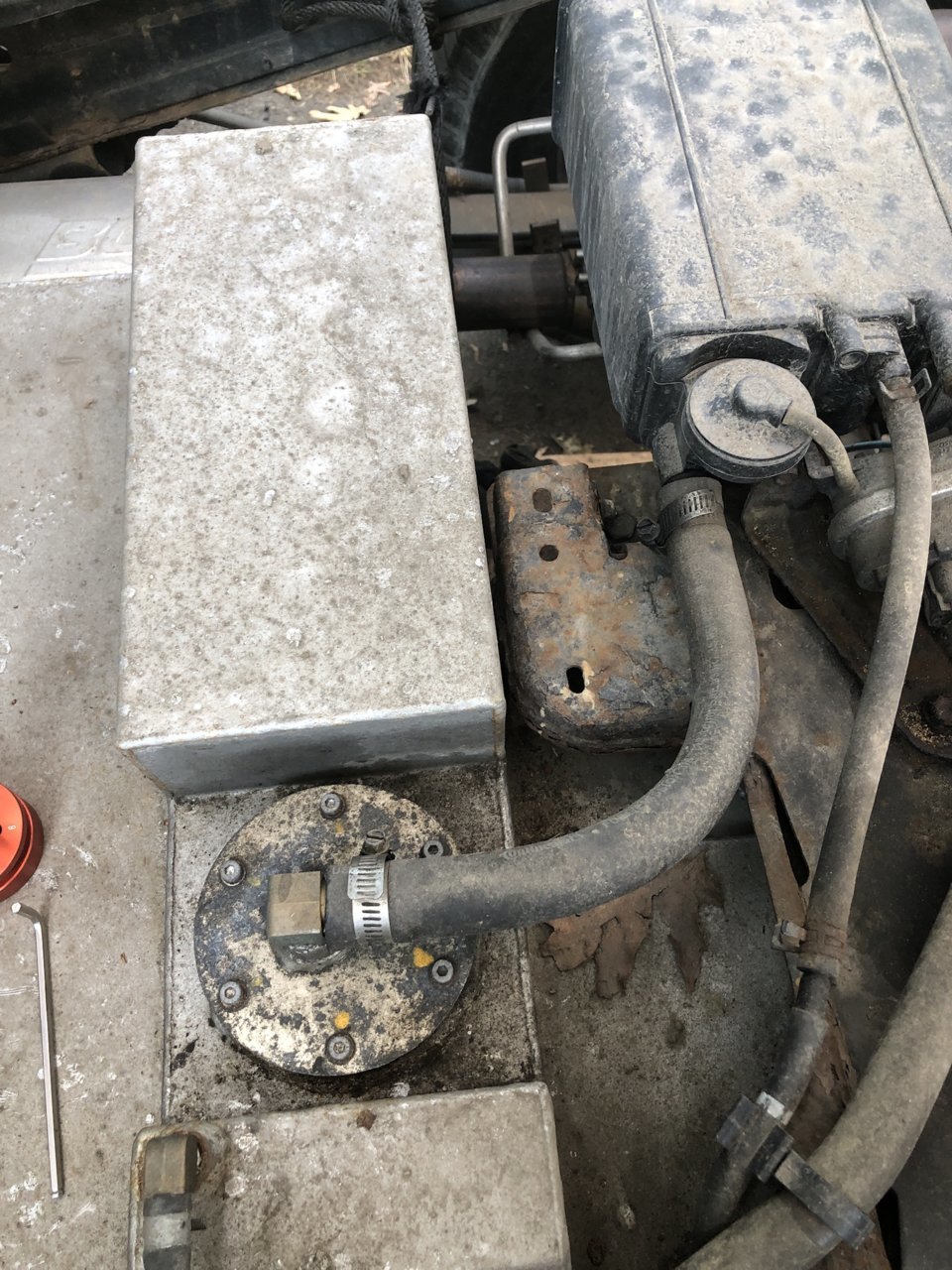

    You do not need to remove the bed. However, it makes it a lot easier to install. I recognize I was an early adopter , but I still don’t believe they have completely addressed the pressurization problems(burping) by the look of the tank that was just posted in the photos above. I solved mine by adding an equalization line and I haven’t had an issue since. I love the line x idea though.

    #imadeitmyself …
    I used some fuel line and made my own T fitting out of the supplied 90* brass fitting and another brass fitting.
