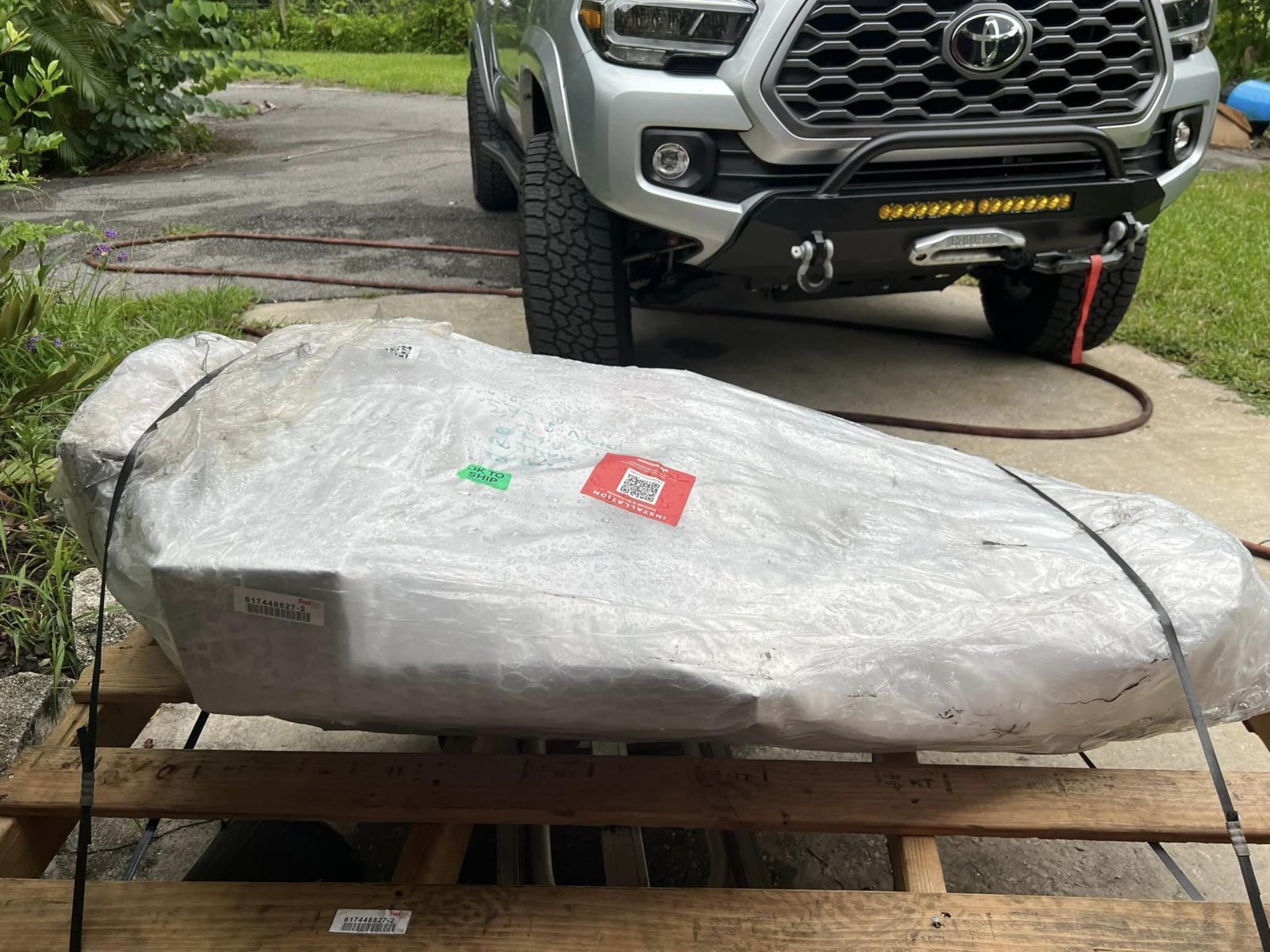

    367
  14. Jan 16, 2024 at 11:02 PM
    #634
    JasonT87
    JasonT87 Well-Known Member
    Feb 6, 2016
    #177280
    1,023
    Jason
    Southern California
    '16 TRD Sport DCSB
    Total Chaos mid-travel front. JD Fab SUA rear.
    For install? You could almost do it yourself with another friend to help remove the bed. It looks mostly bolt-on/plug and play

    Install is difficult but not impossible to DIY. I did it with @6 gearT444E in a day. The only bummer was a face full of gas from accidentally swapping the lines. :anonymous:
