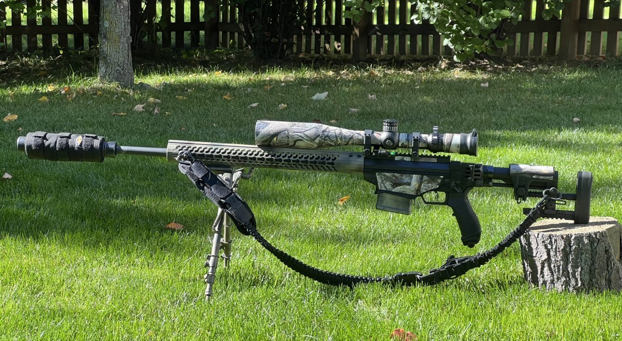

    I did me one of those also, would you believe I ended up selling it for $750. I think I paid $89 for the original Mosin

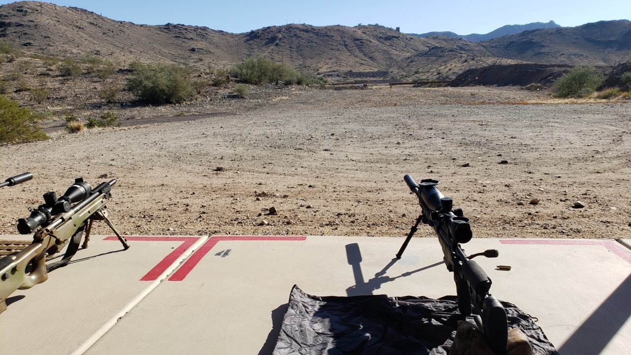

    Breaking in the TBAC ultra 9 yesterday at my buddies range. Kinda impressed with the TBAC well not just kinda really impressed by it. Not only is it incredibly quiet on the 6.5 the POI shift was 0 horizontal and .3 mils down and a big part of that was last time I zeroed it was about 30 degrees hotter
    I decided to join a private range facility right now they go out to about 1100 with plans to buy up some of the parcels surrounding the range to expand the long range platforms
