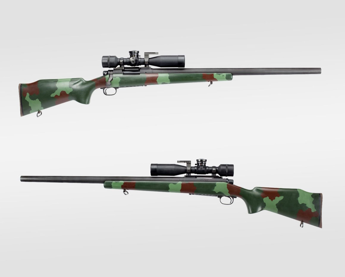

    Hey guys,
    Is there any other M40 guys on here?

    Idk know how much help I’ll be. I one of the m40 owners, mine is the A3 and looks identical to the lower photos. Same S&B pm2.
    First and last time I messed with a Unertl scope was SS school mid 2000s. By then they were being phased out in favor for the Schmidt and Benders.

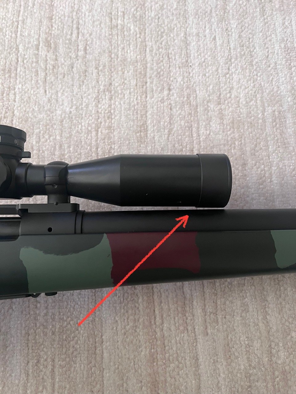

    Yeah, they don't make the Unertl's anymore. Damn shame, I got mine from the CMP. I'm having an issue with my MST and I'm not sure how to go about it. The gap in between the Scope and barrel are not exactly parallel. As you can see in the picture, the scopes forward bell is slanting downward. Other forums suggested maybe a bent tube.
    My base was made by Chris from TheHogsDen.com and its a true reproduction for the M40a1. It was milled and fitted for my receiver so I know its true.
    -Is it fixable?
    -Will it effect my zero if it's not fixable?
    -Have you seen anything like this before?

    Um yeah, it looks normal. Looks like mine, the A3 base. Which is a 30 moa base. Might not be normal for a A1.
    It’s to give the scope more up adjustment (extending the range of adjustments, by freeing up where the scope is zero’d in the erector. If it was for an A1, then I assume it’s the wrong one, if having a replica or whatever is the goal.
    I could math it for you if you know how many mils of travel that scope has…30 moa gives a little over 8.5 mils. Usually subtracted from the middle of the total travel….ish.
    edit: I forgot, those scopes had the retarded moa knobs with mil reticles. Same thing applies though with total travel.

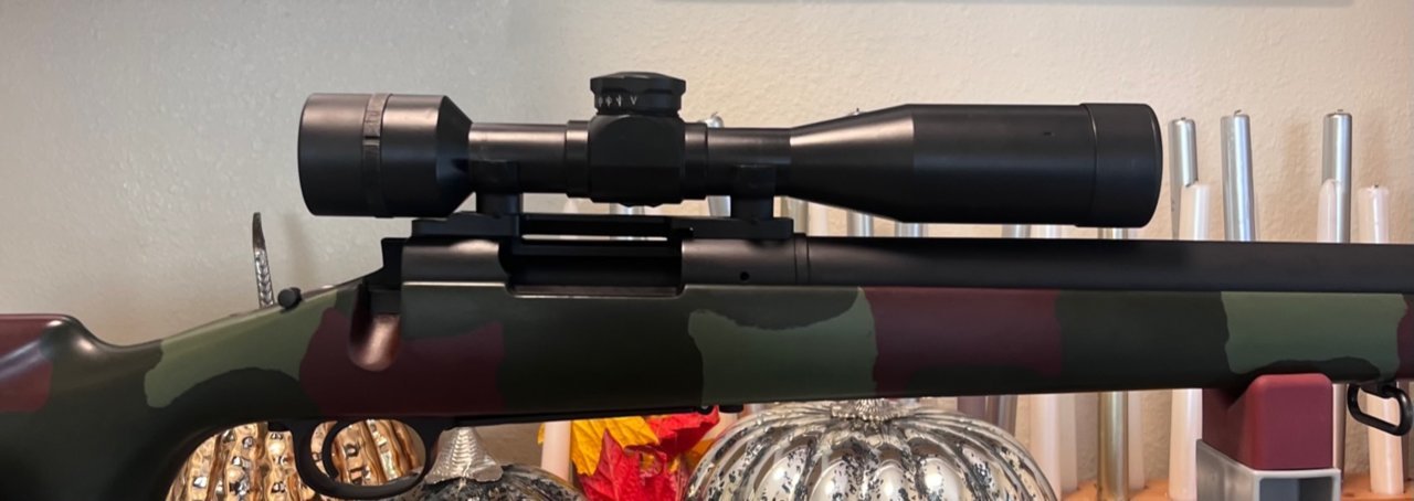

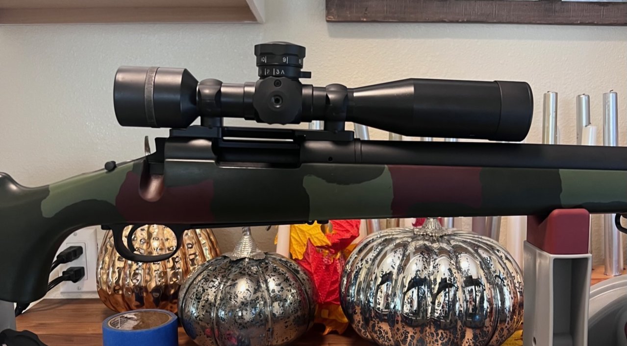

    Maybe these pictures will clear it up. If you compare the two pictures, and look at the front bell of the scope.
    This lead me to believe that the scope is bent.
    Rotated the scope on its side, the gap opens up.
    The scope is in the upright position, the gap tightens.
    IMG_3507 (1).jpg .

    Ah yes. It appears so.
    That could be a problem. I would start by remounting it where the reticle is plumb with gravity and do a tall target test. Then box test it, to check return to zero for windage. That’s really the only way to be sure. Or you can do it in a vice.
    With any luck, maybe you get a few extra moa up’s.

    This ^ would be the upside Hahaha. I haven't even shot it yet. I'll have to take it out and get my zero, test and test and test. Thanks for the help.

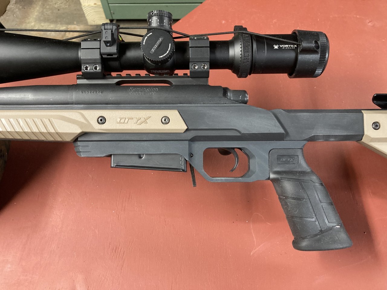

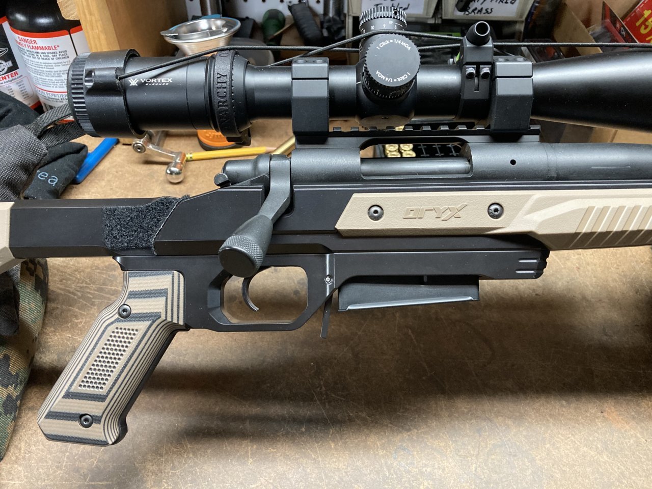

    I picked up a MDT Oryx Chassis over the holidays. It was an overstock item, I think their new offering has updated features. I knew it had an anodized finish and for the price I paid I knew I was going to cerakote it. I had it done by Easton Firearms Refinishing. He did a nice job. before and after.

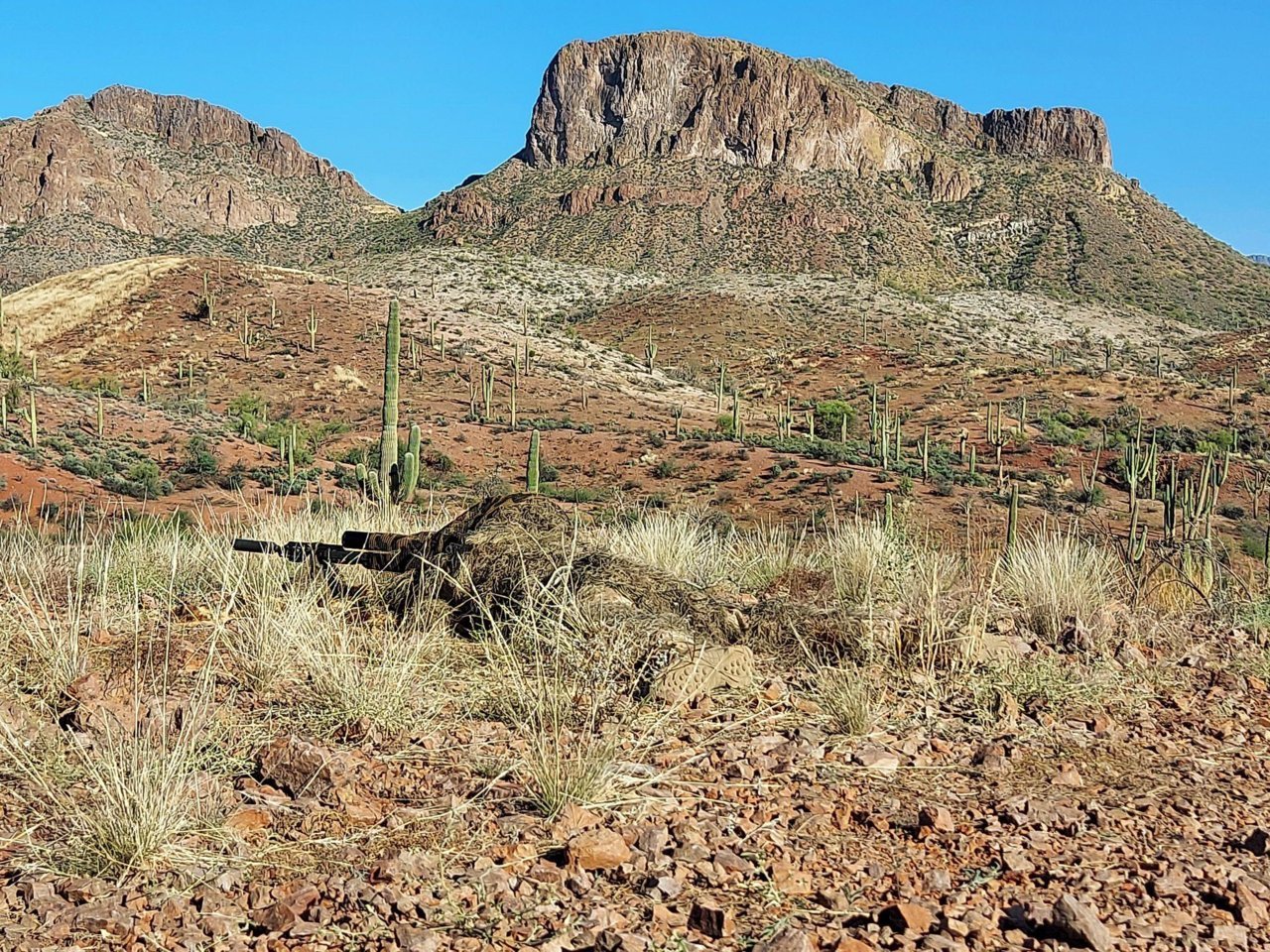

    Desert Shoot - Halloween Day just for fun! Remington 700 LA .30-06 | MDT Chassis | Vortex Viper PST 4-16 x 5- | Magpul Bipod | Sig SRD Direct Thread Suppressor
