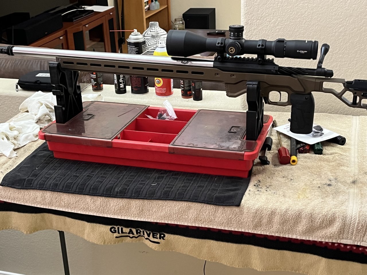

    Newest build. MDT ACC chassis chambered in 6BR. So far have gotten 1/2 inch groups at 100, still finalizing a load. Plan is to shoot a PRS match this year.

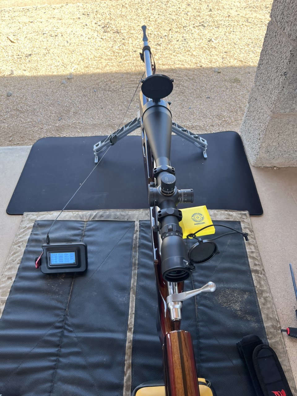

    Took the F-class 308 rig out yesterday for some testing. Happy with the SD and velocity. Taking it out to 600 tomorrow for the real test.

    What grain bullet are you running in the 308 to get those speeds?

    SMK 155gr

    Damn. That’s still smokin fast.
    I used to run 155 scenars around 2910 with a 22” barrel and had some pressure signs. It was a hot load but the gun loved it.

    Yes, it is above published data but a custom chamber for Lapua brass, SMK 155's and it is a 30 inch barrel. If I drop it 0.1-0.2gr it just does not group as well so I go with it.

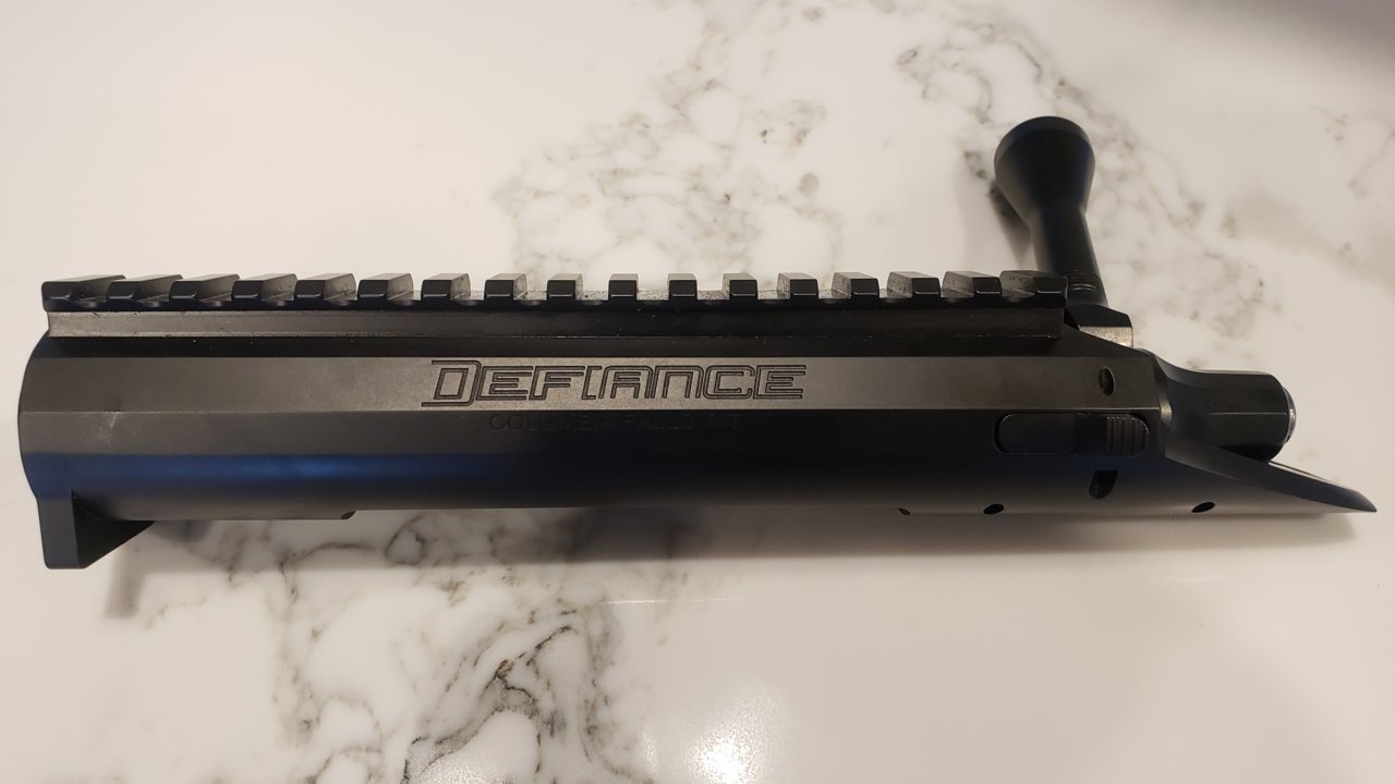

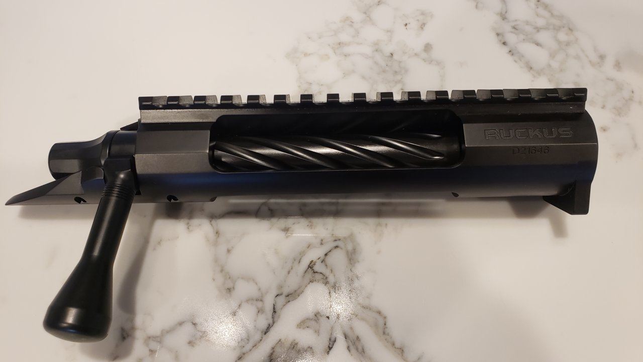

    The wait is over..... almost still need a chassis and to get the barrel spun up 20230727_170736.jpg 20230727_170614.jpg

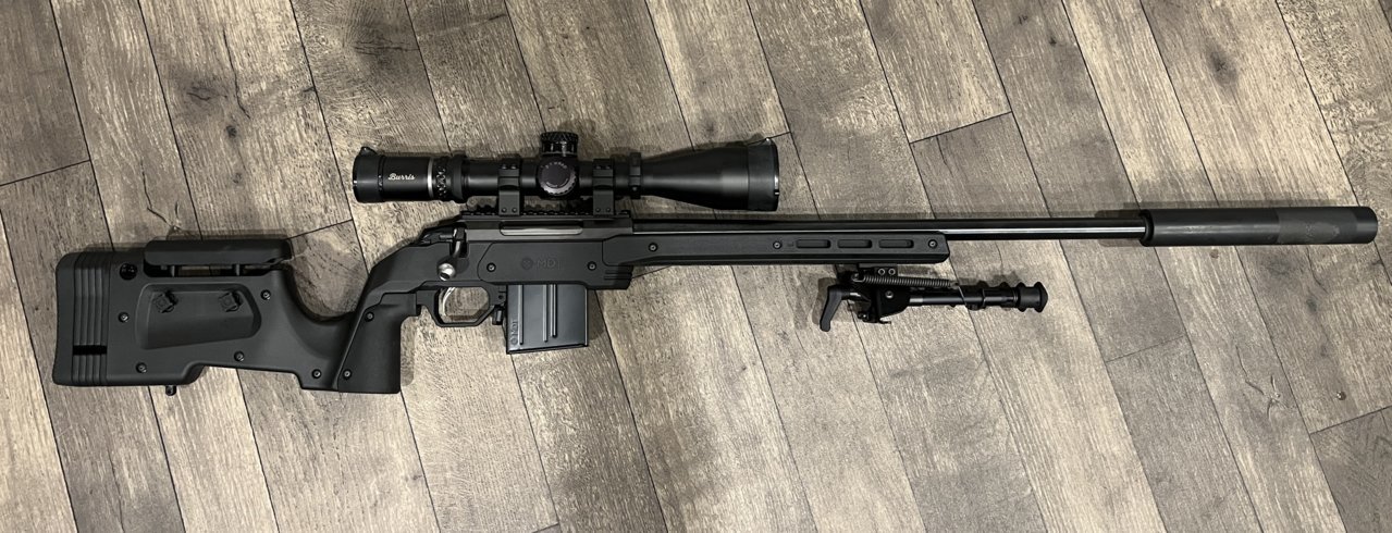

    Tikka T3x .223 Varmint contoured by ADCO.
    Yo-Dave spring
    Burris XTR III 5-30x56
    AEM5
    MDT XRS
    -Rorschach-, azshooter40 and smugly like this.

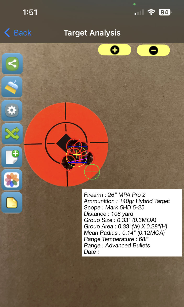

    Finalizing my load for Arena Training Facility trip in late October.
    H4350 42.3gr
    140gr Hybrid Target, .020” jump
    Lapua SRP and CCI450
    2867fps 4.6SD 13ES
    26” PMR Pro 2
