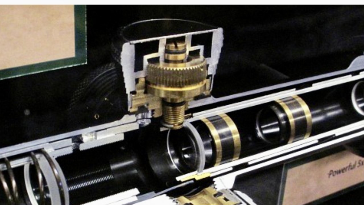

    I’m not a scope smith, but all the parts of a scope are about the same. Most scopes have teeth in the internals of turret that make the clicking noise that follow a measured track that pushes said measurement down on the erector and it’s assembly. Assuming you don’t have the “tactical model” and forgot to tighten the scope turret back down, the others have a spine and grove the turret sits in. If it popped out of alignment then it can free spin. I see it a lot with the old guys beloved leupolds.
    That’s assuming there’s not damage to that brass spine in addition. Probably best to move on from that scope. Cost more to fix it then replace it if it’s more than just an alignment issue. Or take the replacement that was offered.

    you’re scope might not look the same exactly, but here’s a inert of that the typical design and concept looks like. Might give you an idea if something is obviously out of place or what might not be mechanically working as it should.

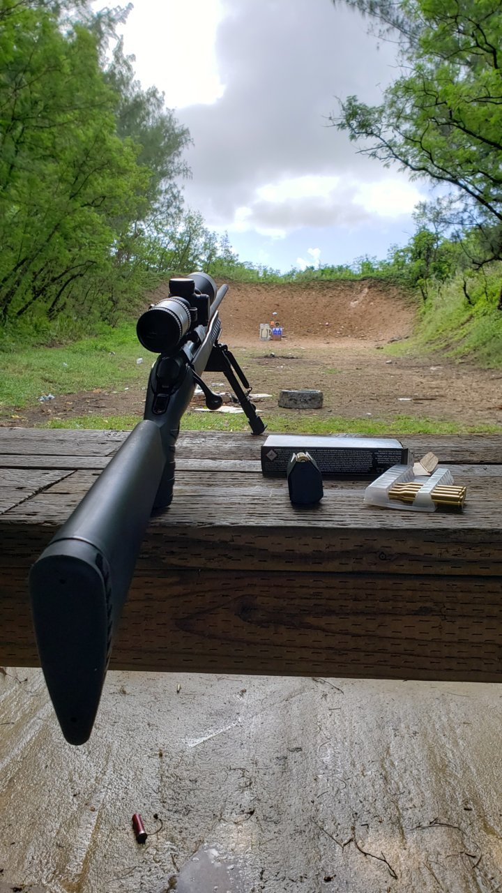

    Got her set at 50 yards.

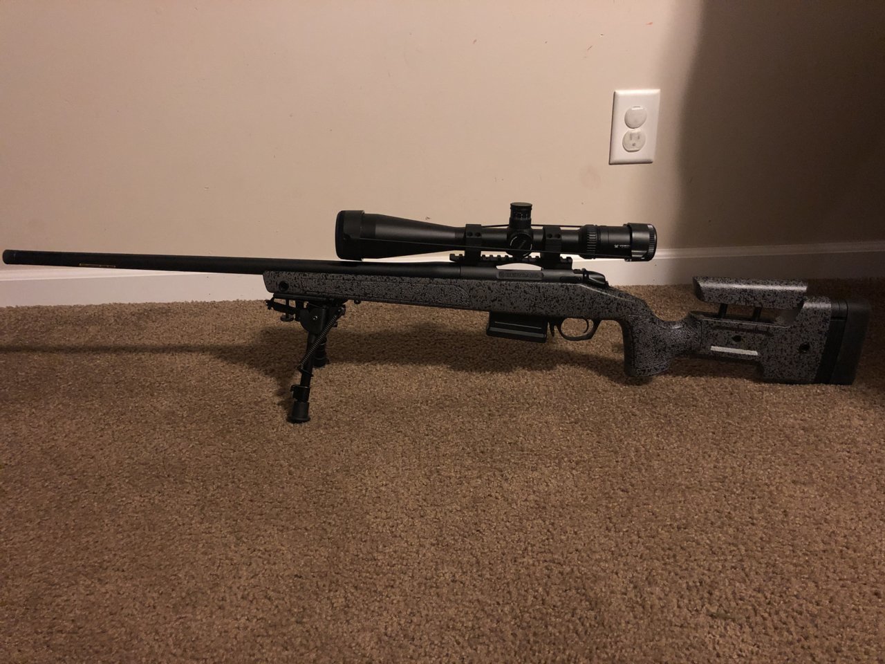

    Thanks for all the information you guys have provided over the last couple months. Mounted the scope tonight excited to shoot this over my two weeks off for Christmas.
    Bergara HMR 6.5 cm
    Vortex HST 6-24

    Sweet setup. It'll treat you right.
