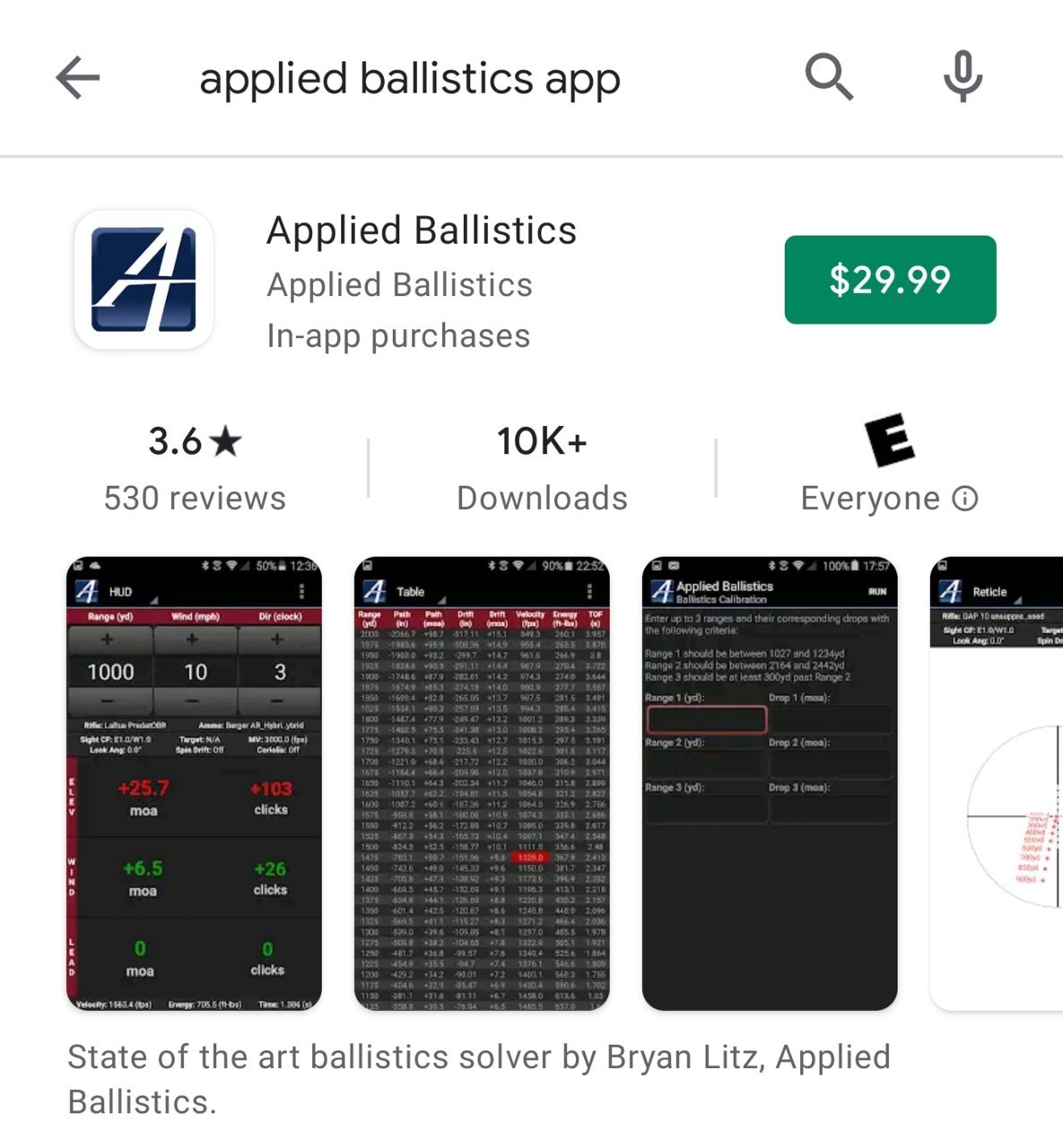

    So this may be a silly question, but is the AB app on google play for $30 not the same as the one engrained in higher end kestrels, etc? Mainly been using strelok to date, but good data being the basis of every thing, Im open to change.
    Seems like that could be a convenient stop gap between the higher end native featured AB kit and what Im slowly building up in the gear closet based on what I learn and observe at matches.

    It’s the same. You get free access to CDMs with the kestrel, and obviously the kestrels updates atmospherics, making it more accurate in that sense. If you just want to plug the range into your phone, make sure your atmospherics are on point, use absolute pressure. Don’t collect weather from the phone app. Use some type of anemometer.
    Use a CDM for your .223. Shoot to transonic, adjust the DSF if needed. True MV for anything supersonic. You should be gucci.

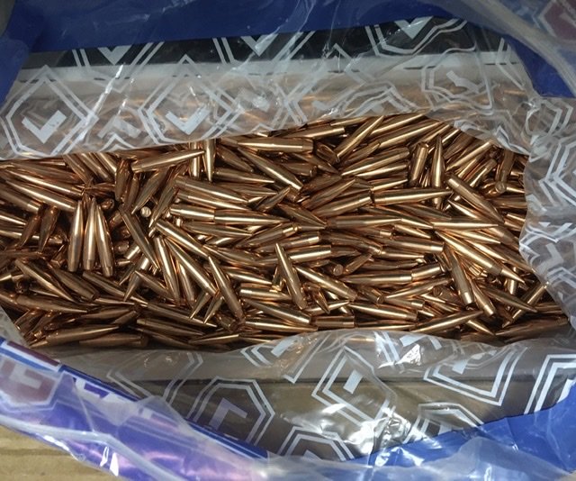

    Aaaaa very merry unbirthday to me!
    .264” 136gn Scenar-L

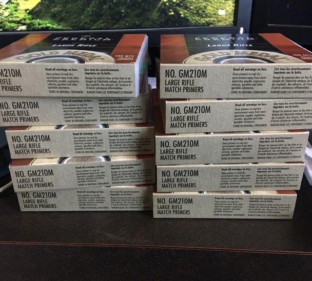

    Been grabbing small rifle primers (CCI 400) for a few days now, silly 200 per person per day limits.
    Swapped them for this pretty pile of amazing.
    Netted me a brick of 210M’s for $45.

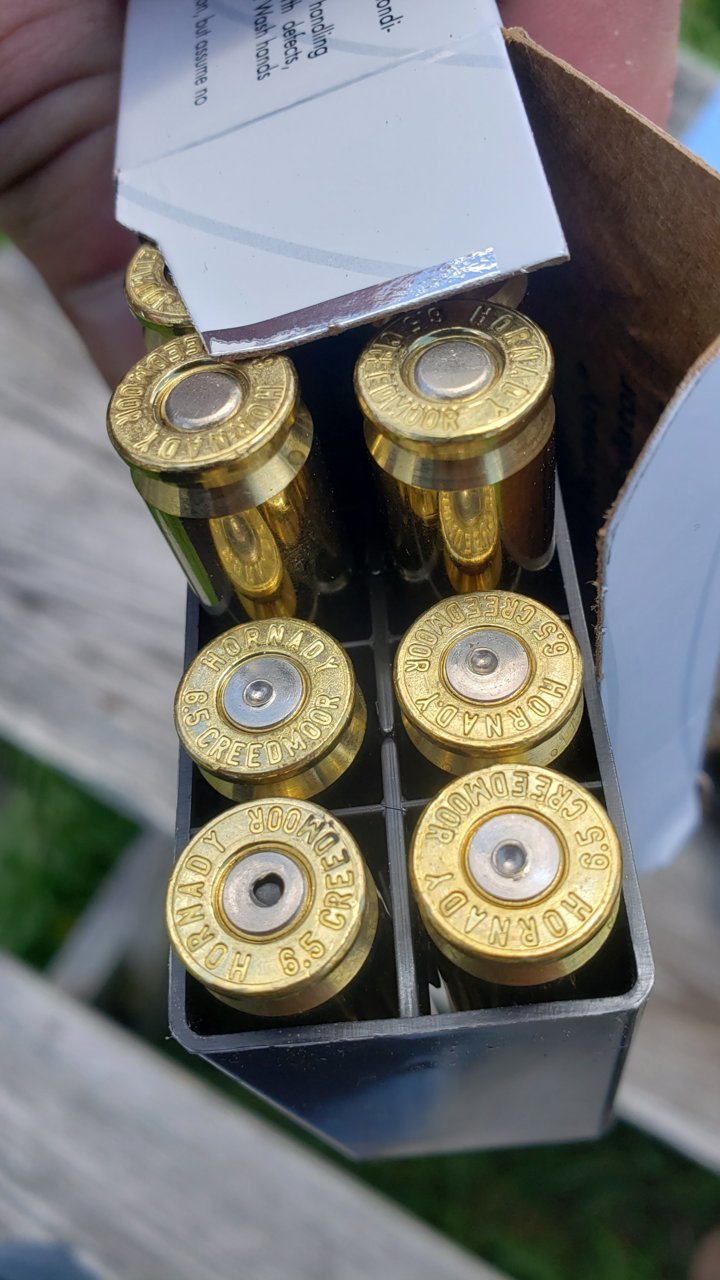

    Factory 147gr match ammo outta my ar10. Pretty hot but shoots great.
    Same bullets outta my friends rpr don't show these signs at all..
    Question- what can I change on the ar10 to avoid making these so hot? Upper is a aero precision ultra match and bcg is a TiN deadbolt

    There’s nothing you can do to make factory ammo not hot. As with most trends most people neglect to talk about the bad, in the 6.5 creedmoor’s case, it can be much higher in pressure then the .308. Even .308 can be be hot, you never really know until you test.
    You can buy a HP bolt, I believe aero makes one, and i use a JP. An HP bolt with a smaller diameter firing pin hole will help with the primer cratering. Do you get a string of MV’s with that batch you pictured?

    I could try a HP bcg. I was thinking of adjusting the gas block to be more open might help too?
    Don't know what "MV's" stands for are the moment.
    This ammo for a few boxes now is always hot outta the AR but not hot at all in the bolt action. Holds terrific groups so don't want to give up on it if I don't have to
