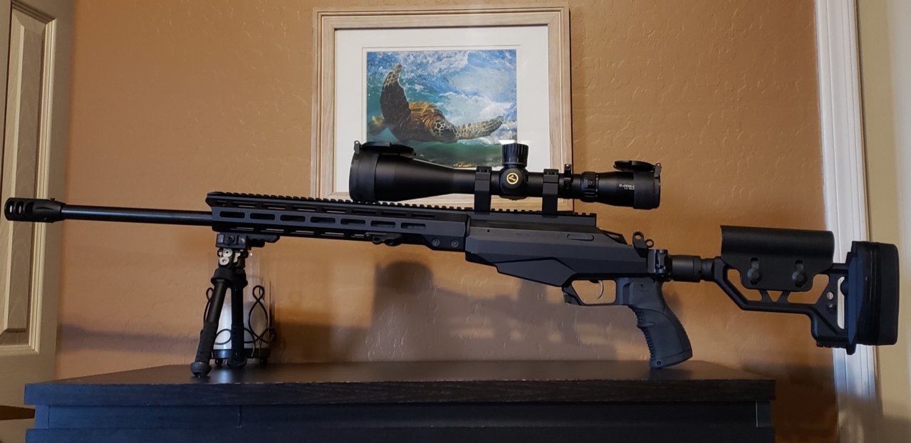

    Sorry to Lurk, but I've been in a few local PRS matches. I dig your Tikka. I've got a similar set up, but a CTR with the KRG Bravo stock. Have you tried a YoDave trigger spring yet? It's Money...

    No not yet haven't found any reason to replace the factory one.

    Roger that. Before you decide to upgrade your trigger, give it a shot, unless you have to have a dual stage.

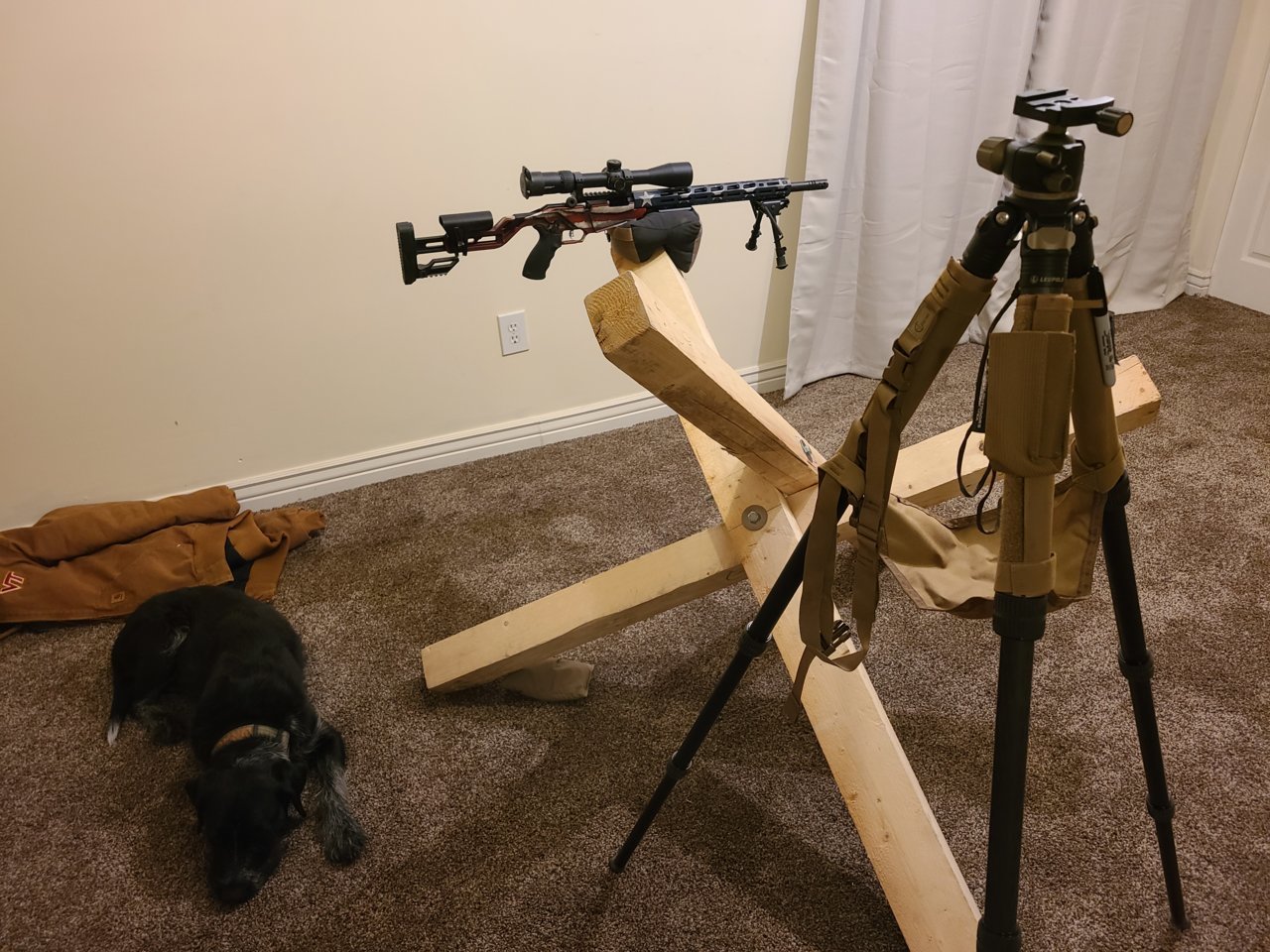

    New CNC machine arrives at work = I get a tank trap practice prop for $6.22 in 1/2 inch bolts.

    Nice! My house is too small to get any indoor practice, but I thought about building and buying some items and storing at the new range,,, the old range was a bunch of FUDDS and ran off PRS type shooters.

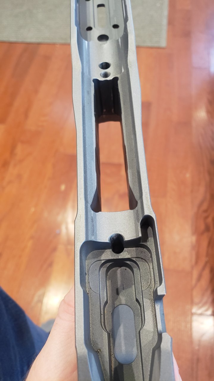

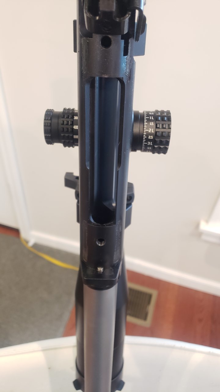

    Cleaning some rifles this morning and noticed the action screws were loose on my savage elite precision so figured I'd pull the stock to clean it a bit better. Looking at the stock/action it is clear to me- they don't mate well. (See pics)
    Is this something I should glass bed or is this typical of v bed chassis systems? I'm fairly new to precision outside of the hunting world so I don't even know what a v bedding system looks like in person. There is no obvious "V" on this chassis just looks to me to be a poor fit and in need of a bedding job.

    Anytime the action screws come out it’s 100% due to improper torque. I wouldn’t be surprised if those screw are slightly bent.
    Just look at getting some Fix It Sticks (kind of like torque wrench) or worst case get that garbage wheeler torque driver and torque to manufacture specs. Bonus tip, you can play with torque settings in 2 in lb increments and look for a “node” in the rifles accuracy.

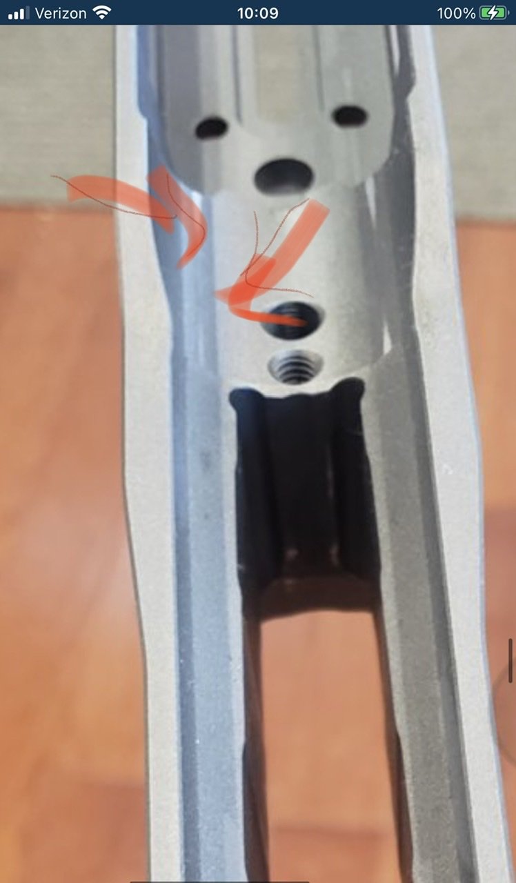

    Here is the V bed on your chassis. This corner angle is the V. I wouldn’t worry about. If you’re serious, I would ask a smith that you trust to blue print the rifle before bedding it.
    …and last, as to not leave you without a direct answer, here, here’s some stuff guys have tried and some general convo related to your question: https://www.snipershide.com/shooting/threads/why-arent-chassis-systems-bedded.6601560/
    Also: don’t forget blue lock tight on action screws. A little dab with do ya.

    That is the exact fix it sticks set I have. I'll add the blue dab of loctite though and brush up on the snipershide forum you linked. I had it torqued down to spec but I guess the recoil of the 338lm can be a bit jarring. I'll give the 2in lb thing a try next time I'm out with her.
    Thanks for all the help. I appreciate it :cheers:
