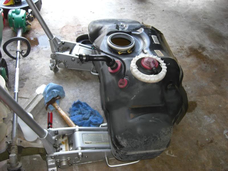

    Ive been looking at the Hilux Fuel tank they have availible and Im having a hard time finding out how close our stock fuel tank is in comparison to the Hilux stock fuel tank
    Im having a hard time throwing a 1000 bucks down on a tank that may fit.....
    So if someone has any links of someone who may have installed one or attempted, hell even dimensions would be great
    Maybe someone has there tank pulled on there current truck would be awesome too!!!
    I need some comparison pictures, and Im just having a hard time finding all the information I may need
    Just found a tank picture from TORSPD!!!!
    possibly someone feel like dropping there tank and taking a side view picture and than a picture the same as the one above, I cant until at the earliest enxt weekend when Im home infront of my truck
    But i think it looks promising

    honestly I think looking at it, its going to fit
    i think its going to be how its mounted will be slightly different
    I myself may go for the 126L tank as you gain an extra 3mm of gap vs losing 15......
    tough to say though, I gotta sit down with my ARB supplier and see what he can pull off for me
    I think ill pull the trigger, and Ill make shift what needs to be done to make it fit

    what's the benefit of this over our stock tanks? looks to hold similar capacity. is it puncture resistant?

    oh, I was judging by this picture. but that much more fuel capacity, it may be worth it..
