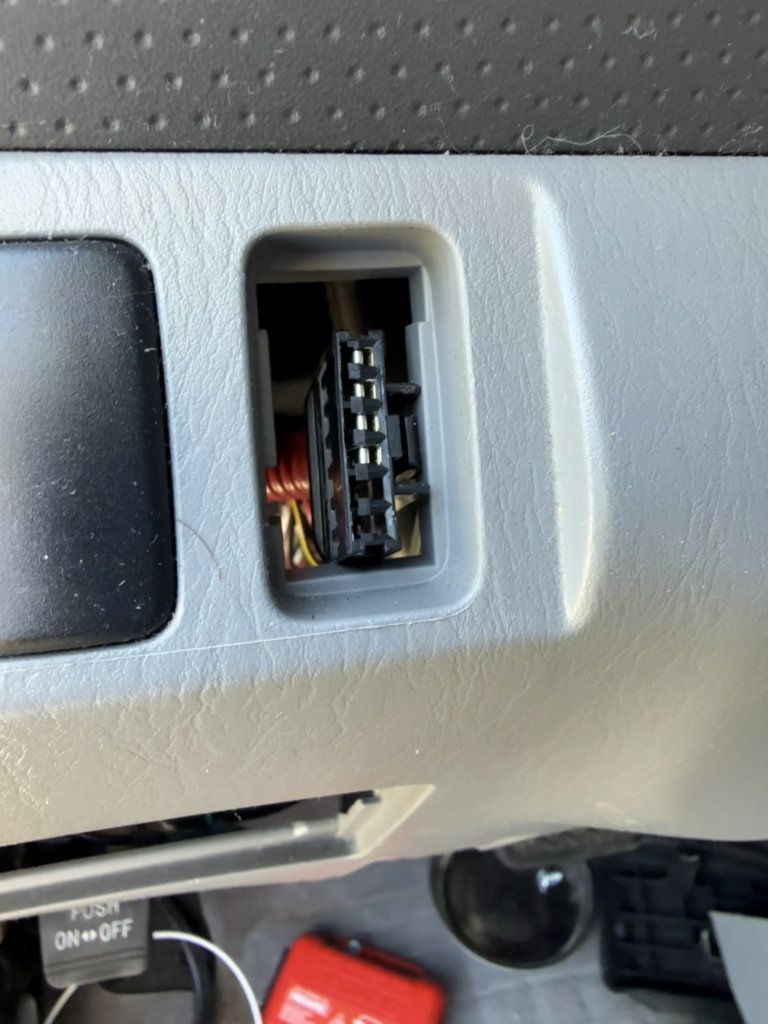

    I'm installing a Redarc brake controller on my 2008 TRD Sport with tow package. This controller has an adjustment dial that fits in one of the poverty button blanks. When I reached up behind a blank to push it out, I found this cable lodged into the back of it. I followed it but within a few inches it gets wrapped up in a bunch of other wires and I can't tell where it goes.
    This is the long shot - what is it? I'm guessing the previous owner had a usable switch in that location but at some point removed it and put the blank back. Other than unwrapping the tape covering the harnesses, how can I figure out what it does or goes?

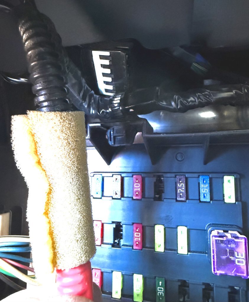

    The wire in the foreground with the foam on it is the mystery wire that joins that mass above the fuse box.

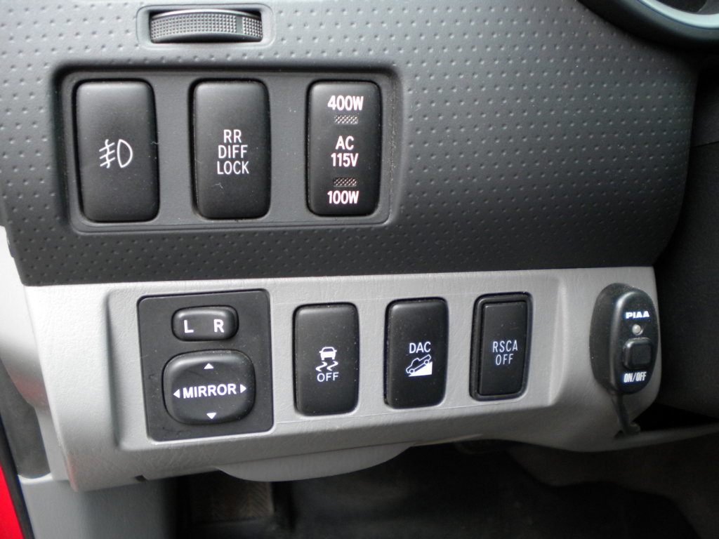

    That spot is where the RSCA switch is on my '15 SR5. It lets you turn the roll sensor for the side curtain airbags off so that they don't deploy off road

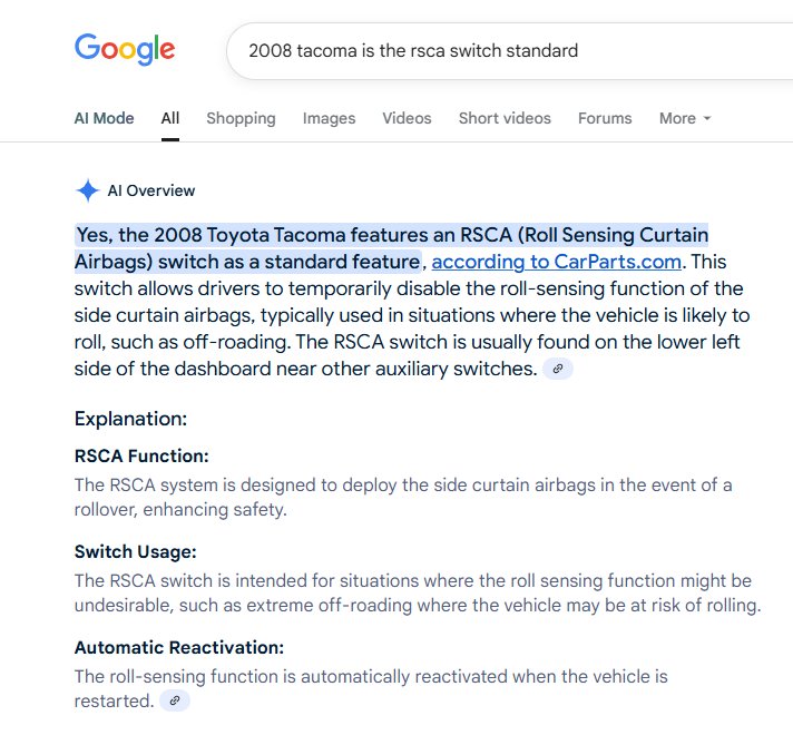

    Thanks. I had to Google that. I wonder why someone would remove it and put a blank in its place? I don't go off road, so I don't need it, but maybe I'll add it back just because. $20 part...
    WHAT DOES THE RSCA BUTTON DO??? | Tacoma World

    Perhaps someone was overly concerned and never wanted the feature to accidentally deactivate due to an errant finger push. According to the last item in your paste it reactivates with each ignition cycle. If you never wish to deactivate it there is no reason for a button, ever.
    Or perhaps they just needed the position for an other button such as a trailer brake.
    Your paste also says it was a standard feature. I would run my VIN through Toyota’s owners site to see just how the vehicle was equipped upon initial sale.

    Take a look at trucks with a switch in that spot. The connector is part of a generic wiring harness that works on all truck models, it's just that your truck doesn't have the optional equipment that switch would control, so there is no switch there and the pigtail gets plugged into the blank. Somewhere else in the truck is another connector that would plug into whatever gizmo you don't have that is controlled by that switch.

    I suspect it’s an option (RSCA) that Toyota didn’t install on 2wd trucks. Nothing missing, just never installed
    Looking at a few listings online for 2008s, it appears to be there on 4wd trucks, and missing on 2wd

    Icon Stage 8, ECGS Bushing, Timbren ubolt flip, Crown extended brake lines, Overland Custom Design sway bar links, rear differential breather extension, oil filter drain hose, a/c drain hose extension & reroute, front windows tint, Cat Security, XPEL headlight/fog & grill protection, OEM block heater, RCBS illuminated 4X4 switch, Weathertech mats, Wet Okole seat covers, Sherpa Grand Teton/Crows Nest, Baja Designs S8 light bar, Diode Dynamics SS3 Pro fog lights, Piaa driving lights, Method 305 NV Double Black, 275/70/17 Toyo R/T Trail.
    switch locations on my 07 Offroad...
