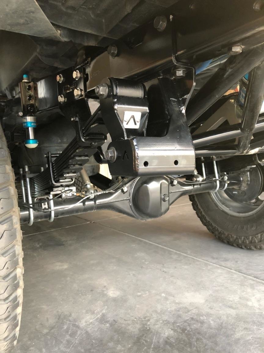

    Anyone have long-term (> 25k miles) experience running @ARCHIVE Hammer Hangers?
    https://archivegarage.com/shop-archive/ols/products/tacoma-hammer-hangers
    I am heavily considering this for my next suspension modification. I've heard these can stiffen the rear end, and I'm looking to improve overall ride experience on- and off-road. Also, these would seem to better position the build for bigger tires with regular off road use.
    Looking for any and all advice. Thanks in advance.

    Ive had my hammer hangers on for 4+ years. No issues to report. They're still going strong, and Im glad I made the purchase and install.

    Same here I've had mine on for more than 3 years and no complaints. Hard to tell re: day-to-day driving. I put on the HH at the same time as a new leaf pack so a lot changed at once. I can say that the rear end does feel more stable when I've been towing a trailer with the HH than it did stock.

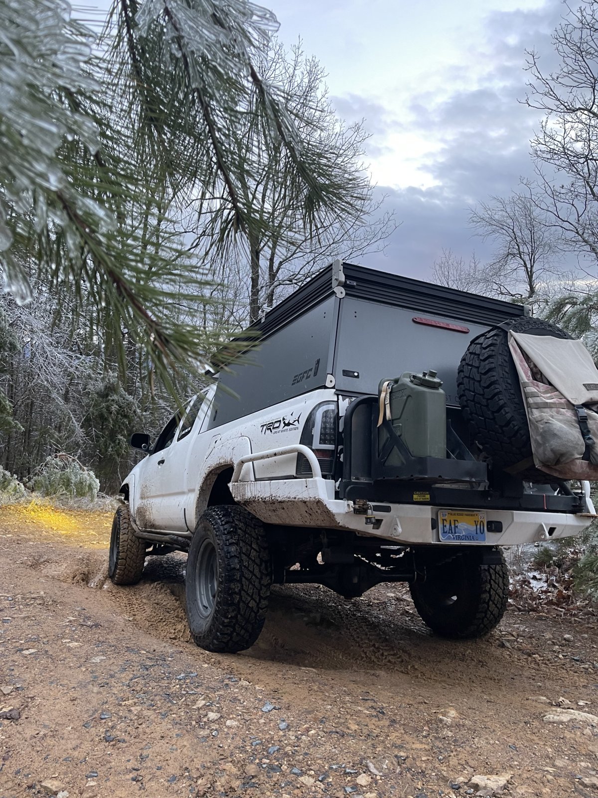

    yeah I just went with a high clearance rear bumper with a swingout. the long term plan is to put an air tank in that spot mounted up to the cross brace.

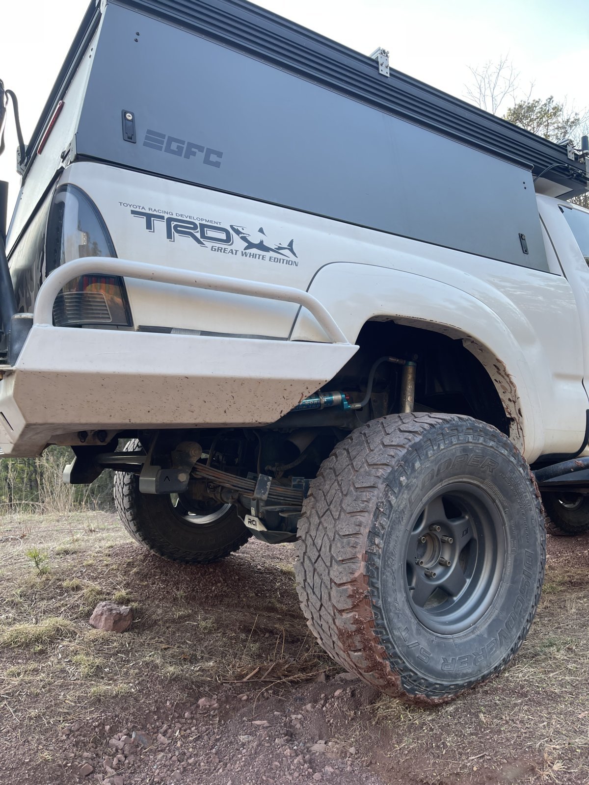

    I have a high clearance rear bumper with swingout.

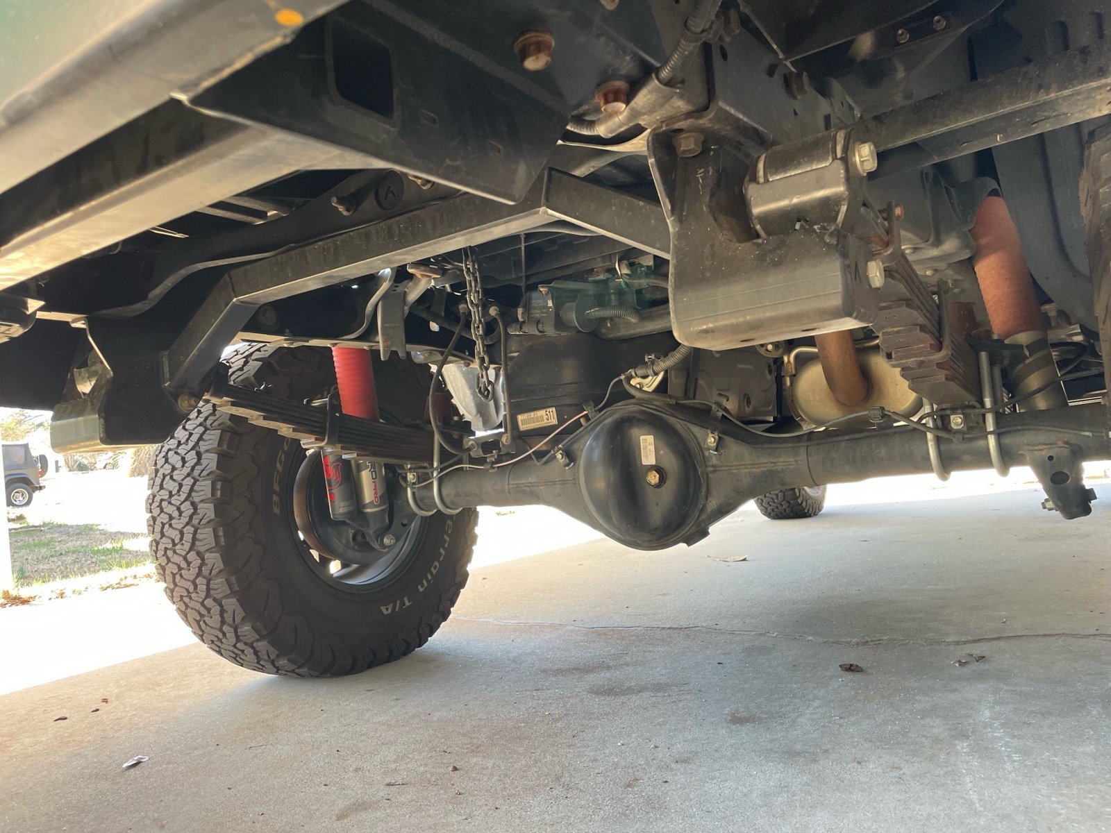

    I also have an air tank mounted under the bed

    did you place it forward or aft of the HH cross brace?

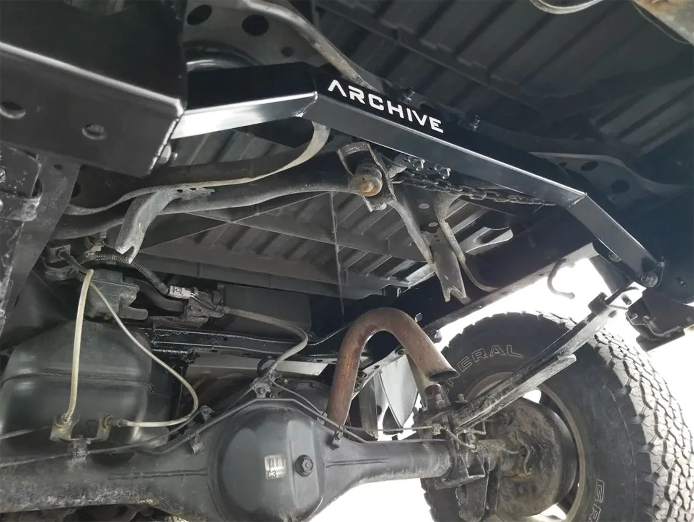

    I've had mine for 15k. One of the best mods I've done to the back end of the truck. You will feel an improvement immediately. I was able to install them myself in a few hours with an air hammer, drill, and a pry bar.

    I'm just shy of 25k with mine, and I am so glad that I did them. Incredibly worthwhile. This is with the hangers, shackles, and cross brace.
    I did my install in ~4 hours, with just a drill and angle grinder, fyi. Though I always love an excuse to buy some new tools!

    It is between the bumper and the cross brace

    Id just recommend an angle grinder and renting a ball joint C clamp press. You can do it by drilling out the rivets, but why work harder?
