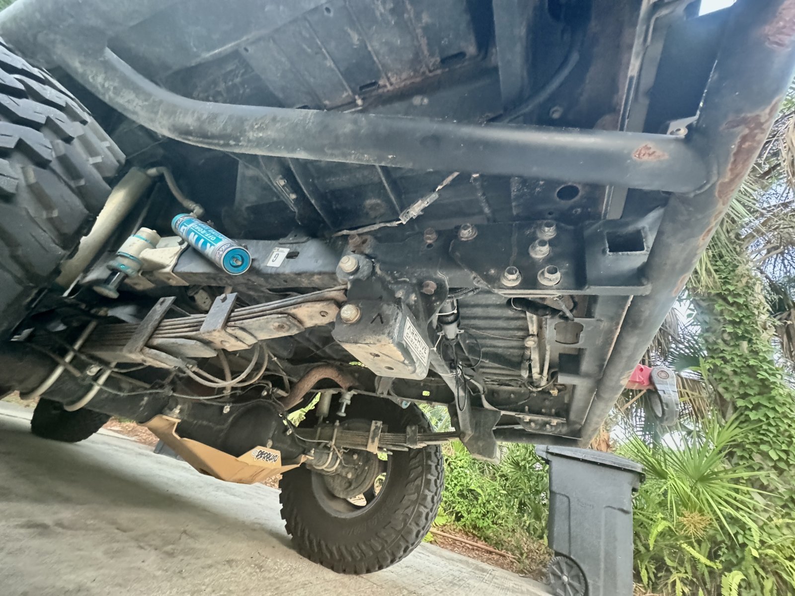

    I used an angle grinder, drill and air hammer, a punch will work fine. I would not do anything differently. I think the way I did it is the easiest way.
    First grind down the rivets flush, once they are flush to the frame the air hammer makes quick wok of them. That way you don't have to drill out the rivet.
    It's slow process, nothing out of hand.

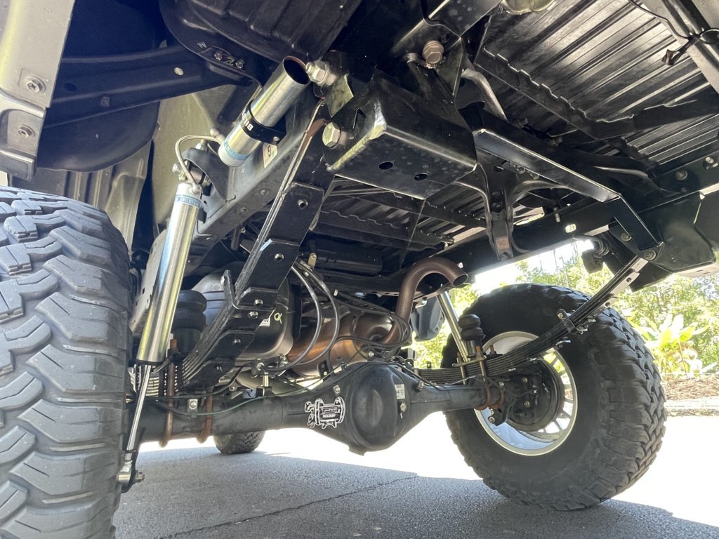

    It looks like it is, but It's not easy to hit these. The angle in relation to the tire keeps them relatively safe. I've been down a vertical 4 foot rock wall where it hung on the bumper, the hangers were not touched. In the pics below you can see the relation from the tire to the hanger static at ride hight. Obviously it changes while flexing, but you get the idea. The 2nd pic is to show all of my hits on the bumper with minimal hits on the hanger. All the rust spots are hits. I can't say that they never hit, but for how they flex I'll take the hits here and there. It would be very similar to any extended shackle drops.
    How I understand it, the brace allows the force from the articulation to spread between both frame ends keeping them a bit more planted than not. It helps keep the frame mounts/hangers tight together while everything below is looser then stock. I hope that makes sense.

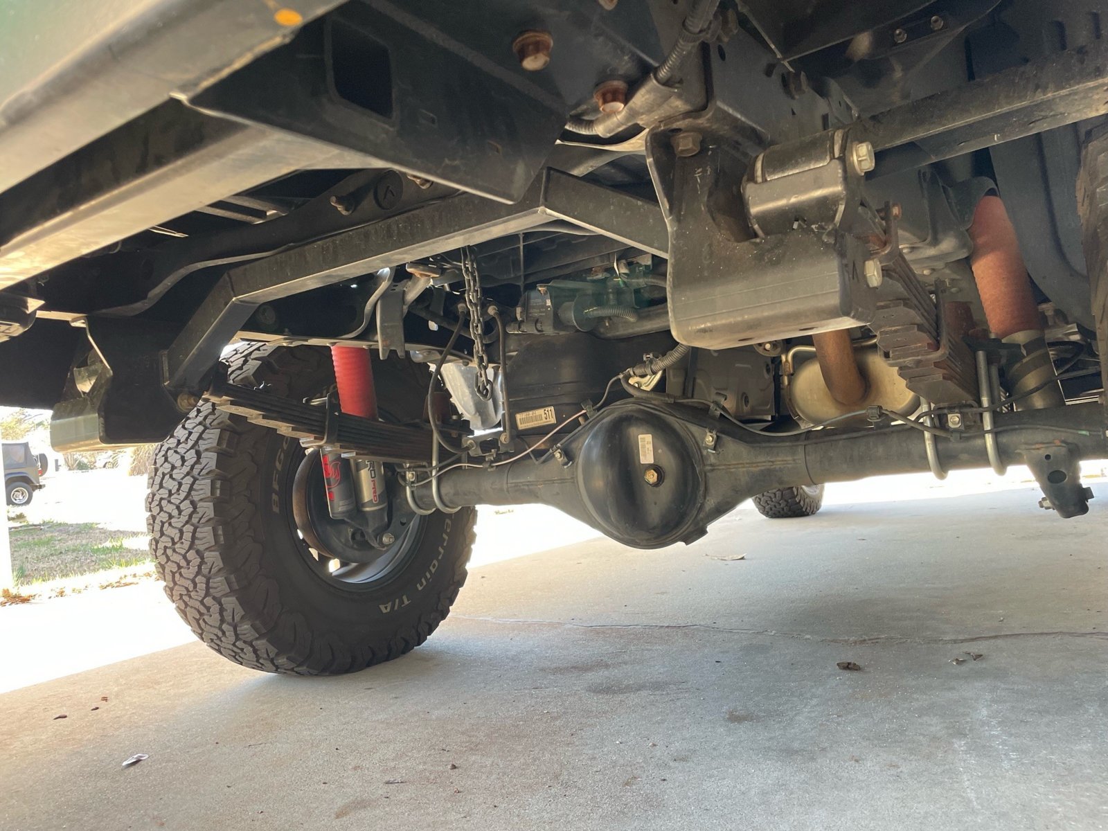

    I was just challenging that other guy who said stock is better :rofl:
    Ive had HH for 5+ years, and theyve been awesome

    Yes. It connects the two which would spread the load across the frame, as well as stiffening the rear and making it feel more planted

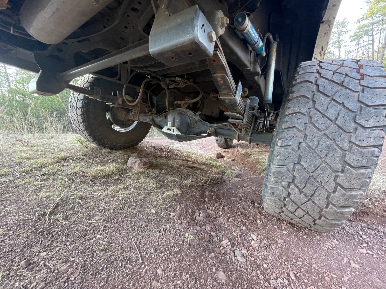

    Ive hit them many many times, probably almost once a trip. I dont think its uncommon to hit them. Likely depends on the specific terrain you wheel too

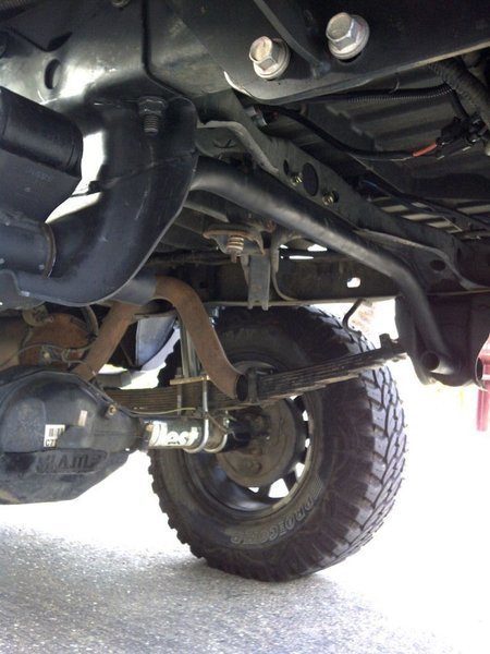

    I’m not sure what I’ve done to earn the condescension…
    Allow me to clarify, I’m was talking about this (or something homemade like it):
    If you go back and re-read my posts you’ll see that I suggested this ^ would be better than hammer hangers alone (and cheaper). Didn’t say that stock is better. Your setup looks nice, and it’s probably the best of both worlds, because you have BOTH brace & hangers, although a brace with 3 tie ins like mine pictured is yet better than just horizontally connecting the rear leaf pivots like yours (Archive?) does.

    Archive crossbar ties in three points as well.

    Nice. Maybe they improved their design. the one fatfurios showed us was just horizontal between the shackle bolts.

    Yeah I think maybe 4ish years ago they switched from the straight bar to the one I have. Your homemade design is pretty cool and a great budget option.

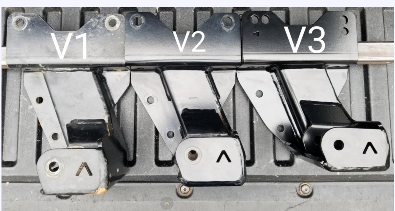

    You have the Bay Area set, I'm almost positive they hang lower than the Hammer Hangers. In the pic below you can see the evolution of design for Archive. Current HH hang lower than stock mounts. So if you're not hitting the stock mount chances are you won't be hitting these often.

    Has @ARCHIVE seen this side-by-side comparison? (Or did they publish it?) This is great information.

    Those are pics of the Archive Hammer hangers as they have evolved. It's Archives picture, he posted it.

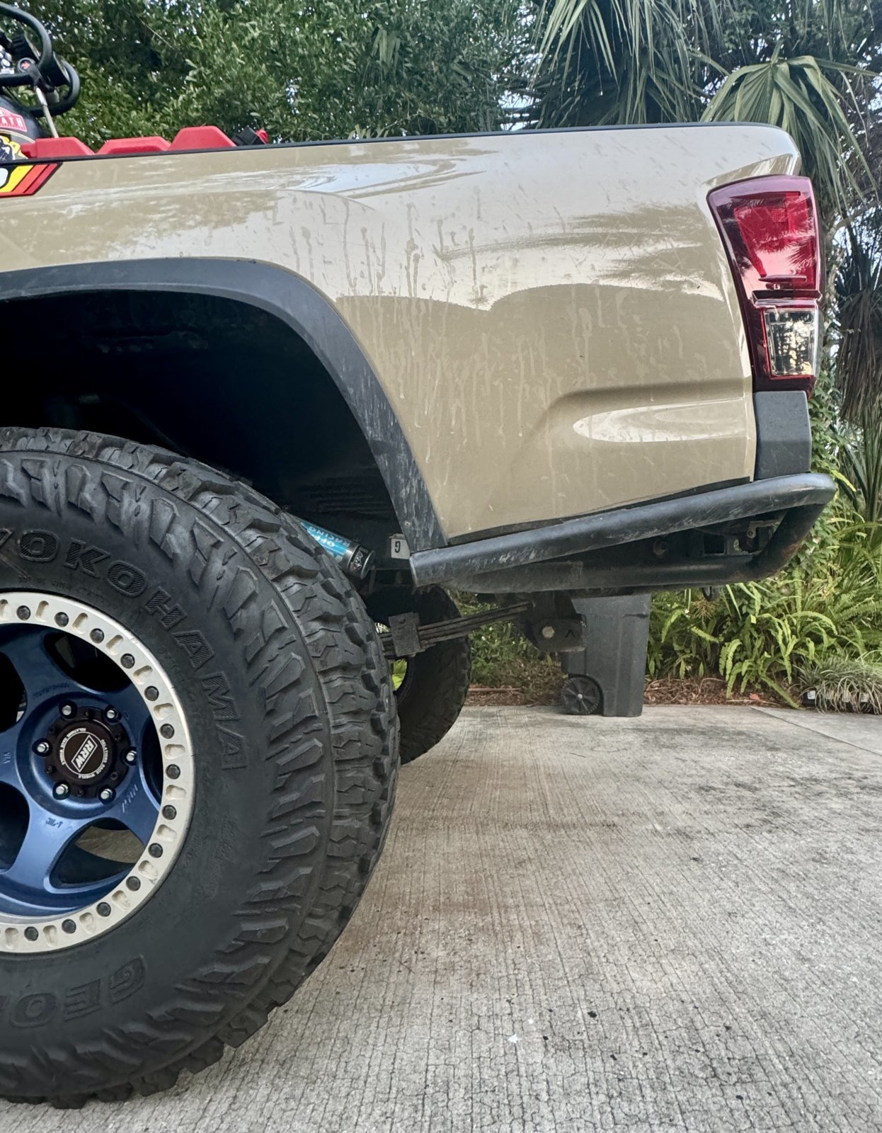

    I put on HH’s without crossbar maybe 2 years ago and I honestly didn’t notice a difference. I have wanted the crossbar hoping to see the improvement I’ve heard about doing this upgrade. I’ve heard and read people say that it was “one of the best mods” they’ve done and those are also people with no crossbars, I just didn’t feel that result. But, they look fricken great with my HC bumper and I’m optimistic about the crossbar improving the rear. I don’t have Archive, but another reputable brand.
