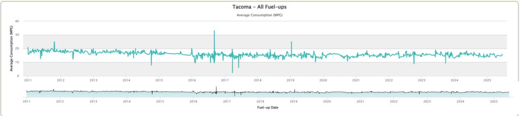

    I run 255/85/16 KM2/KM3 e-rated for offroad and 265/75/16 Falken at3w/at4w passenger rated for street tires. 345k miles on my truck now and I bought it with 30k. Mileage between the two really isn't noticable, some people are more sensitive than others, but honestly riding with a passenger or groceries can be the same as the weight difference of tires.. I don't switch back to street tires immediately after a trip, I'll usually leave the e-rated on for a couple months. No issues with alignment/balancing/bearings/other due to the slightly heavier tire/size difference/agressive tread/weight rating.
    Brand and model of tires can have more to do with tire wear than your other worries. Different compounds and speed ratings and even your driving style can play large rolls.
    There are obvious outliers here (30mpg..) but then some are fillups from offroad trips, some trips across country with varying fuel grades or stations, some evap and catalytic issues, etc
