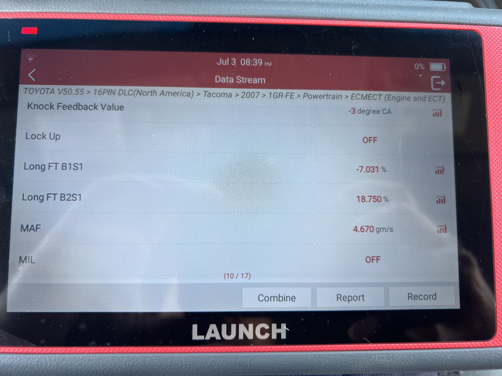

    My LTFT’s are pretty far apart at idle and I’m seeing some pending misfire codes for cylinders 1,3, and 5.
    Could the timing be off a tooth cause this? If so, is there a way to confirm it without having to tear it all back apart?

    I think you need to verify exhaust cam timing, the inverted fuel trims suggest a timing issue.

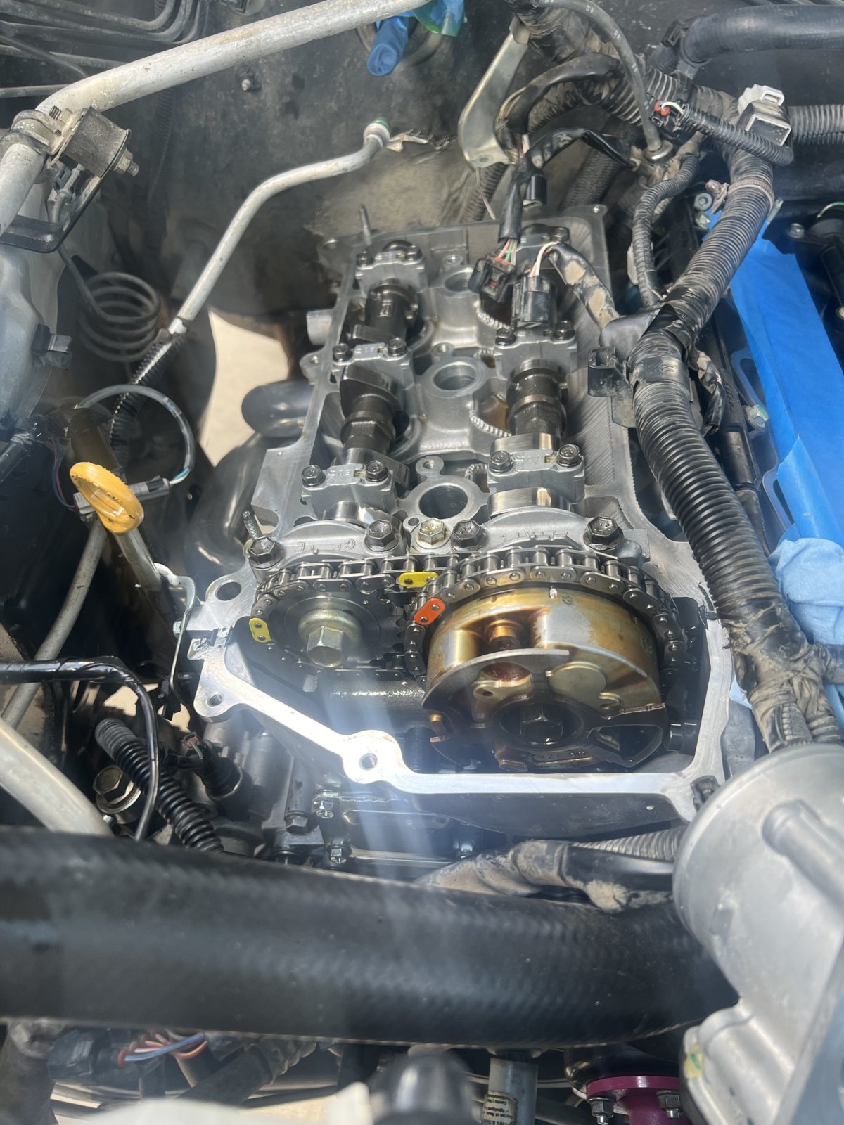

    Looks like I’m off a tooth on the exhaust cam.
    What’s the best way to get it back in the right position without messing with the main chain?
    Is there a way to remove a link from the chain, move the cam, and then reconnect the chain link together?

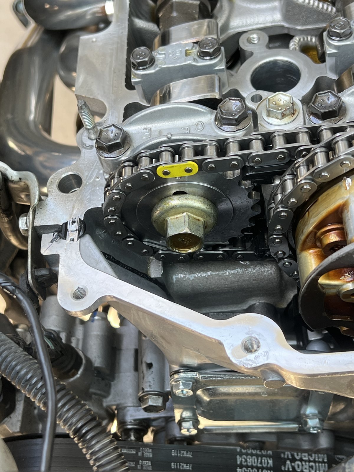

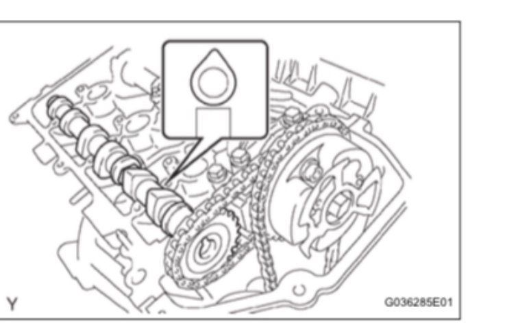

    I think I’m being thrown off by this pic/step. It makes it seem like the #1 exhaust lobe is in line with the cam alignment pin, and it’s not.
    If the lobe is straight up, the alignment pin is at roughly 10 o’clock.
  13. Jul 5, 2024 at 7:00 AM

    Retested compression and still showing 120 psi.

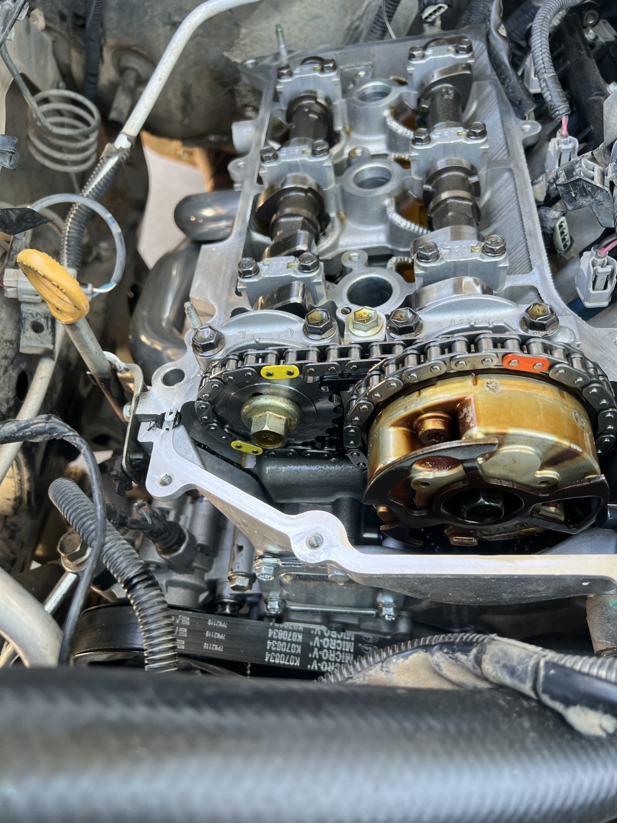

    I’m not sure what I’m doing wrong here. I feel like I have all the timing marks line up correctly.
    The main thing I notice is that when they’re all aligned with the timing marks, the #1 exhaust lobe is no longer pointing straight up.
  14. Jul 5, 2024 at 7:15 AM

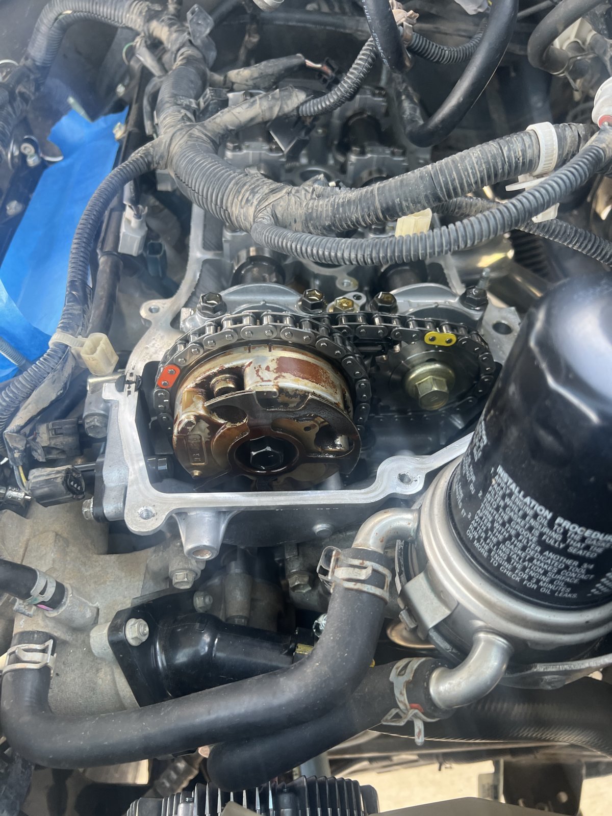

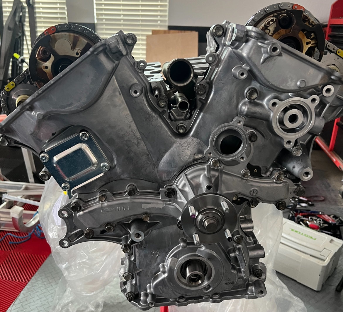

    I don’t understand how everything looks aligned on the engine stand, and now the marks look completely off.
    I feel like I’ve rotated around 50 times by hand hoping they line up again, but they don’t.

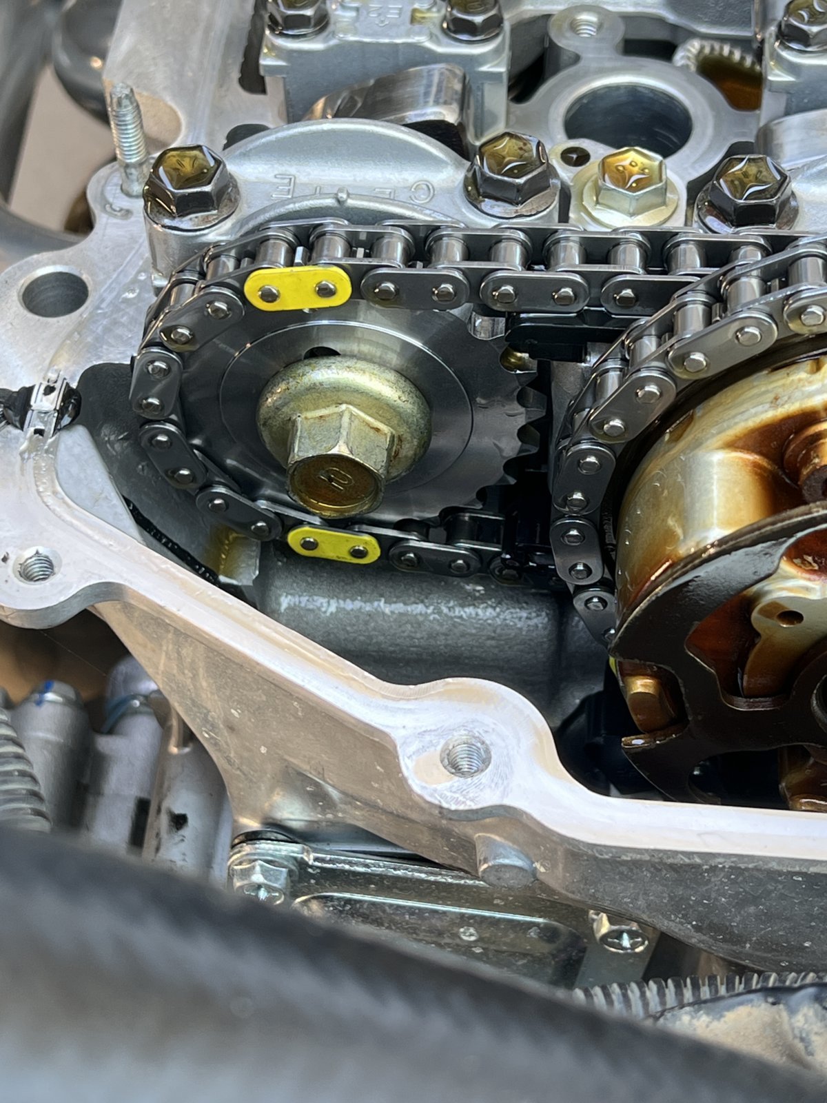

    The colored chain links are only for initial installation of the chain, they won't line back up once the engine has been rotated.
  17. Jul 5, 2024 at 12:16 PM
    #17
    Brandon###
    Brandon### [OP] Well-Known Member
    Apr 27, 2010
    #36105
    1,090
    lol. That’s good to know. Thanks so much!
    I went back made sure #1 was at TDC. I lined up the yellow link on the intake cam dot and then lined up the dot on the exhaust cam with the other yellow link on both sides.
    That should be all there is to it, right?
  18. Jul 5, 2024 at 3:56 PM
    #18
    Brandon###
    Apr 27, 2010
    #36105
    1,090
    Just started it up and it’s missing and shaking. Looks like I need to tear the front cover off and start all over again.

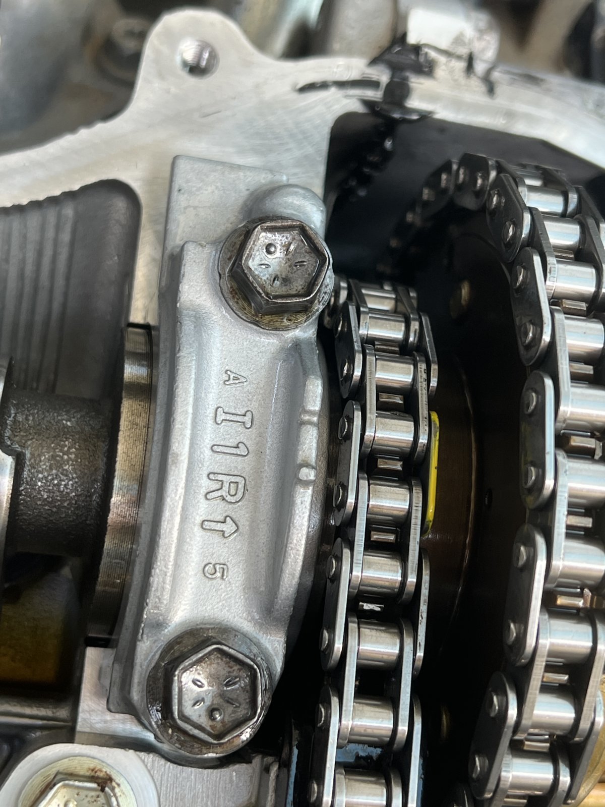

    Bishop84
    Bishop84 Well-Known Member
    Dec 17, 2015
    #172494
    11,979
    bank 1 cam seems off but my 5 year old is bouncing off the ceiling, ill try to remember to look closer later.
    Dm93 likes this.
  20. Jul 5, 2024 at 7:33 PM
    #20
    Bishop84
    Dec 17, 2015
    #172494
    11,979
    Bank 1 is out.
    Same for Bank 2 but harder to tell.
