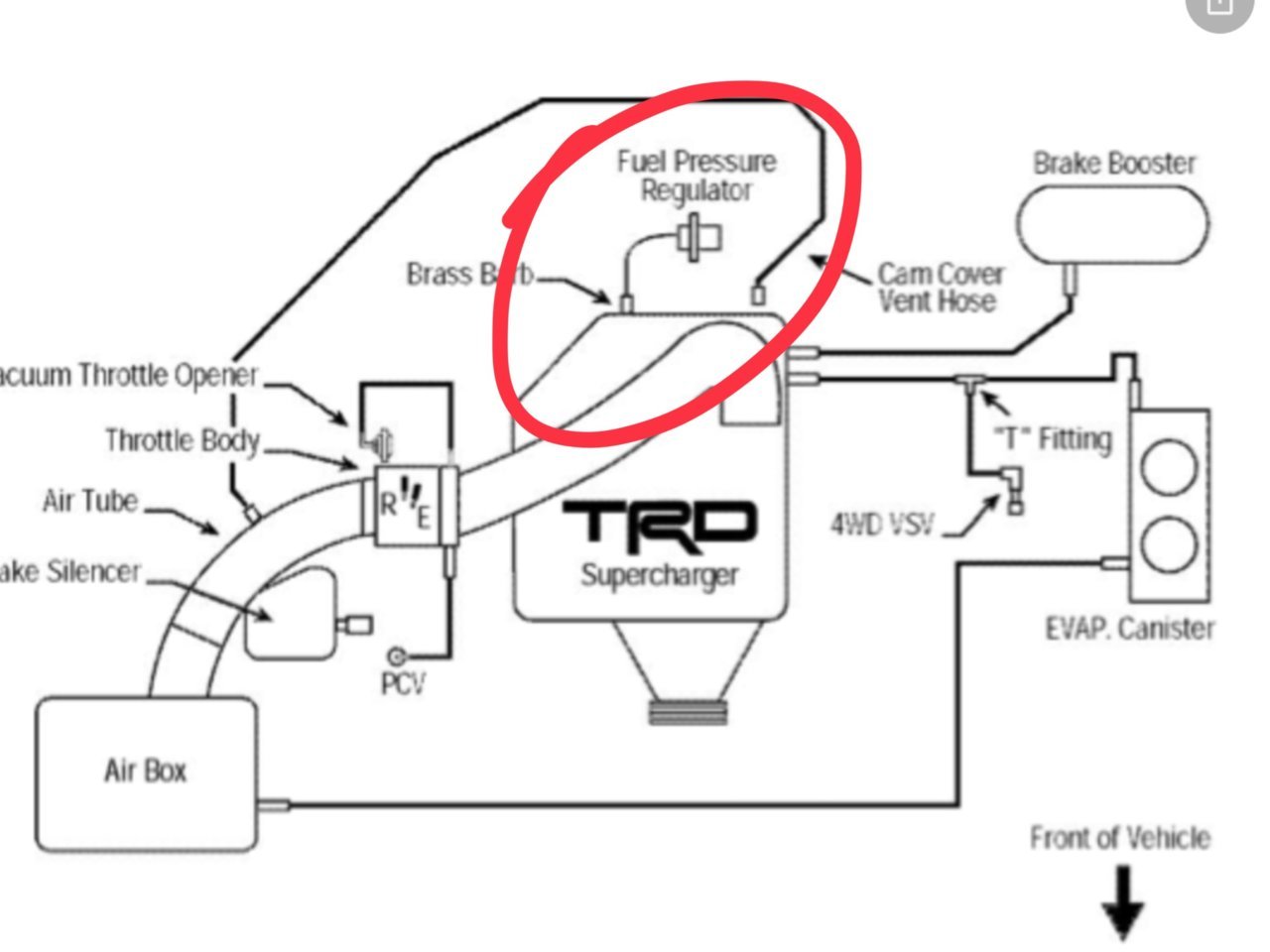

    So cap the FPR first, if LTFT drops FPR is good, if it doesn’t, FPR is bad? Cap the back of the S/C as well right?
    All 3 of my boost gauges are running off this FPR vacuum line, I wonder if that has something to do with it?

    My boost gauge is coming directly off the supercharger vacuum line,
    Maybe reroute those vacuum lines away from the Fuel Regulator line so there is a dedicated line there.

    hx35 turbo, AEM F/IC, Transgo, custom converter, CalTracs, Elocker, 2-4" drop, 4x4 conversion (2023) on a new purple powdercoated fram, 255/55r18 street, 255/60r16 M&H Racemasters, 7.6 at 91
    3.4 FPR only gets clean air from breather. It does not see vacuum. Capping it will do nothing for LTFT.
    My LTFTs are nearly 0 at idle. That's what you target when you tune. I have a spot in my map that the LTFT gets near -10 but I am not worried about it. That's the beauty of electronic controlled fuel injection.
    A bad front bank 02 sensor will cause bad fuel trims. The most obvious choice will be a vacuum leak though.

    I get my boost and Vacuum readings of the line going into the FPR. Thinking about moving it elsewhere
    Like I said fpr does not and should not see vacuum. If that's where you're getting aem fic vacuum from you wouldn't be seeing any, unless it's hooked up incorrectly.

    V6 5sp,RegCab,TVS1320 Supercharger, 56mm pulley, methanol injected Haltech ECU, AC Tvs1320 supercharger,(MUST DO) every 125,000- 150,000 needs rebuild Projector headlights HID 5 speed manual Amsoil for all drive train Smaller 56mm custom pulley, (MUST DO) 2004 DESNO fuel injectors, zero ping ping, 2004 side door mirrors Dick Cepek Rims, Michelin tires LTX, ATM Pathfinders Dynopro ATM ( that last 100,000 miles) Now running Dynopro ATM mud and snow tires KN cold air intake Cat back dual exhaust with ss exhaust tip, Raised exhaust tail pipe to 2" below body line Optima*dry cell battery,red top Alpine sirius radio, 200 watt amp, focal is165 split door pod speakers Focal door speakers Subwoffer behind seat Viper alarm, Electric Locks Dark tinted windows, bucket seats corbeau lg1 Tacoma Rubber floor mats TRD fender extenders, Bilstien shocks, King shocks JBA UCA trailer iv hitch, electric brake control, Drilled slotted brakes, High carbon steel (MUST DO) EBS green stuff 7000 series pads(MUST DO) TRD engine oil cap TRD stick shift, Marlin crawl shift kit. Rear sliding window 2002 4Runner functional hood scoop cut into Tacoma hood, 4Runner dual overhead map light Gentex Auto dim + Compass + Temp, garage,rearview mirror Snow Methonal kit stage 2 Custom 3 core aluminum radiator Linex bed liner Haltech stand alone ECU, Intake supercharger gauge. Stainless steel brake lines, Custom leather wrapped steering wheel, Haltech stand-alone ECU,
    I think his supercharger shows vacuum from the supercharger barb to the FUEL REGULATOR
    Ok if that's the case then that port should be boost only. Somebody correct me if I'm wrong but that port still won't see vacuum.

    2000 4runner, 1996 Tacoma
    It will see vacuum and boost on a SC setup.

    Have you setup the Fic yet?
    My source is in the same spot, you are good there. Maybe ditch 1 of your boost guages so there is less draw, probably not an issue tho.

    Update
    LTFT are down to +10 at ideal and +3 in boost
    STFT stay between +2 and -2
    Unplugged all my boost gauges
    HOWEVER, now something new
    I got some engine fluttering at 70 mph 3700 RPMs...weird
    Only happened twice then stopped
