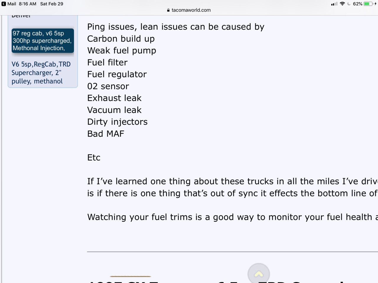

    Bad trims can be any of these issues
