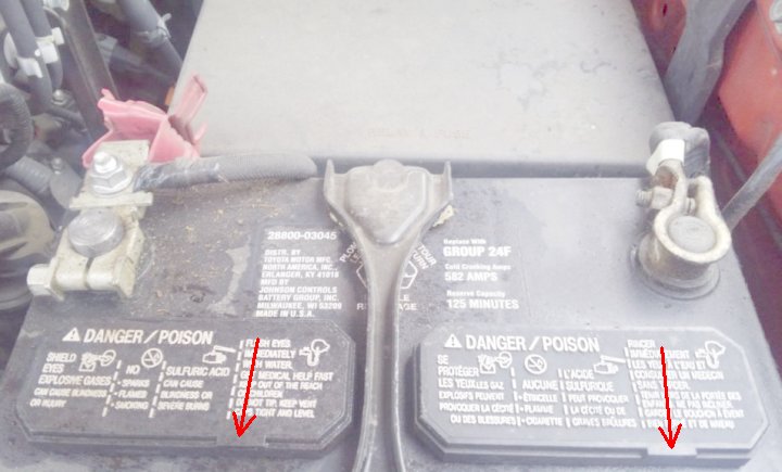

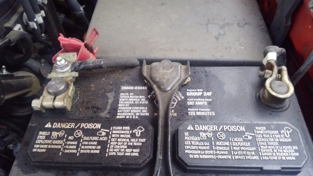

    There are vent slots on the battery that allow the acid to spill out, so corrosion in the vicinity battery can be expected.
    Watch for inner fender corrosion if the acid makes it that far.
