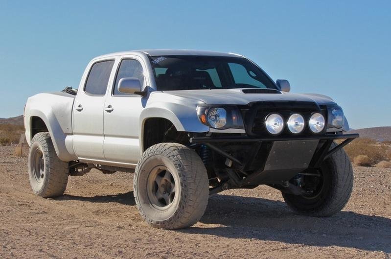

    Since money is not an issue, Pull the OEM fenders & bedsides picking up some flared versions.
    http://fiberwerx.com/listing/05-11-toyota-tacoma-one-piece/
    http://fiberwerx.com/listing/05-12-toyota-tacoma-crew-cab-tt-bedsides/
    Next pick up a long travel kit
    http://www.offroadshocks.com/product/86000-H.html?gclid=CJTk7byNz78CFUZbfgodfaoAHQ
    Better be good at fabrication or pay someone who is. Weld in some tubing supporting the larger shocks and springs to handle the tires. You are moving significantly higher wheel mass than OEM spec. Expect to tune in the suspension to the desired feel you are after swapping out springs and shock valving. When done you will have effectively built a street trophy truck for the purpose of running larger tires. I would guestimate your will have spent another $10K by the time you have done it right.
    If you get to tall you loose functionality. If done right you get one heck of a fun toy. Be prepared to pay to play.
