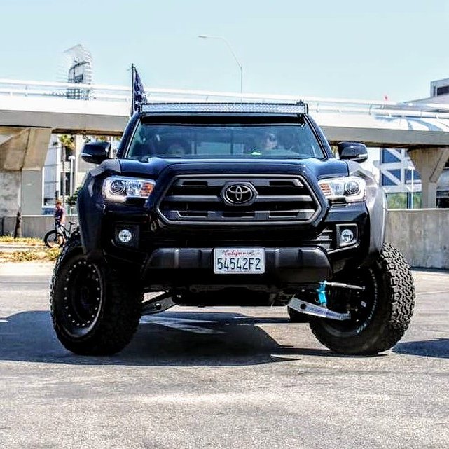

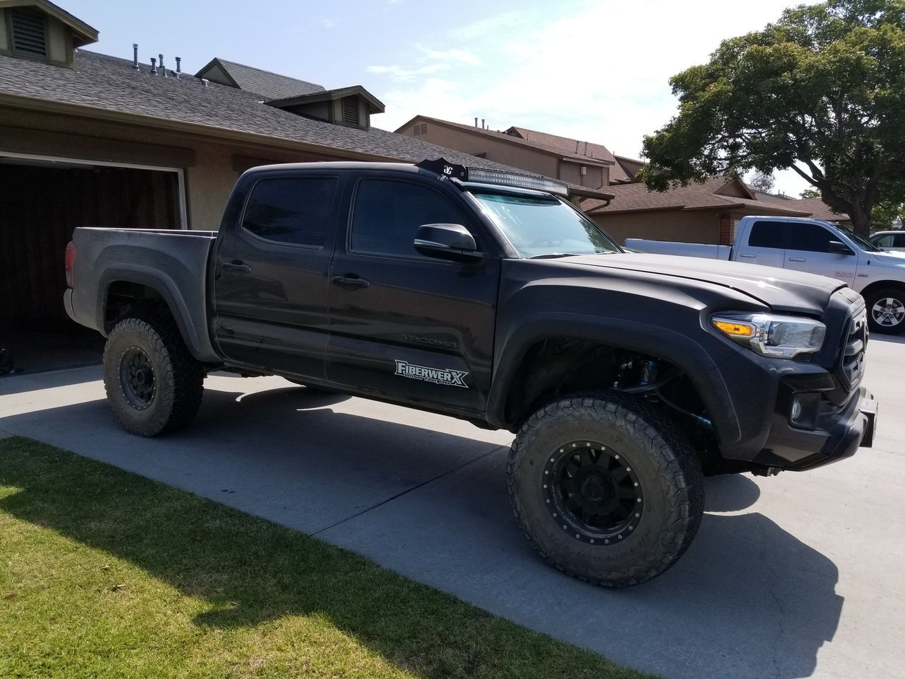

    20170629_192518.jpg Currently building my 3rd gen taco. Love to here about anyone else going through this or if anyone has questions . 20170709_095300.jpg

    And back to the subject at hand, bed cage for sure. I also don't see a spring under or 3 link/4 link setup. Most hardcore LT'ers will not consider that a full LT setup. Always best to do rear before the front but up to you. Get the bed cage ready and continue to save for your choice of rear LT and then focus on bypasses and or coilovers if you run a linked system.

    Fantastic! I thought this thread was about you deciding on stock or extended length bypasses lol At this point it's up to you to decide what you want, you'll need both. I would go with bedcage first, you can keep your stock shocks and leafs on for now as you test for it and then purchase the right bypasses for the exact length you'll need between the custom bedcage mounts and axle after you install the SUA kit.

    Yeah I should have been clearer. I all ready have the 3.5 long travel kit through total chaos, with 2.5 king R/R coil overs. Rear is king remote res extended travel with Icon leaf pack. Just till I do my SUA I was torn between jumping into doing the SUA or finishing the front by adding my secondary triple bypass.

    Rear, rear first. You've got good quality Kings up front for now, I think the secondary bypasses can wait a little. Get the rear settled, tested, etc with the new bypasses, bedcage, and SUA kit and then come back to the front. Those front Kings can handle plenty before you need the bypasses.
