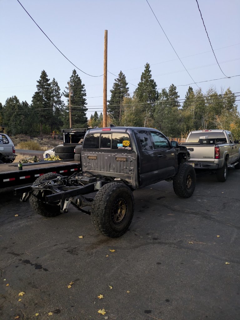

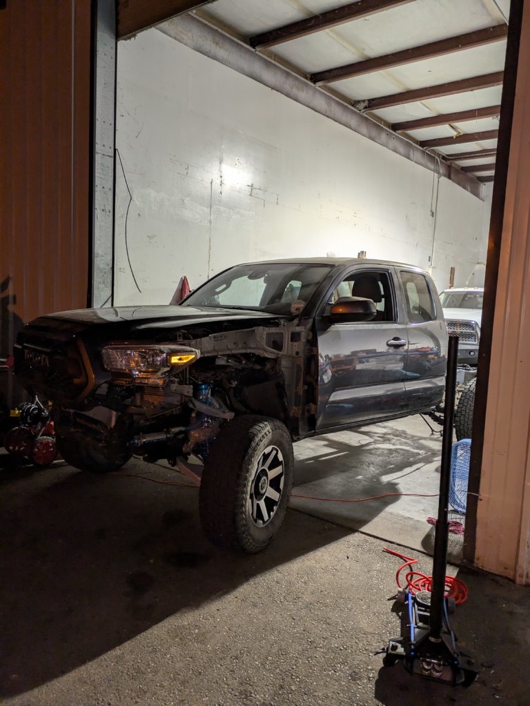

    I finally got bigger tires 2020 Long Travel Tacoma 1997 MAGNUM
    Those are custom made by @Sterling_vH111

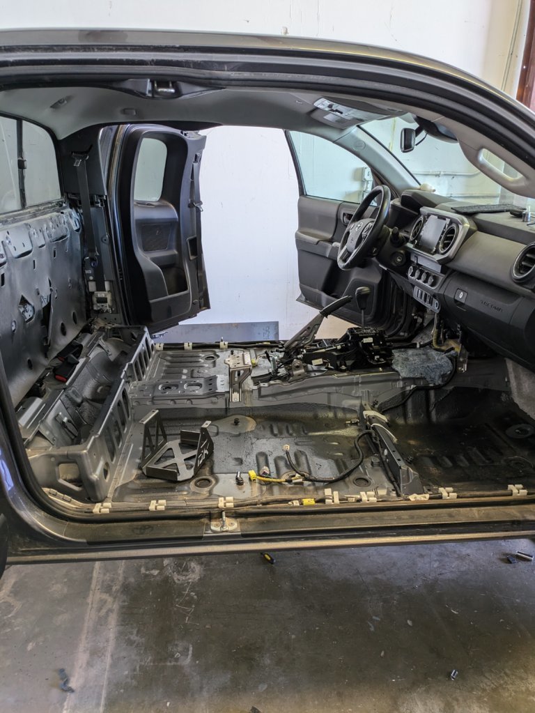

  2. Sep 2, 2024 at 4:32 PM
    #22
    SoonToBeOn39s
    SoonToBeOn39s [OP] Well-Known Member
    Mar 20, 2022
    #393038
    1,876

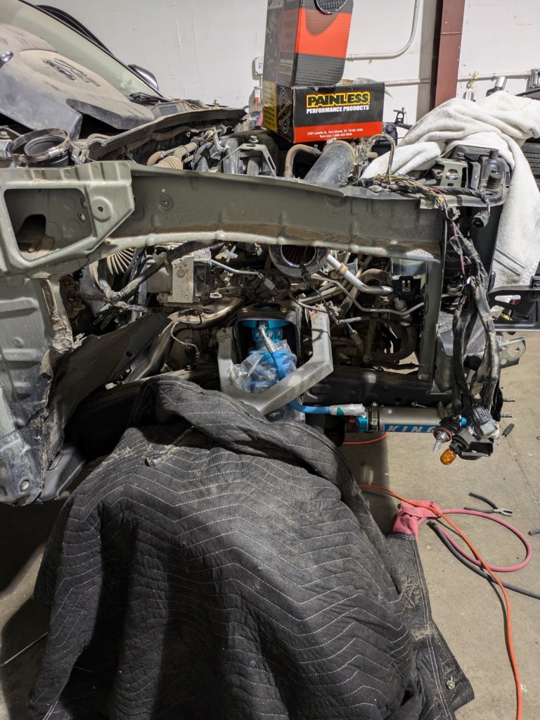

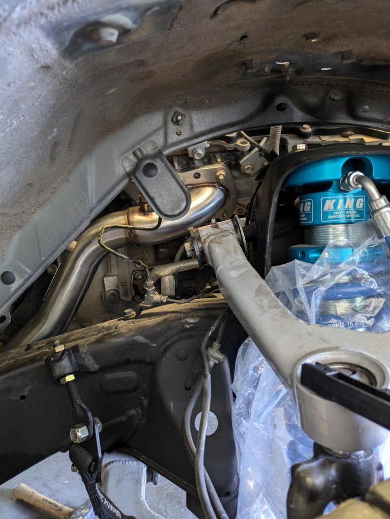

    Dump tubes installed
    Interior striped for wiring of battery

    Does it sound like dump?
    It sounds like shit lol. My goal was to make it stupid loud and I succeeded

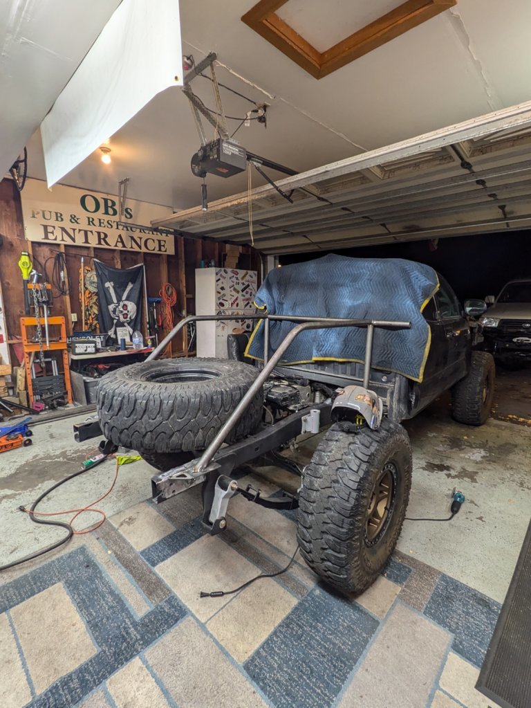

  5. Sep 2, 2024 at 9:24 PM
    #25
    SoonToBeOn39s
    Mar 20, 2022
    #393038
    1,876
    No turning around now...

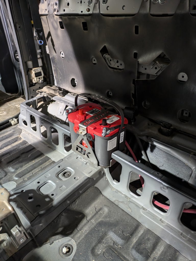

  6. Sep 3, 2024 at 1:50 PM
    #26
    SoonToBeOn39s
    Mar 20, 2022
    #393038
    1,876

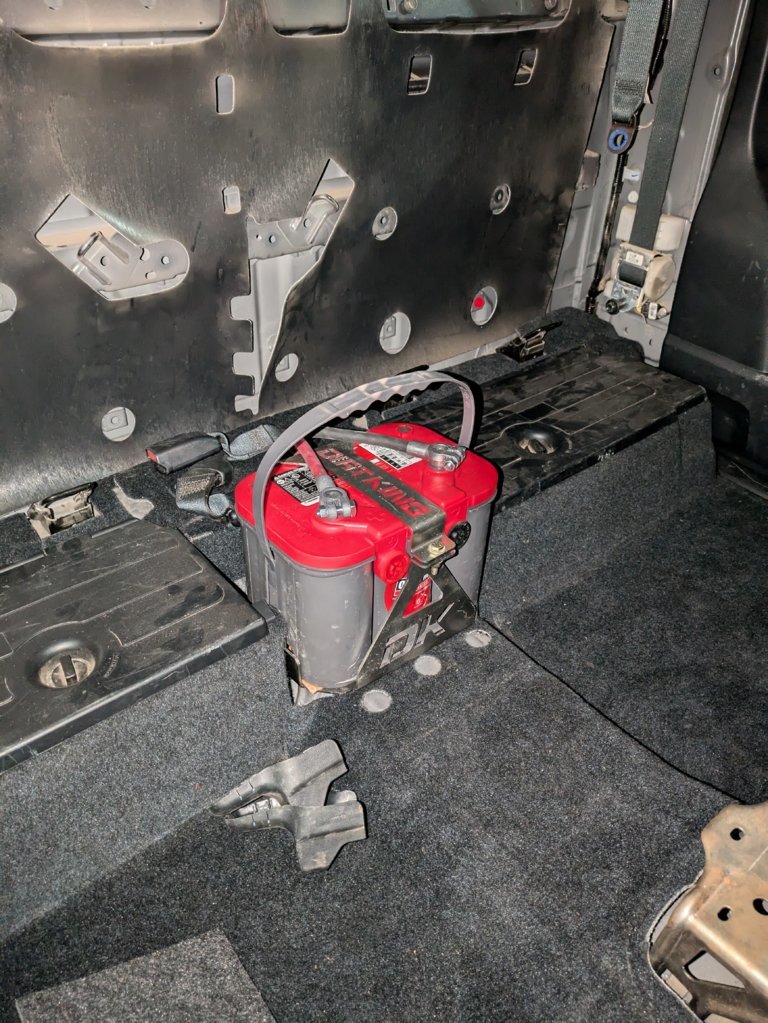

    Was going to put the battery behind the passenger seat, but the chance of carrying passengers is pretty high.

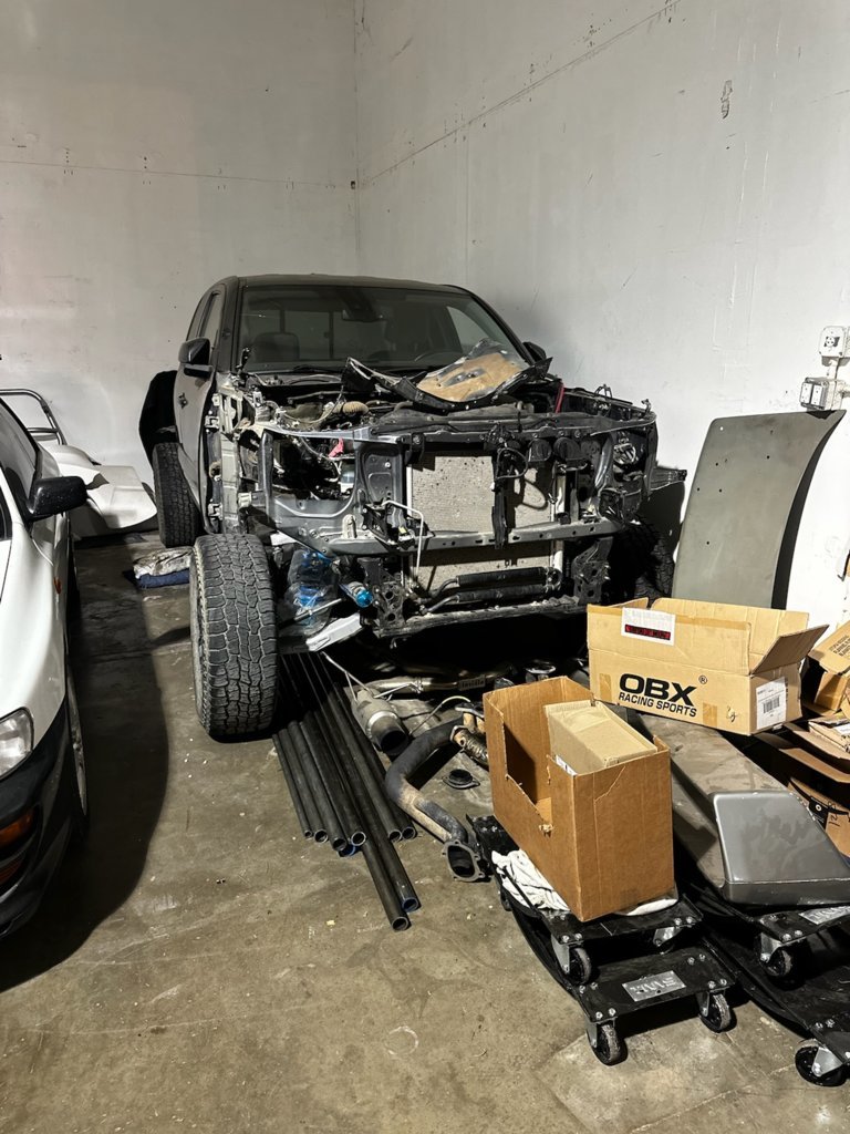

  7. Sep 16, 2024 at 8:56 PM
    #27
    SoonToBeOn39s
    Mar 20, 2022
    #393038
    1,876
    I have the metal for the bedcage/back half cage??
    Truck is getting ready for it's final assembly, CV axles, driveshaft, reinstalling the interior, paint match, and buttoning up the new fender wells (or lack there of)
    Dirtking spec 16" bypasses are on their way for the rear end too. Should be looking super different here in the coming months.
    IvanhoeTaco likes this.

  10. Sep 16, 2024 at 10:23 PM
    #30
    SoonToBeOn39s
    Mar 20, 2022
    #393038
    1,876
    I paid $5.25 per foot for 1.75" x .120 wall. I forgot how much I spent on the 1" tube

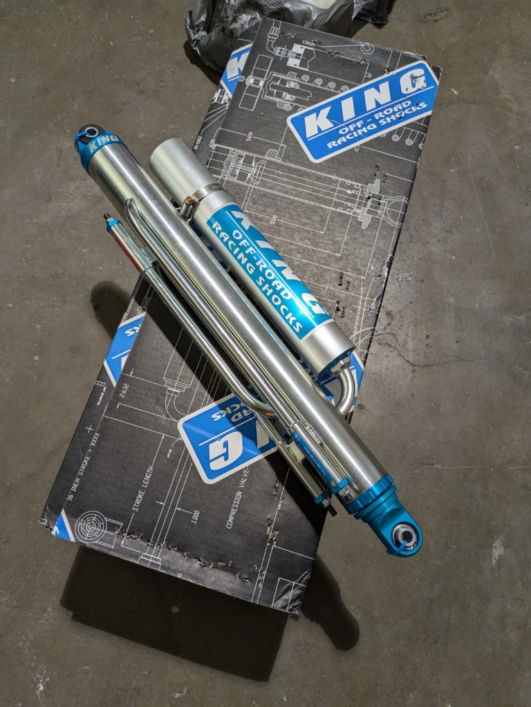

  11. Sep 20, 2024 at 12:41 AM
    #31
    SoonToBeOn39s
    Mar 20, 2022
    #393038
    1,876
    Rear shocks are here
  12. Sep 21, 2024 at 11:20 PM
    #32
    SoonToBeOn39s
    Mar 20, 2022
    #393038
    1,876

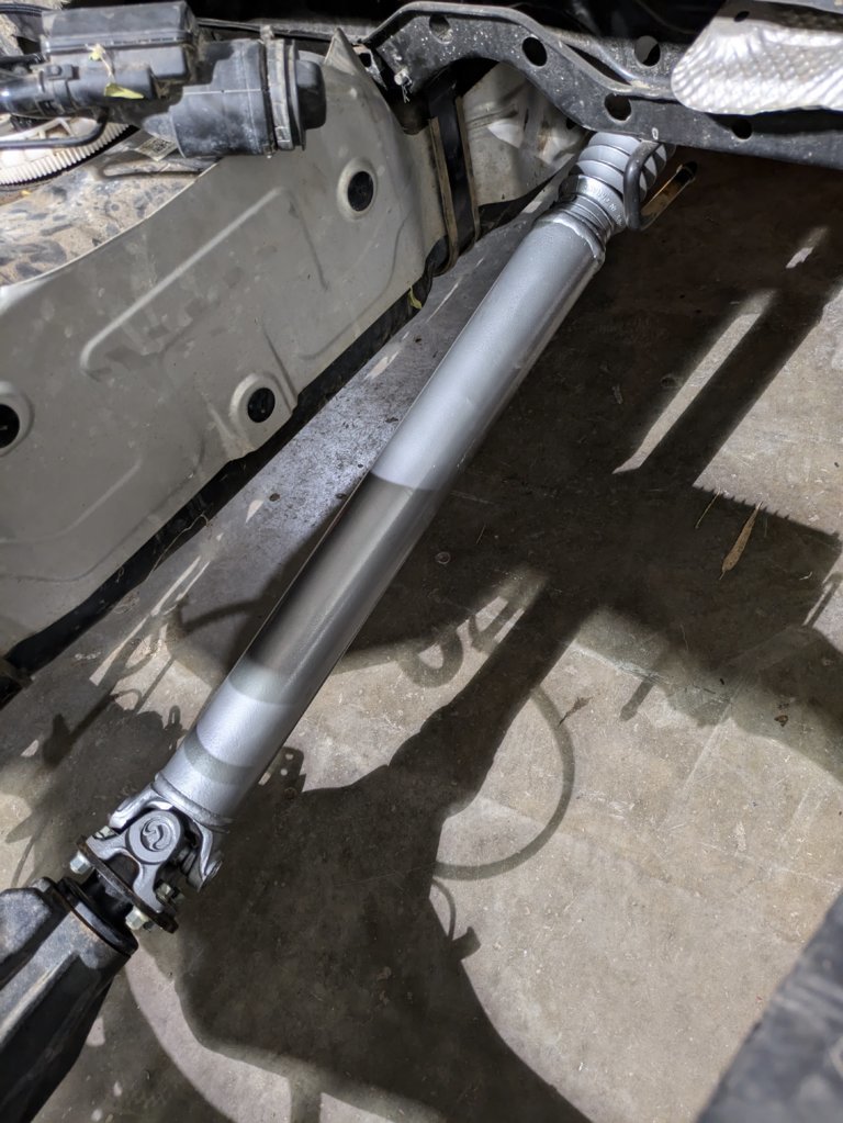

    Got the truck able to drive again.
    Idles like shit, sounds like it has a fat cam in it, but no vacuum leak. Most definitely the missing cats that make it run like that.
    New driveshaft is in, took it for a spin in our shop complex, but truck vibrates bad anything above 10MPH. Thinking the driveshaft shop didn't balance it after shortening it.
    Battery relocation is 100% finished. Clear coated the battery tray. Looks super good after seeing it all put together.
    Everything else is going good, off to get the bed cage fabbed up in a couple weekends.
    Just need to figure out a couple kinks in the truck. Last update for a bit

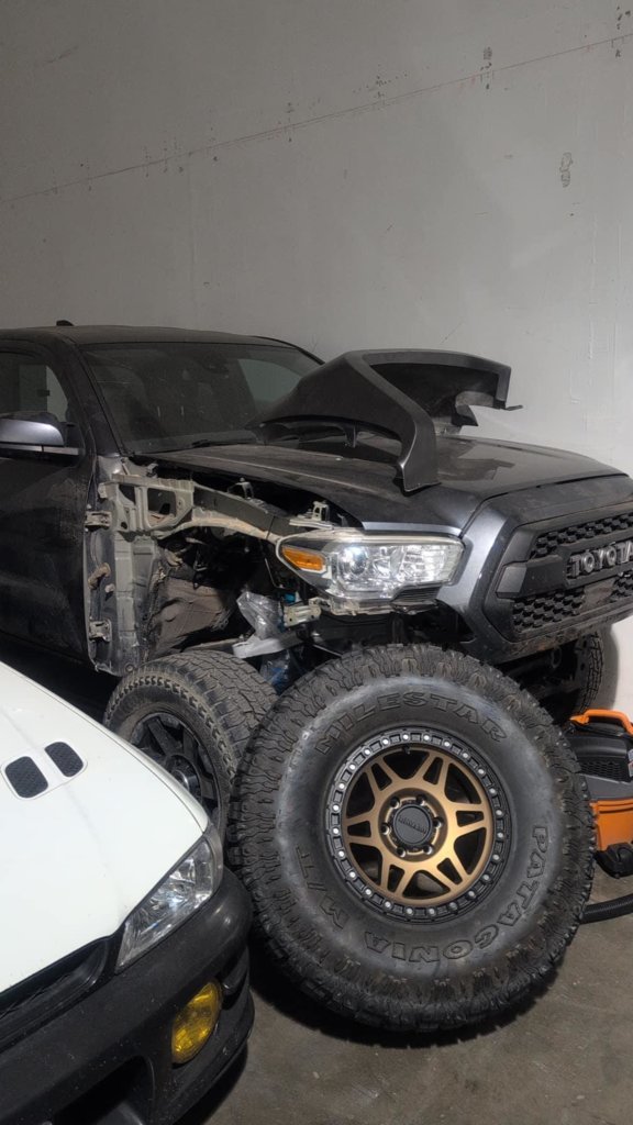

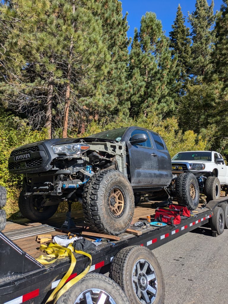

    Well finally got a set of wheels of tires.
    These milestar 38" tires should fit like a glove :rofl:
    Will most likely change wheels soon, but can't beat a good marketplace find!

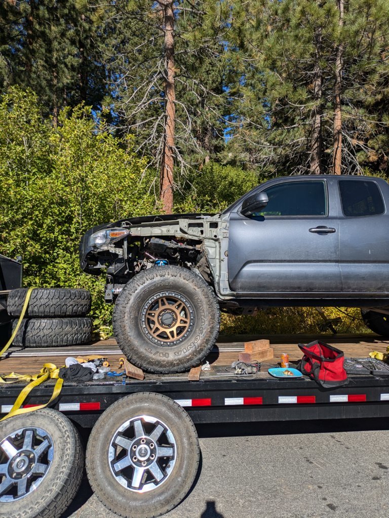

    After tracking down a lug nut spline key, I finally mounted the tires. All I can say is this is thing is massive.
    Looking forward to seeing what holds up in the front end lol

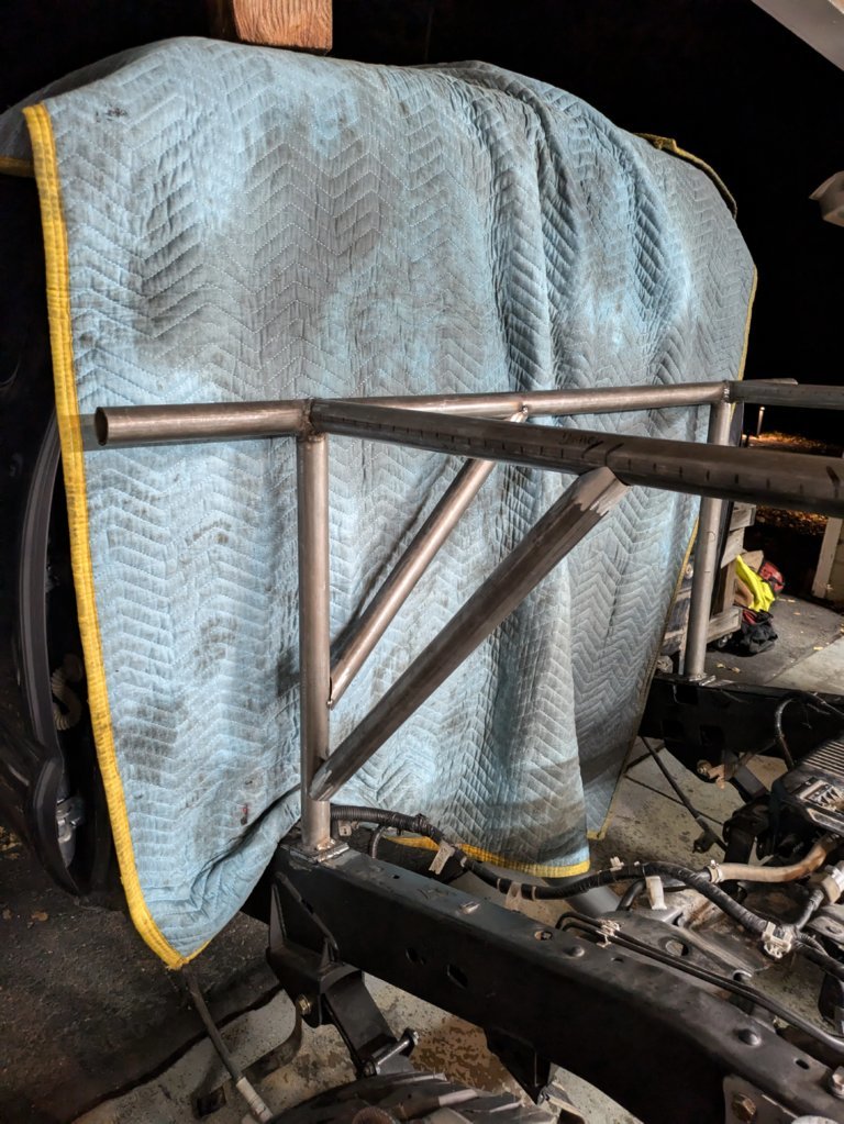

  20. Oct 11, 2024 at 10:46 PM
    #40
    SoonToBeOn39s
    Mar 20, 2022
    #393038
    1,876
    First 2 of 6 v braces done
    CemenTRDgen and Superdave1.0 like this.
