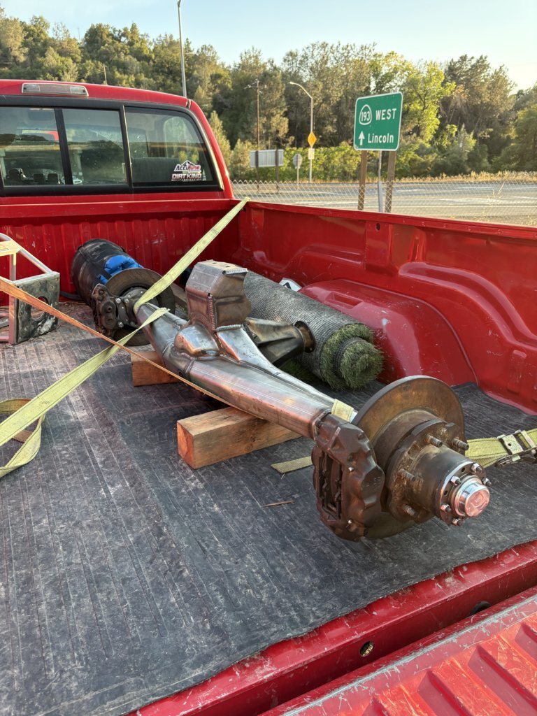

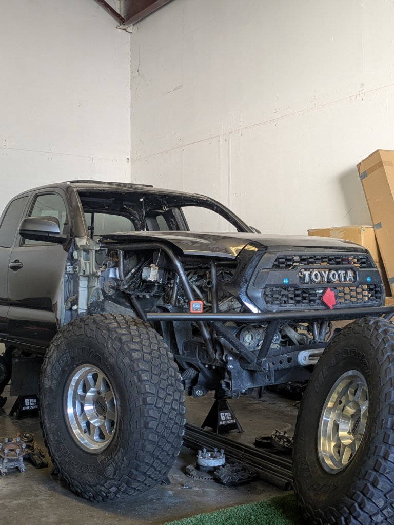

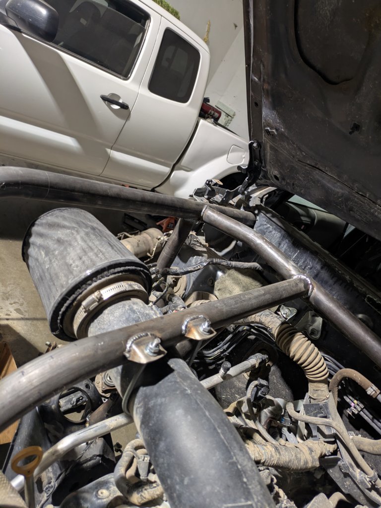

    Made some more progress in the last couple weeks.
    Engine cage is completely welded, minus all the supports for fenders, headlights, grille and hood.
    Got my new 3rd member regeared with Nitro 5.29
    I also picked a new Toyota 8.4 axle tonight.
    Specs:
    Front range full float
    Front range chromoly axle shafts
    Custom truss
    Disc brake swap
    I’m going to throw my new regeared 3rd member into the new trussed axle I bought

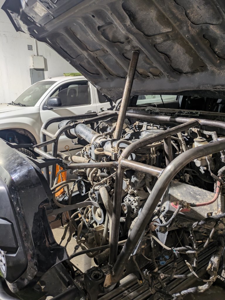

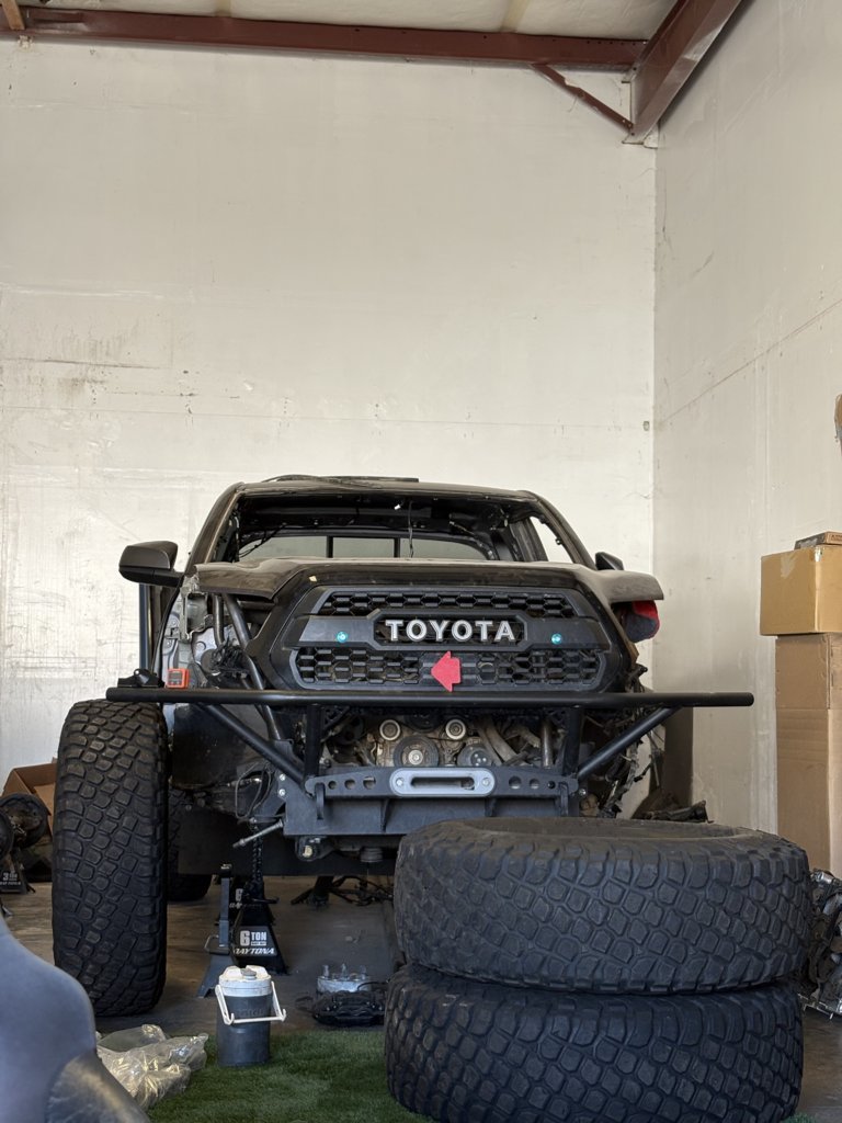

    I finally got bigger tires 2020 Long Travel Tacoma 1997 MAGNUM
    Here are some more pics of the engine cage

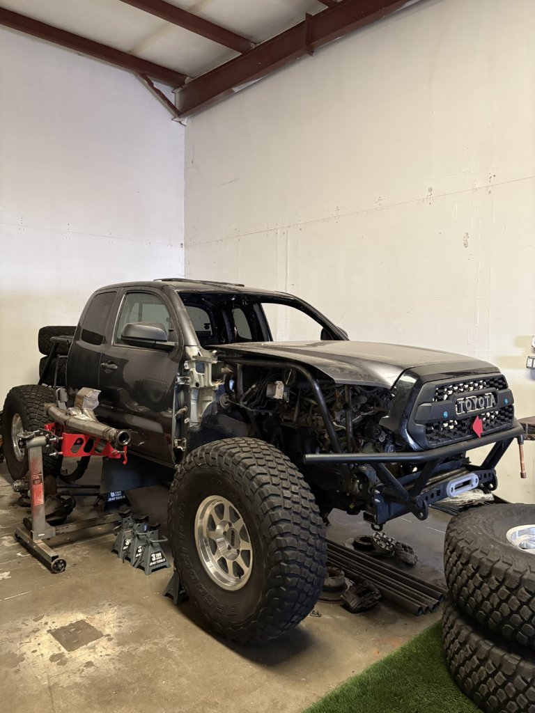

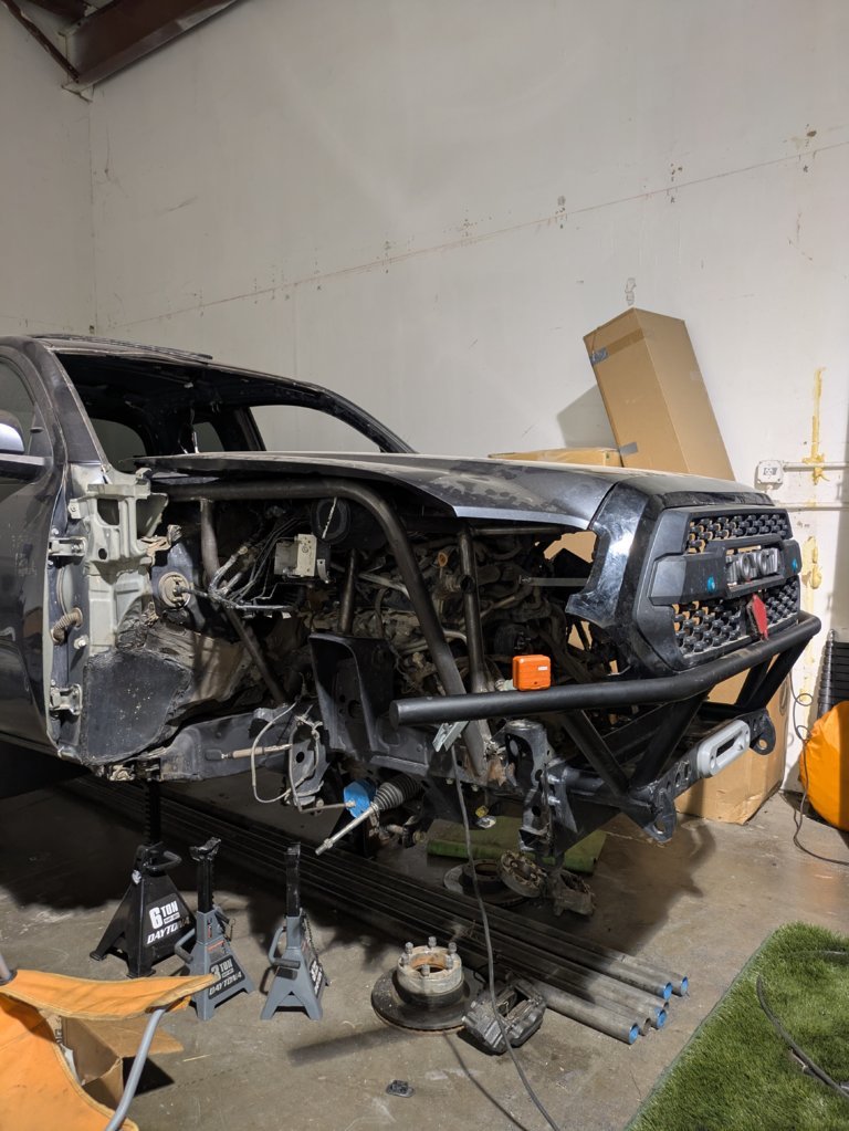

    1,876
    Successful weekend. Striped more of the truck apart, tore my new axle apart, getting it ready for the new 3rd member.

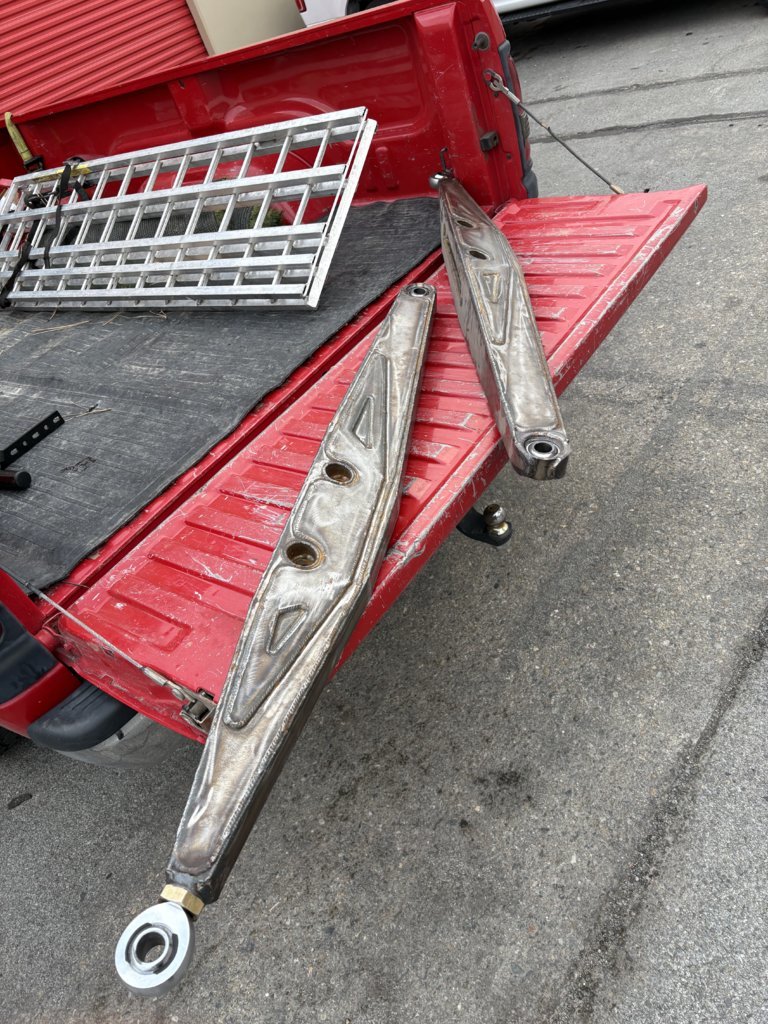

    I decided to 4 link this truck, picking up some 52 inch trailing arms Tuesday. Going for a triangulated 4 link with a mix of Ruffstuff brackets, upper links, and custom tig welded trailing arms.
    Not sure on the travel number goals yet, but hopefully it’ll pull more than the DMZ kit.

    54 inch trailing arms have been secured
