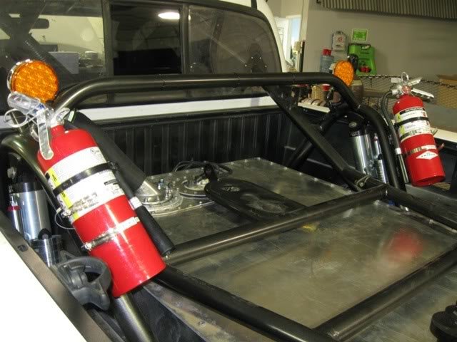

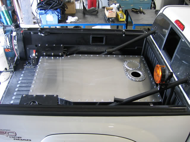

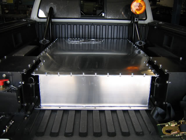

    Yep.
    It's around 60 gallons, but on the plus side I'm running the stock fuel pump and sending unit so wiring everything up is a snap.
    It's worth mentioning that having the custom bladder made for inside this thing cost more than buying a complete off-the-shelf race-legal fuel cell with pump and sending unit.
    Custom = $$$$, so try to make the readily available stuff work first.

    Do you have more pics of your entire truck, looks bad ass! Damn thats a huge tank, and I thought mine was big at 32G :D

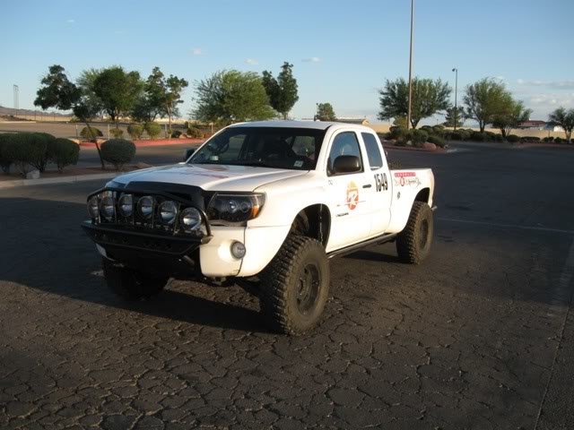

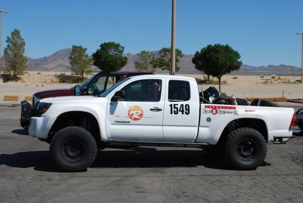

    A couple.
    These days it's under a pile of dust in the driveway until I get the time to fix it again.

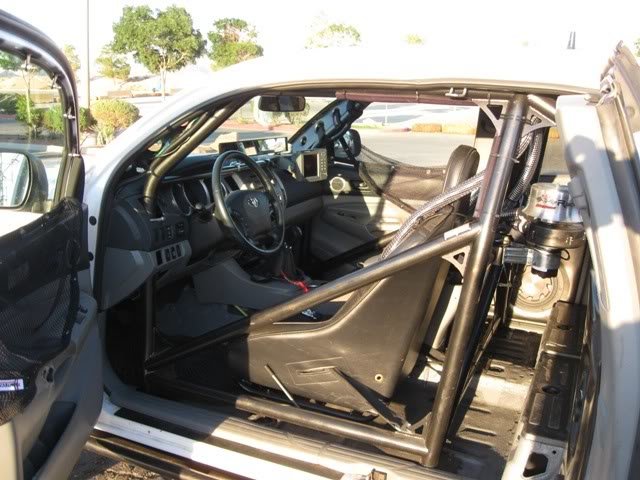

    Did you lose your AC or just those side vents?
  8. Jul 11, 2012 at 8:39 AM
    mjp2
    mjp2 Living vicariously through myself Moderator
    Feb 16, 2007
    #924
    22,016
    Milton Juevo Portimous II
    NJ
    Current: '21 Bronco Badlands. Previous: '06 TRD Access Cab, v6, 6-speed
    Just the side vents. A/C still works fine.
  9. Jul 11, 2012 at 8:41 AM
    ocherp
    ocherp Well-Known Member
    Apr 19, 2011
    #55170
    820
    Gilbert, AZ
    2016 V6 4X4
    SDHQ built
    Nice, I like your interior set up

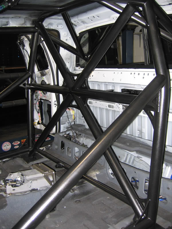

    Thanks. :)
    Better pic of the cross bracing for the main hoop, just because.
    It's all 2" .120 wall chromoly.

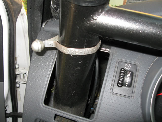

    Not at speed. Only during some sketchy rock crawling.
    I needed the cage to race. This is my favorite mod:
