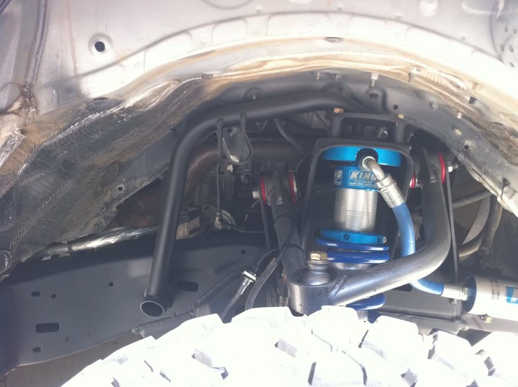

    Wonder if shock misalignment spacers would work or if we should just start over with new spindles... :notsure:

    I see the three bolts but maybe he just put them back on because I'm positive that i dont see anything else there lol
    See here DTFTacoma has the same thing but it connects to another plate which goes to those three bolts.
    This is what i was thinking of but the pic above seems more related:p I guess there are multiple ways of mounting the shocks.

    could get someone to machine you a spacer ....we need measurements first

    that thing was built right here in san diego by donny stenger of stenger built...intresting guy to say the least lol
