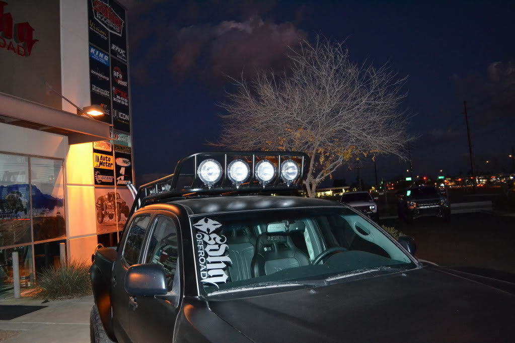

    I saw the truck on there facebook page that thing is sexy

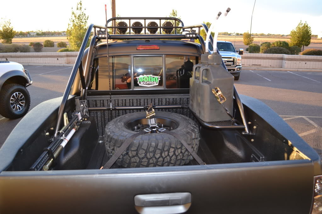

    I love that bed rack!

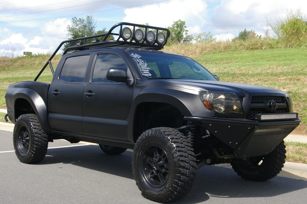

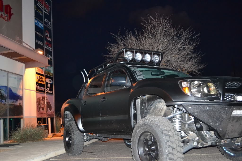

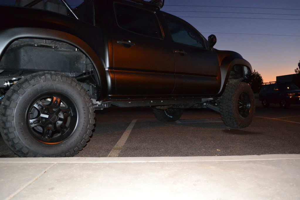

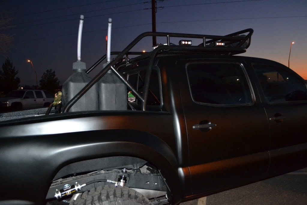

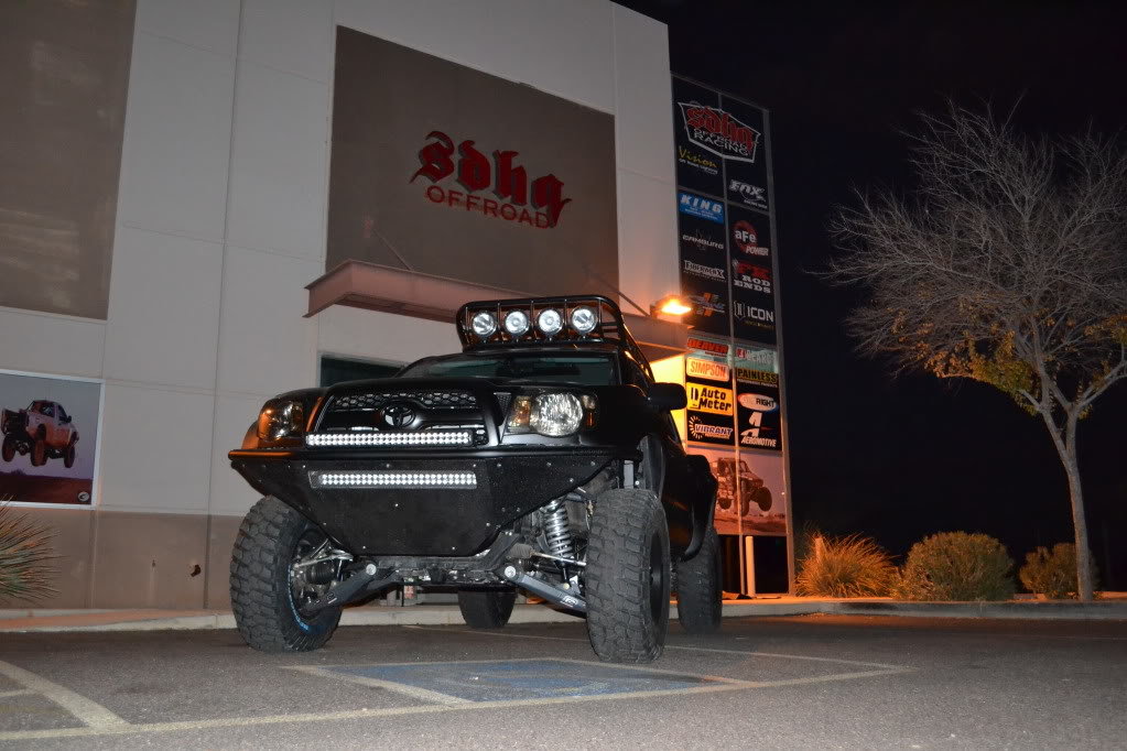

    I have more if you guys want to see them :D She for sale now clear across the country

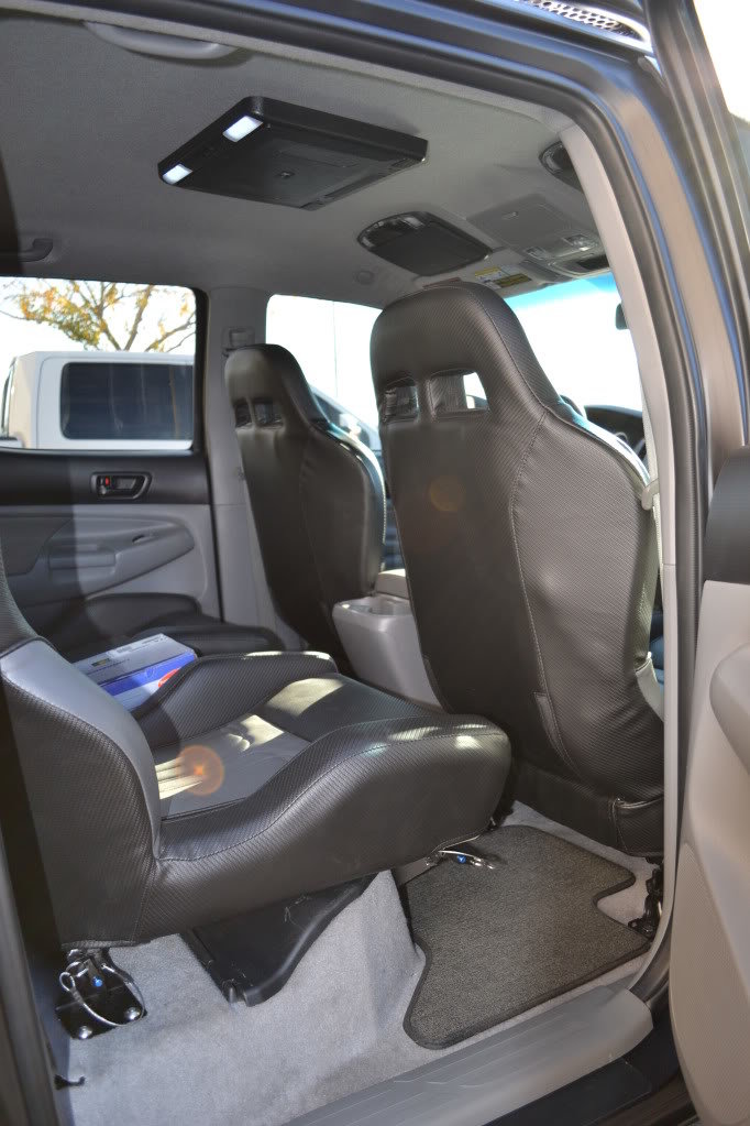

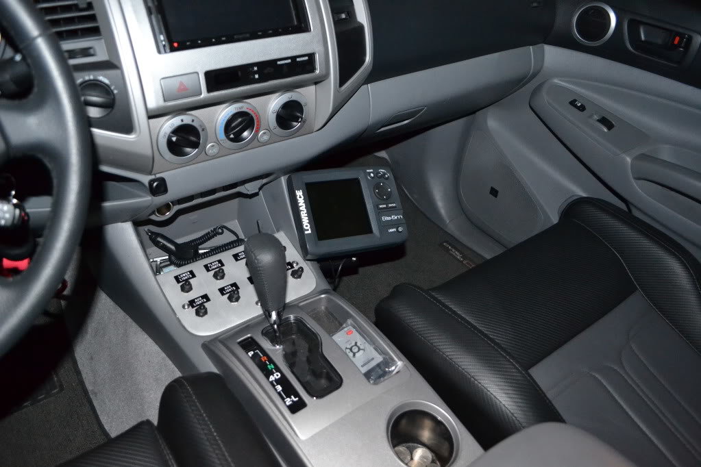

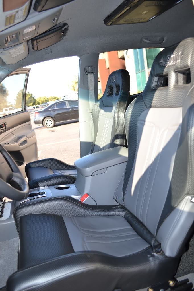

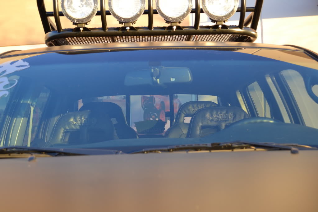

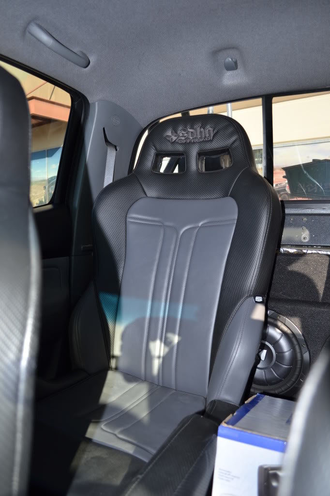

    Now where do the big-gulps go? :D
    I like those seats who makes em?

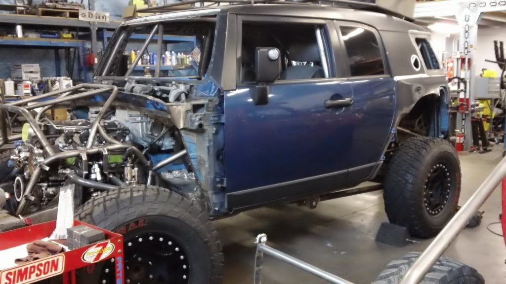

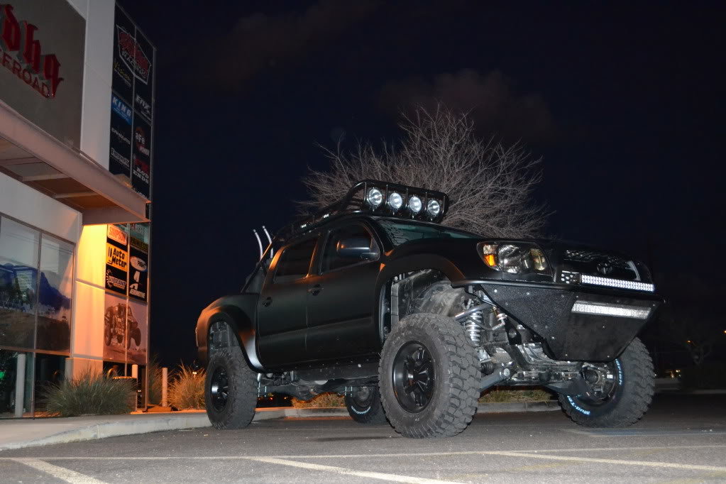

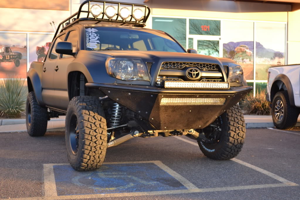

    some of you might enjoy this one too

    Why no double shear on the upper arms?

    double sheered on the back joint where most of the load is exerted on the UCA. Most of those UCA gusset kits are for reinforcing the OEM shock tower more so than the joint, and with ours 100% removed and rebuilt and gusseted it only would have made removing the UCA bolt more difficult if the bolt ever had to be replaced on the trail or to adjust or replace the heims

    Ahh I see the rear one now, makes sense
