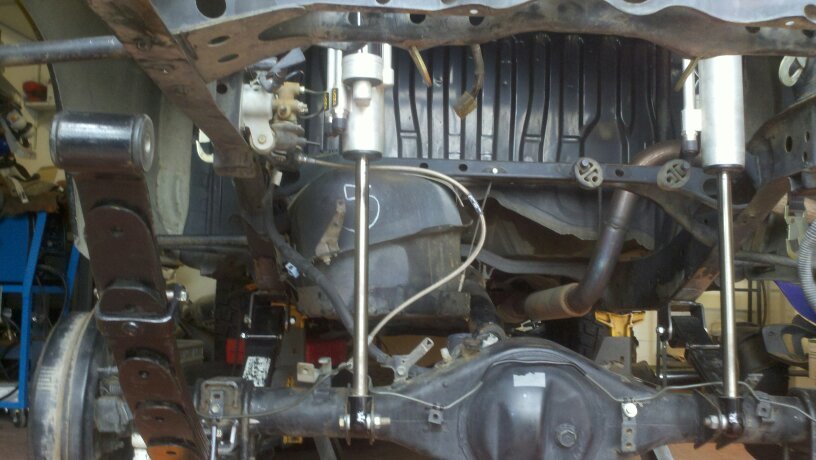

    For the 1st gen guys rear LT, what did you do with the Hieght adjusting brake valve next to the frame? My buddy just installed 50ts and shocks are in the way of the valve.

    My shocks are set center more enough to clear the valve

    Mine clears.
    If you need space, swap it out for a regular proportioning valve like JD did.
    What's going on there with the exhaust?
    Is it routed up and over the frame and dumped out the side?
    Also, it looks like a work in progress, but I would definitely suggest gusseting and plating up the frame on the main spring hanger. Having it just welded to the bottom of our frames is a bad day waiting to happen.

    Mine cleared because my lower shock mounts are so far off the back of the axle, but yes I still just took it out anyway. For about $70 you can actually control how much rear brake you get. That stock valve goes to a maximum of something like 37% of brake power and the aftermarket ones go up to something like 60%. I can actually feel the rear wheels bite now but not enough to lock up
