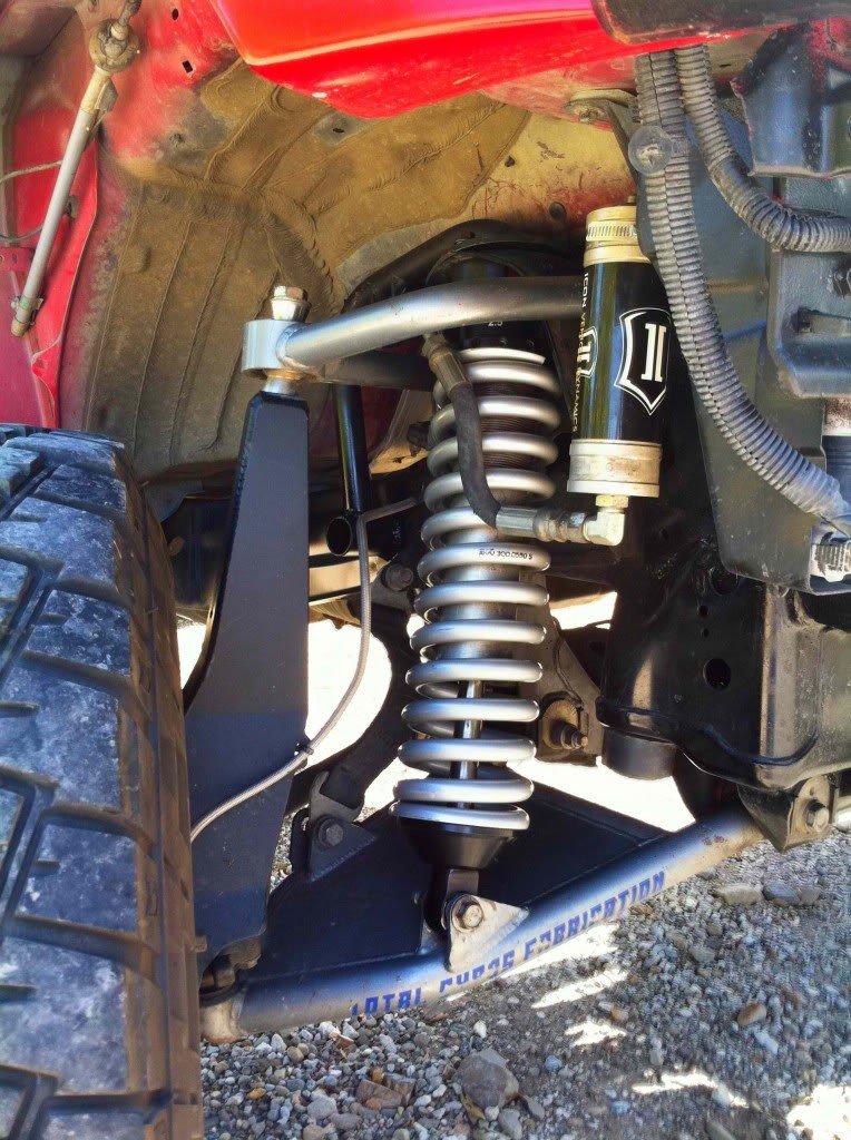

    Depends on what lower spring retainer you're using. I have a tapered retainer to clear the 4x4 axles so I'm using a 16" spring. Nelson on the other hand has the flat retainer and is using 18" coils.

    my 8s had 18s with a flat retainer. when i got the tapered retainer my springs wouldnt fit on without compressing the spring. so 16 with the taperd.

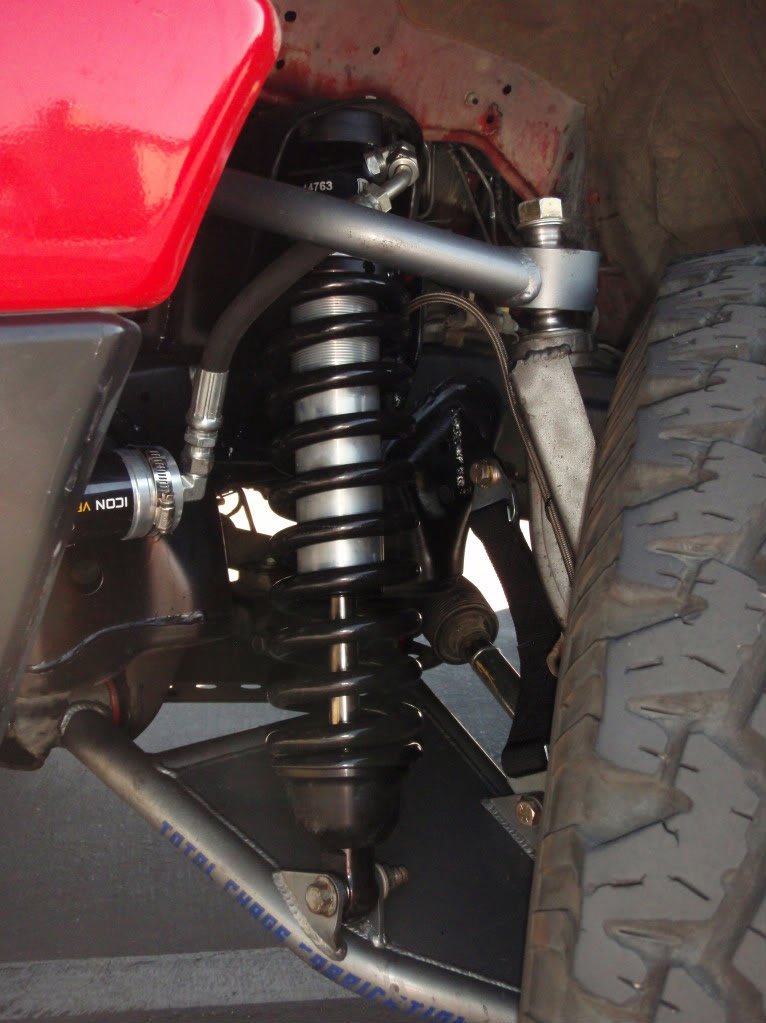

    yup. 16" came with my shocks originally. when i dropped spring rate i got new lower retainers and 18" springs

    you have to take into account the block height of the springs and how much travel your shock has. If you're running a 16" 500lb spring and need to crank it a bunch, the spring will bottom out before your shocks. if you run a 18" 500lb spring it will have more travel, so you have more wiggle room with preload
