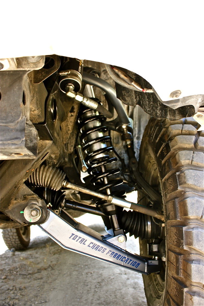

    wat to u mean stock body? u mean stock fenders?
    Edit: and the pic is in dirt. and the inside wheel well shot could have been it flexed out a little so the cv angle might look steeper then wat it really is at ride height

    is that the 2" kit? nice to see another dude running Icon & TC LT :thumbsup:

    That shot was when I was flexing on the side of the hill which is why the CV looks maxed, and it is the 2" TC kit, glass will come soon enough, along with the rear end of the truck getting fixed up.

    Im loving the Icons, My buddy works there so I had to..... Hopefully glass, rear end, and omegas are in my future!
    edit: I have the spindle gussets sitting in my garage right now, just need some time when I can take care of them

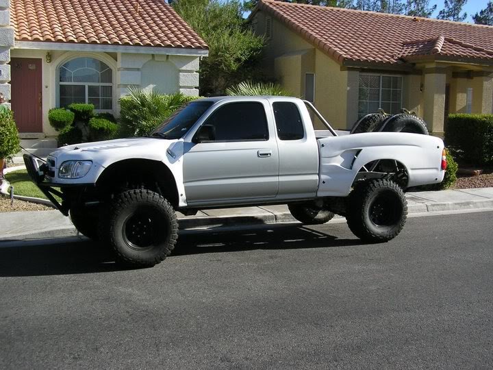

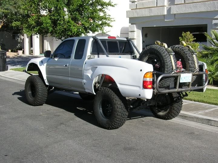

    the 2 smallest leafs were already removed when i bought the leafs. even without those leafs the arc of the pack was huge. just left them out not wanting too much lift
    here are some old pics of the TPF truck. he's running 50T, no leafs removed and has that much lift with 2 spares, fuel cell, cage work, and i think his battery was back there too

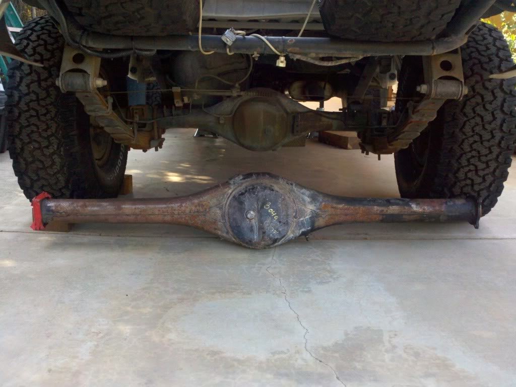

    Does not look pretty right now, but dropping it off to DMZ this week to motivate him to start working on my truck :)
    T-100 axle going to run 4.88

    nice dude. where did you score that?

    DR for 150.
    2 small issues with it:
    1. No rear brakes. So i may not run e brakes for the short term, or maybe try to see if the taco brakes will work. but then the taco brake lines will not be long enough so most likely option 1
    2. The third it came with is a 10 bolt, low end gear. So since i want to run 4.88 i will need to add a gear ring spacer. only problem is no one makes it for this axle, so i am going to have DMZ make one out of 10 gauge.
