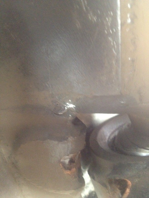

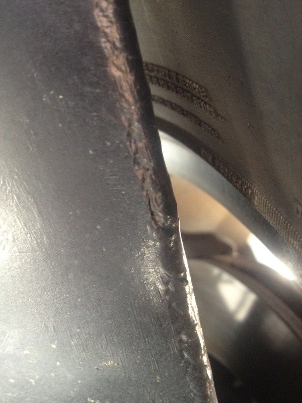

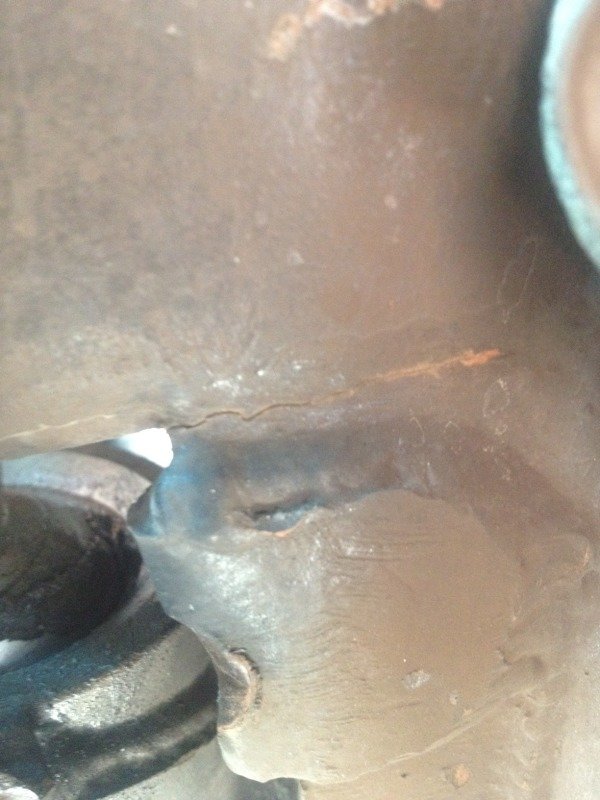

    What is hitting the spindle to take chunks out of it? looks like whatever it is is what's causing the stress...

    It is the LCA binding with the spindle at full steering lock. The side plating of the double sheer makes contact with the LCA uniball cup. Im gonna find a way to strengthen that part on my 4x4 spindles or make a steering stop that stops the steering before it makes contact with the part.

    Ah ok. Well hitting a rock at close to full steer and it jerking into the spindle will probably eventually cause cracks like that... part of the reason why i make sure i dont over steer on my kit now with the stock spindles...
