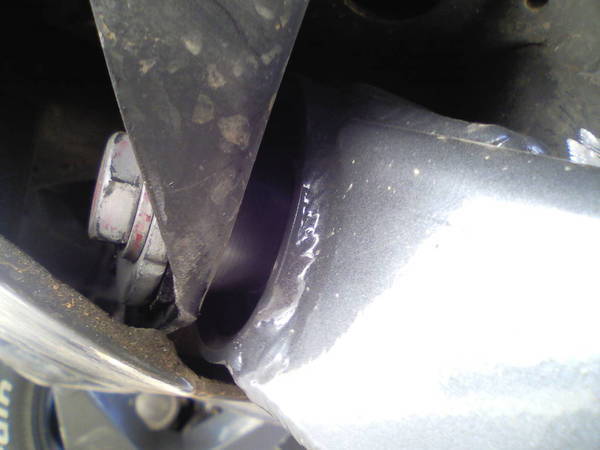

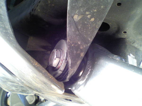

    When the uniballs get loose you may feel some vibration. Im not exactly sure what camburg is doing for the lower uniball pivots. If I picture it right i would thing there would be a ton of play but I know of a couple of race trucks doing that as well. Unless its more of an anti wobble setup.

    The camburg lowers are just massive uniballs with inserts that fit exactly to the alignment cams and the width matches the lca mounts. They have no play. I'll take a pic of them. Im not sure how there could be slop until they wear

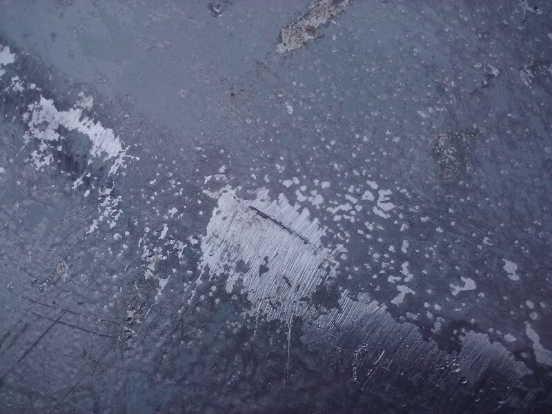

    So i started cleaning up the lt kit to check for any cracks or damage and i found this little crack. Should i worry about it, or just weld it and grind it down? Also should uniballs be hard to move or easy?

    Looks like normal uniballs to me. Maybe cause theres 2 side by side it doesnt give any wobble movement?:confused:
    what kit is that? Personally if you were to just weld on top I don't think you would get enough penetration to actually fix the issue. Don't know if this is the correct way to fix it since I'm not a fabricator or engineer but I would get a grinder and grind out the weld. It would make the slot about 1/8" wide or slightly less. It will give you a groove to get a deeper weld and hopefully it wont crack again.

    My bad its the engage LT kit

    Go to homedepot/lowes and get some paint stripper or if you have a wire wheel for the grinder knock the paint off on as much of the arm. Kinda hard to tell on that if its actually a crack. But like I posted earlier. I would try grinding down about an 1/8-3/16 depending on the thickness of that plate. But you don't want to go down too far and destroy the rib in the arm. Then re-weld it.

    ^^ Ill get some paint stripper from work tomorrow. It is a crack because i can stick my fingernail and feel it.
