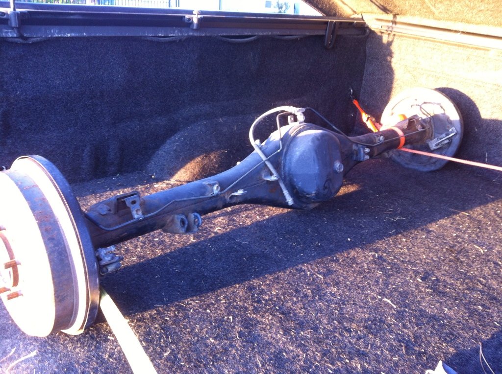

    hmmmm tundy? or t100?

    Tundra...in the bed of a Tundra.....

    the 8.4???

    Of course.
    The 9.5" and the 10.5" are that retarded 5x150 bolt pattern. Would be as much as a Ford 9" to make it work.

    hmmm i do like my women a little wider in the rear end... its like +5 or 6 with that right?

    Factory 1st gen is 60" WMS-WMS.
    First gen tundra is 66 and change (damn close to 66.75")
    You have a second gen, so your WMS-WMS is 65"

    thatll look killer.. you dont hafta mess with any lockers in dat bitch do ya? or did you have one in your old axel? plug n play? lockers seem finicky for the jumpin type lol one more thing to go wrong

    I'm not retrofitting the TRD elocker. I'd rather keep the larger ring gear. I'll put in a mechanical locker. Less bullshit.
