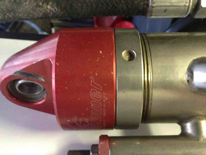

    I need to figure out how to loosen up this lock collar.
    It is on the SAW 2.5" bypass shocks. The peg hole is 5/16" and Poly says they don't make a spanner for 5/16" pegs. Any ideas?

    Soak it in machine oil and wd40. Use an allen wrench. Works well on my icons. Or maybe get one direct from swayaway.

    fit a few philips head screw drivers in there and get one that fits snug. You could even go as far as finding a round punch with that diameter and measuring it. just some ideas off the top of my head.
    Do any other shocks use the same spanner wrench or size?

    I'll try those. The peg holes are very shallow. The Allen keys I used just slipped out under pressure. Would a strap wrench work?

    prob not, def use some WD-40 like stated above as well will help whatever grip you get move it alittle easier.

    If the shock mount moves along those same threads try putting a big ass screwdriver in the center of the joint to break torque

    Just use a punch and a hammer, give it a couple taps

    go to mcmasterr carr .com and type in part number 5475A19 . should be what you need . you can will call in santa fe springs if you need it same day

    Boom! problem solved +1
