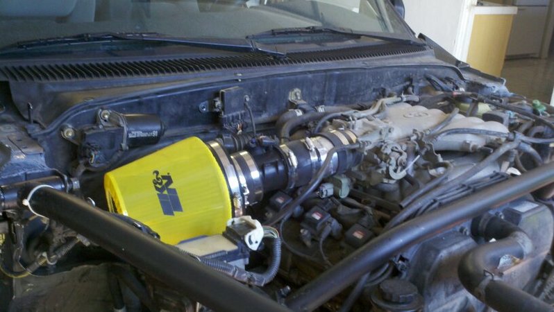

    Get a AEM dryflow cone one, you can get a universal one on ebay for like $40-50
    Those autozone ones will let in ALOT of dust out in the desert

    Anyone add a stocking over the air filter cone? I notice fine dust on my maf sensor....

    I have a prefilter on mine
    What brand filter do you have?

    K&N has them in many sizes

    i have a pre-filter over mine too

    How much do these pre-filters help in the dez? are they worth it when it comes to dust and what not

    Word. Has anyone been able to tell a difference? I'm about to drop some monies on a new filter and was thinking about buying a sock for it at the same time.

    keeps sand out, larger debris from clogging the filter W pleats, and you can clean it or change it prior to doing the main filter. mud clumps break off, fine dust is still caught at the main filter.

    It works better for micro particles and are often made of a water repellent material to disperus water from slight splashes etc. for the $10-30 that they are, they're definitely worth it if your running no fender wells in the desert :cool:
