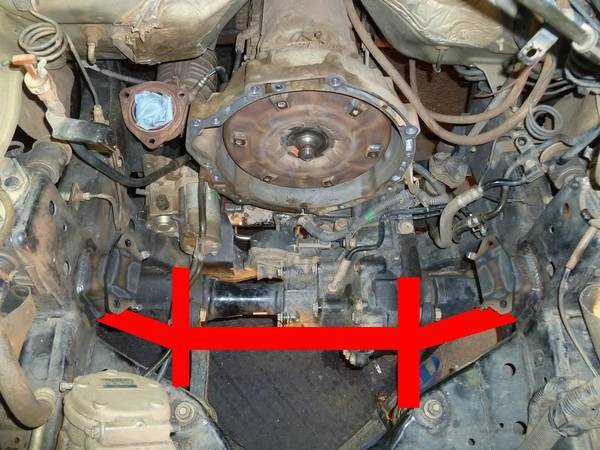

    What if I plate my stock lowers on the bottom and sides then do something like this since I am 2wd and do not have a front diff. It would be pretty simple and seems like this would be pretty rock solid. Remember this is not my truck so I have the stock mounts (still uncracked or warped) and the ones pictured are probably beefy enough not to need bracing like that. I want to try to build something solid without having to pull the motor. Obviously I would try to get them a little more straight and even, just a quick sketch
    Thanks to Viter for the perfect photo to use for illustration

    Did you see my earlier posts? The trail gear mounts now fit 96-04 v6's and Im thinking added to the sketch I have above would be pretty solid. I also dont really mind the bad with the amount of good Ill get from it

    i'm diggin your idea from the sketch. seems like it could be pretty solid, if done right
