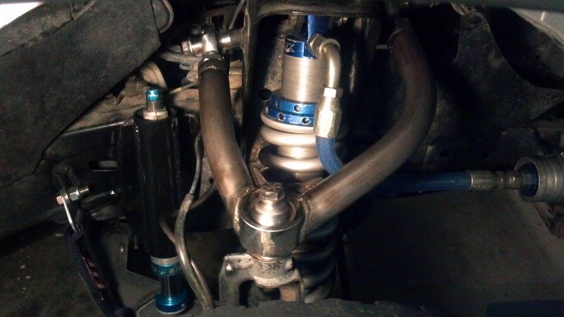

    Got LSK to mount my bumpstops and I just painted them. Its crazy to be there to see what it takes just to mount the bumps. Its never as easy at it seems on the computer. lol

    Sexy Hiatt.

    Bumps are one of the hardest things to get right. Looks great

    Thanks guys. Ya it took a while but I'm glad we took the time to get it right the first time. We took the coils off the foxes and then jacked up each side to full bump. Then we took the arms down a hair so the bumps would bottom out before the suspension ends its travel cycle. Then we got some cardboard and made some bracket templates and Van jumped on the computer, measured all of the brackets dimensions and laser jetted out some brackets out of 1/8" steel and welded the bumps on. Super happy with them. Its weird to get used to because you think the suspension will cycle when driving and it will eventually hit bump but with these it just comes to a nice gradual stop. :)
